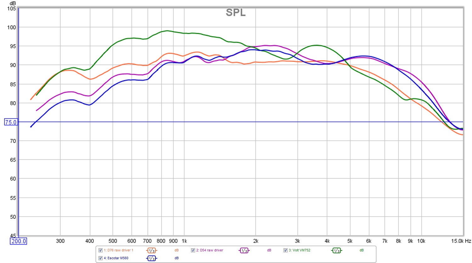

comparing VM752 with other domes
I always wonder how the VM752 compare to other mid range dome. I measured 3 other Dynaudio domes I have got - D76, D54, M560.
I config the input level to about 2.8v on all four drivers and then do a sweep on them. These measurement are done in a living room so they are smooth to 1/3 octive.
Please see the attached overlay. The VM752 is most of the time more sensitive than all 3 dynaudio mid up to around 5KHz. As it is a 3 inch dome, it is expected to roll off much faster after 5K anyway compare to the 2 inch Dynaudio.
To my surprise, the Escotar mid is not as sensitive as the VM752 given it has a more rug magnet compare to other dynas. In fact the D54 seems slightly more sensitve than the Escotar. This is not what I expect either.
The D76 is more or less flat from 500-5000 Hz. In fact, I find D76 very musical and easy to work with.
After these measurements, I really have to try out the D76 again to see how it performs in my 3 way electronic crossover system.
The extra sensitivity comes from VM's mass of 9 kg vs. Esotar's 2,4 kg.
