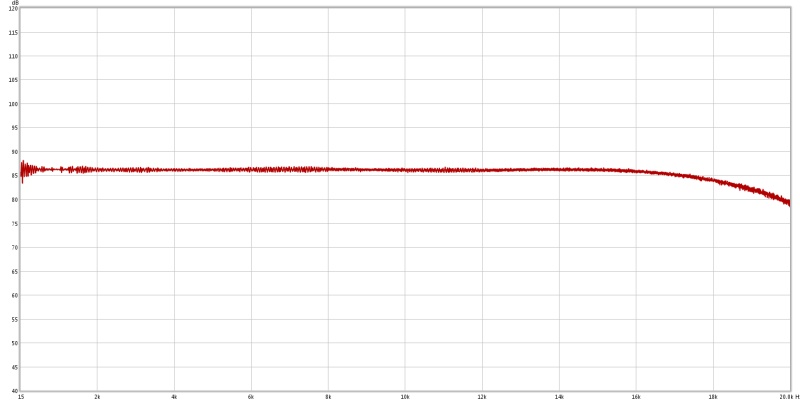

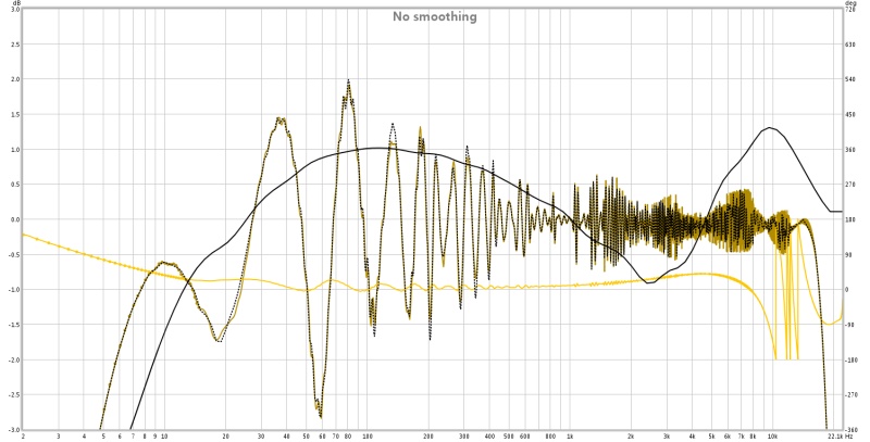

Does this look right
Please be gentle with me as I'm new to this software.
The cal data looks very "spikey" to me.
The SPL frequency response of the soundcard looks OK.
That yellow trace that breaks up above 10kHz is the phase trace. This is the soundcard self calibration, no speakers, no microphone, just wires.
In REW you can label the title of each data set on the left in the white bar. That label will show up as the legend below the graph. Select show legends when producing the plot. That way we will know which curve is which.
Is the solid black line the mic cal curve? If so that is ok as if is of order 1.5dB on the mid and HF and is smooth. If the dashed black and yellow line is the mic cal then that is not right. What is that spikey hash curve anyway?
If you have a bare driver or one mounted in a simple cardboard open baffle try measuring that first to make sure you get a response that makes sense.
