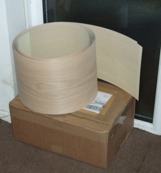

So, I've just spent £200 on some iron on veneer and I'm going to stain that Ebony and wax it. That doesn't require a dust free and dog free environment and you can just keep on waxing until they shine like a new penny.

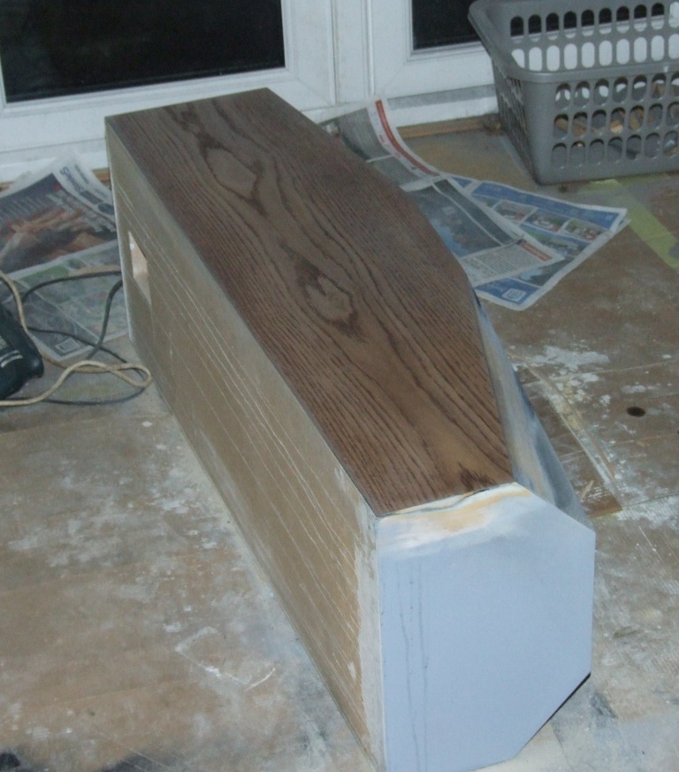

Iron on Veneer
This stuff really is quite good and fairly easy to use.
It covers up a multitude of sins if your cabinets are not too clever, mine are OK by the way.
I'm not too sure how you are supposed to cut the edges. You have to iron on bits that are too big as it shrinks quite a lot. I've been bending the joins at the edges and sanding the veneer to the point where it breaks without tearing. That's OK for all the straight edges but how am I going to cut the veneer around the driver holes ?
A scalpel comes to mind - but is there a better way ?

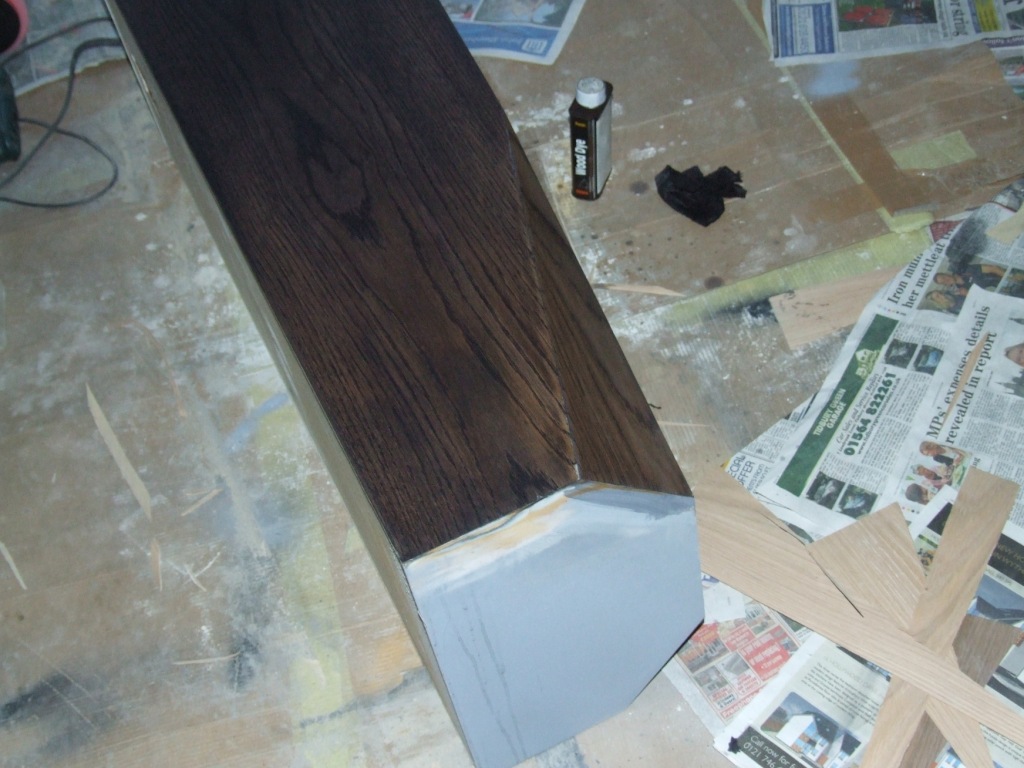

I appreciate that the staining isn't quite uniform, that will be corrected as more staining is applied, they will be BLACK before I wax them.

A veneer saw is what you need, especially for oak veneer which is quite 'splitty'.
VENEER SAW | eBay
I've used oak a couple of times, both glue and iron-on. Glue is easier in that it doesn't shrink but the fumes aren't nice. I have used a very sharp Stanley knife for the edges (scalpels flex too much) and then fine sanded it down. I've read of others using routers. The veneer saw seems the way to go as it is designed for the job.
I had a pair of black Ash speakers which I waxed. I didn't find it easy to get the wax even and there would be odd patches which felt tacky. The oak bookcases I built recently were treated with Danish oil. It gives a soft sheen rather than a gloss but it is straightforward to apply.

Thanks for that I'll have a look into Danish Oil.
Please make sure you read the instructions, it gives off nasty fumes.....but it does a good job.

I've found the easiest way to form the veneer is to bend the edges very slightly and then wear away the veneer at the edge with a sanding block. After very little effort the veneer is so thin that you can slice through it with no danger of it splitting with a craft knife.
The edges may not be razor sharp but they are still well defined and the finished product looks lovely.

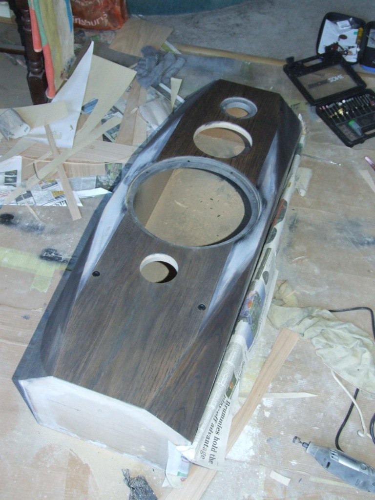

I'm almost there, just the two flanges either side of the front and the top to go.
I'm still waiting for a suggestion as to what I can use to fill the slight gaps with that won't repeal or act against the Danish Oil.
The fun bit has been cutting around the carefully rebated holes in the front baffle. The trick here has been a worn Dremel sanding barrel.
