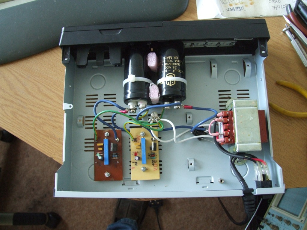

I've just finished the PSU for the active crossover.
Looking good. What value caps are they?

10 000uF x 2.
I've opted for the older EI transformer for mains borne noise rejection.
15-0-15 (AC) into a pair of LM317/337 regs - should suffice I think.
Obviously the 15-0-15 is rectified, you can see the bridge next to the transformer.
There is additional filtering on the active crossover boards

Wow, that seems a lot. I have a power amp that only has 4700 x 2 per channel! You can't have too much I suppose.
It's just what I had in my spares box at the time.
