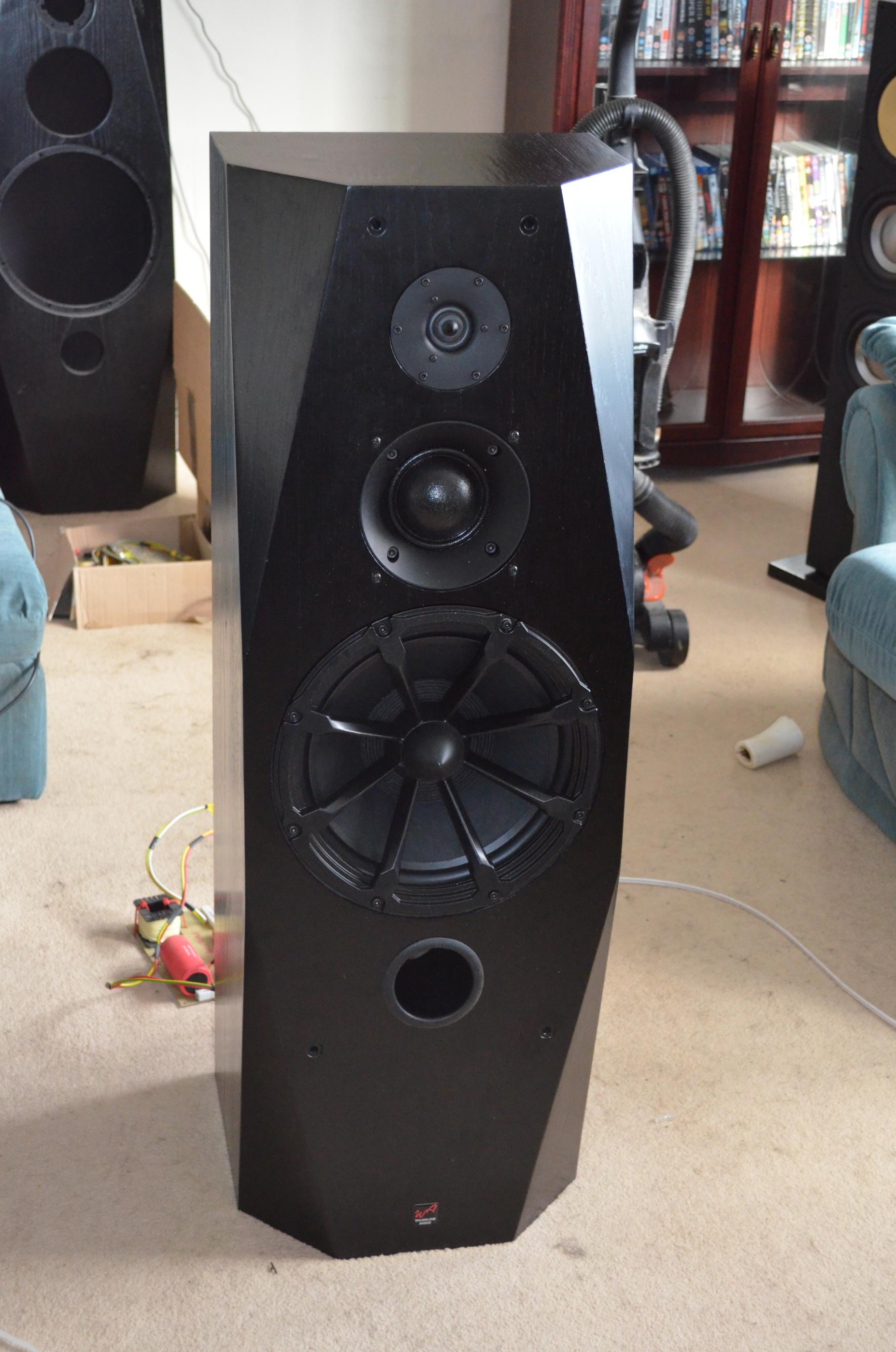

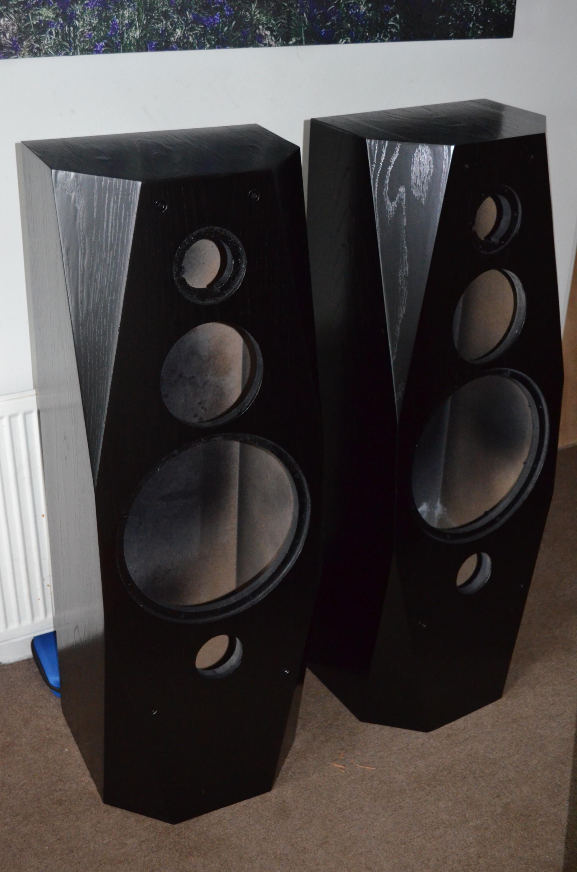

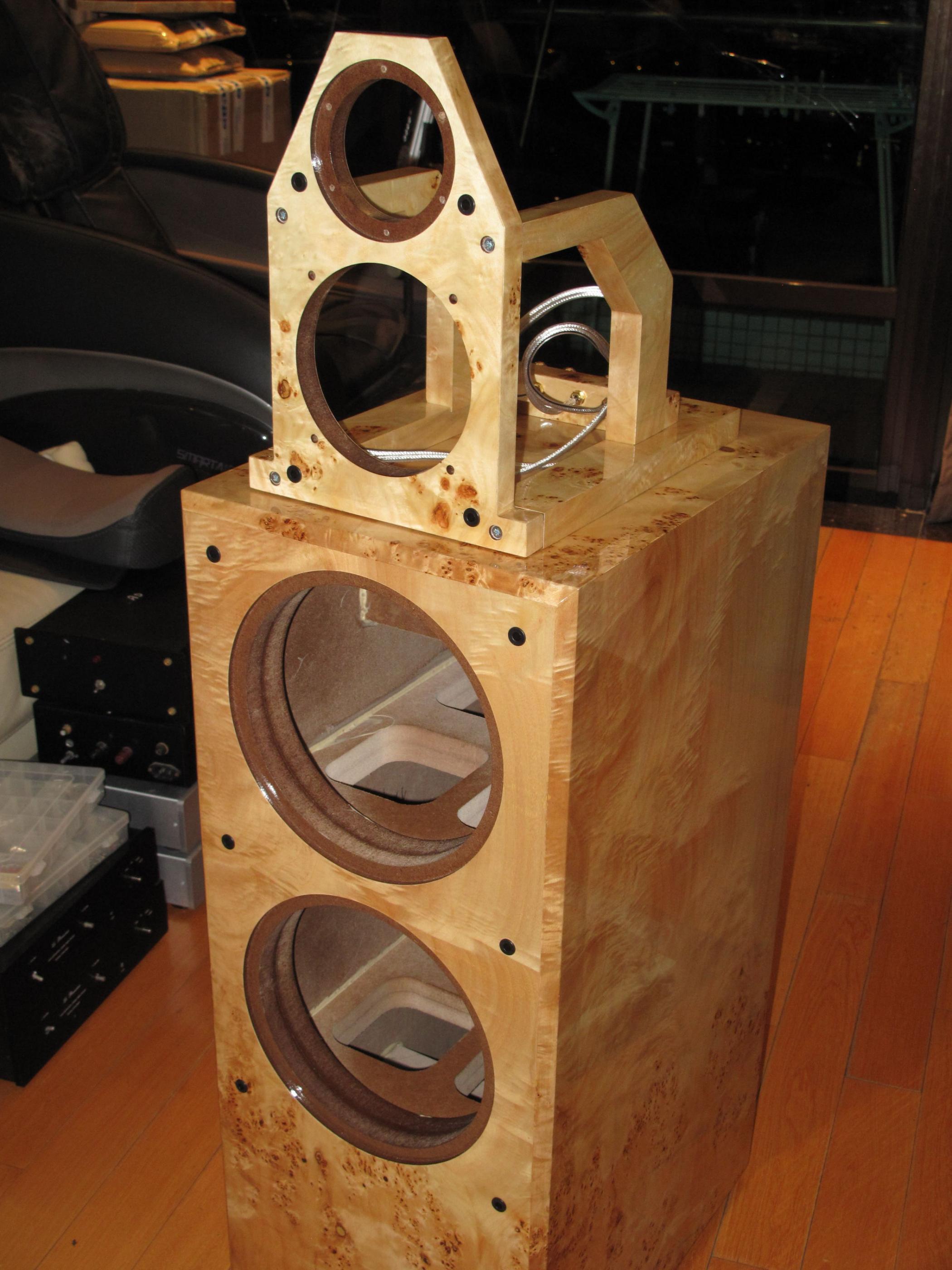

At long last the cabs are back from the finishers and looking great.
Anyone embarking on this sort of project, the finish is all important as these will be a major piece of furniture. With retrospect I would have bought pre-finished cabs. But hey, DIY is a learning curve.
Next job is to populate them.

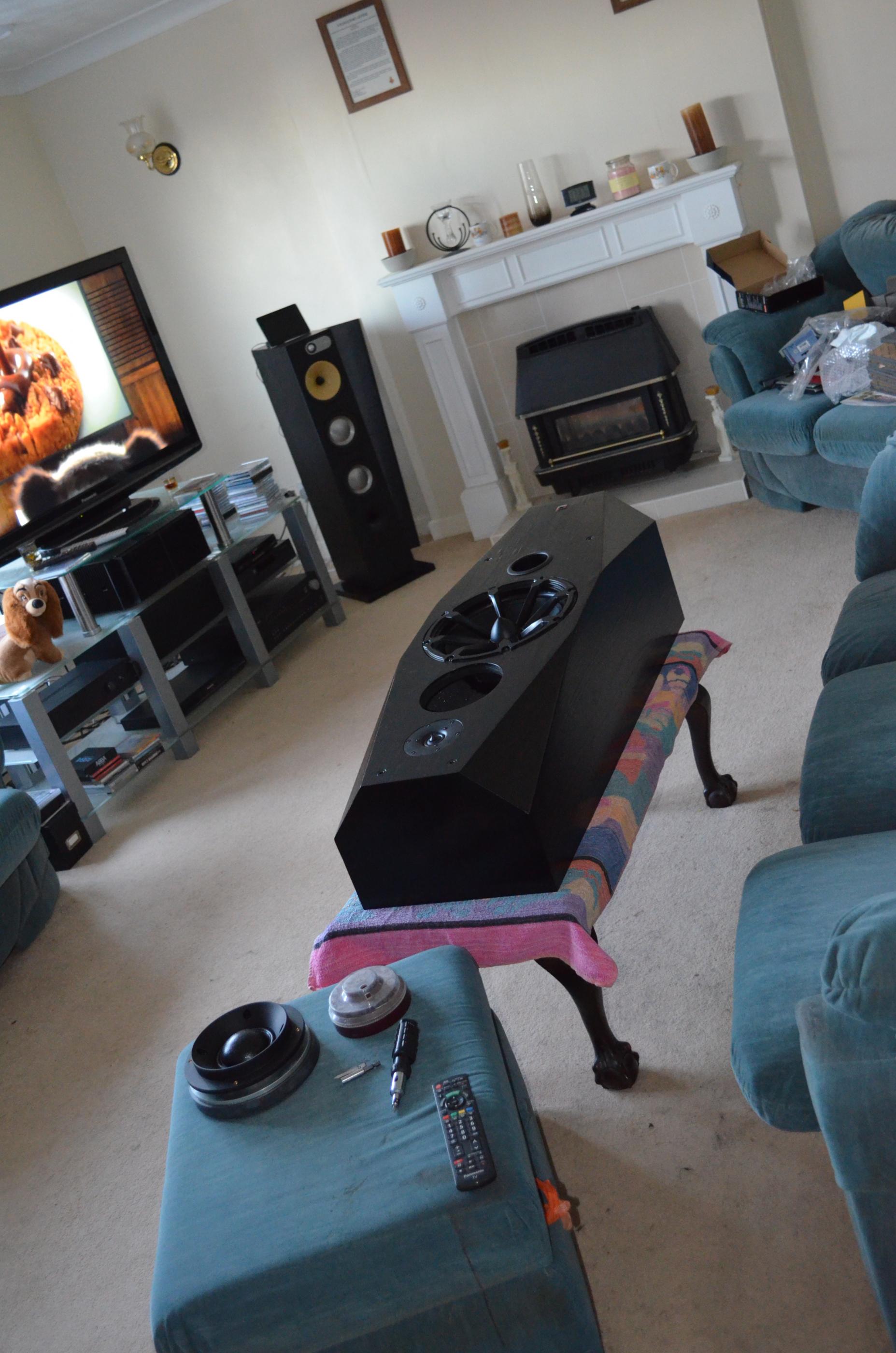

Installing the Volt mid
I assume that you can reach the back of the Front baffle as they can only be installed from the back of the front baffle.
Are you going to add bracing to the internal of the cabinet. I guess that will make the cabinet stronger and hopefully tighter bass.

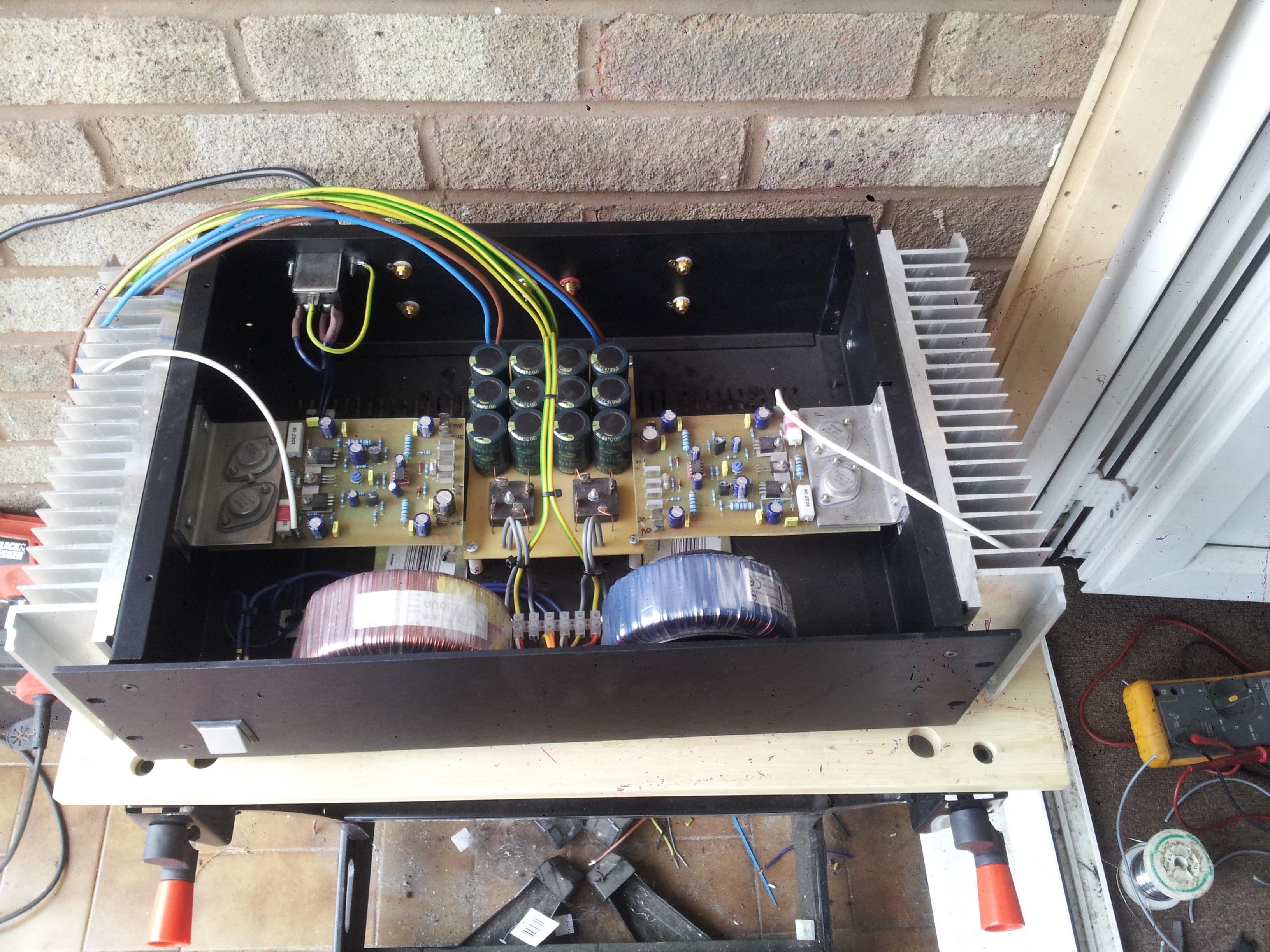

Well the 2 x 150W doesn't work on one channel.
Next dilemma is whether to fault find on it or just use the salvage to build an F5 turbo.
The Platinums are back on the drawing board. I'm wiring the cabs passively but using the crossovers externally for the time being.
The 2 x 150W was replaced with a Quad 909 clone. Again I've got problems, one channel works but the other one oscillates.
After a move of home - they're back
After a little sebatical the Platinums are finally being finished.
In order to remain flexible I'm just making the cabs entirely passive. I do have the bonafide crossovers which I'm going to mount in external boxes behind each speaker, that way I can play.
Gor blimey, it's heavy, and that is with the mid range still not fitted. The mid on its own is a two arm lift. That's the first time I've moved the cab with any drivers fitted.

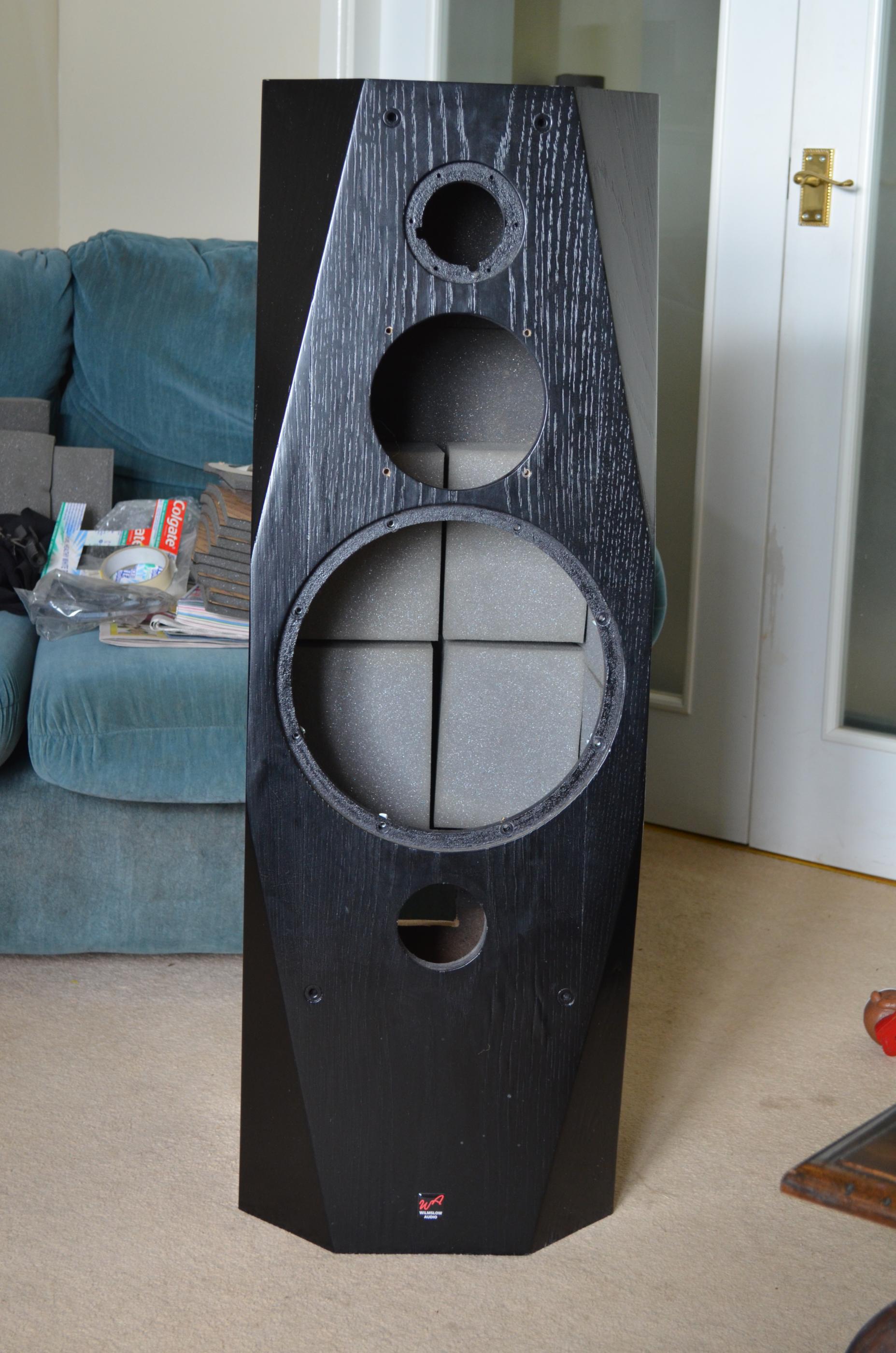

The existence of cavity standing waves can be seen in impedance
and FR plots. Once you have enough of stuffing or lining, those
signs of resonances would dissapear. I don't put any foam in boxes,
only polyester wadding from upholstery supplies because it's cheap
and working ok. This usually means making a role just enough in width
and height for proper dampening and checking with measurements when
it's enough. Space around port is free.
As speaker dave mensioned on more than one occasion, a very good quality
and efficient material for dampening standing waves would be mineral and
glass fibre wool. You can work with foam too, of course.

Well the first of the pair is finished. The external crossovers still need to be boxed.
First impression is that the mid range is not as bright as the DM683's.
I'll wait until both are finished and they're run in before I evaluate them.
Second impression is that are slightly less sensitive than the B&Ws which is a concern with a Class A amplifier.

I did build a Quad 909 clone for the Bass but only one channel is working.

Volt dome is potentially a very low Qts driver and it may have something
to do with your first impression. Other than a few technical data about power,
sensitivity, frequency range, a weight of 9 kg ..., and a FR plot looking like
not being measured, I have no other objective data to use for making a sensible
suggestion.Without measuring we are in dark.
I bought this as a kit as I have no means of measuring. I'm disappointed my B&Ws sound much better.
