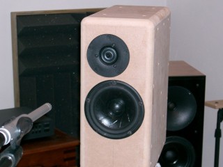

Will you help a newcomer with his first multi-way project?

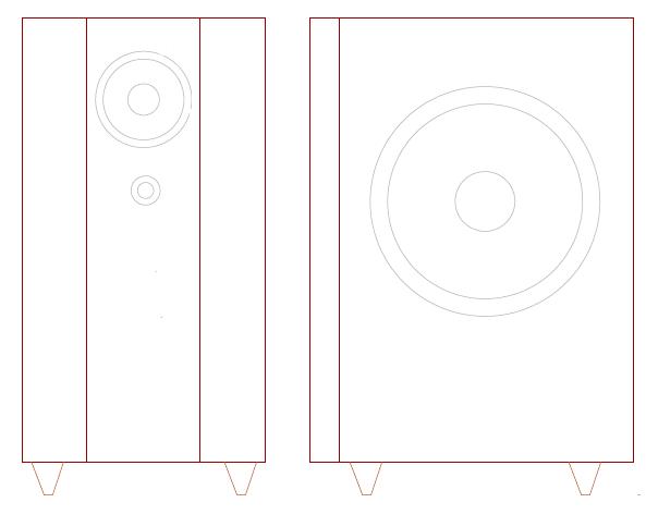

I have attached a design idea to place the 12"at the side of the enclosure.

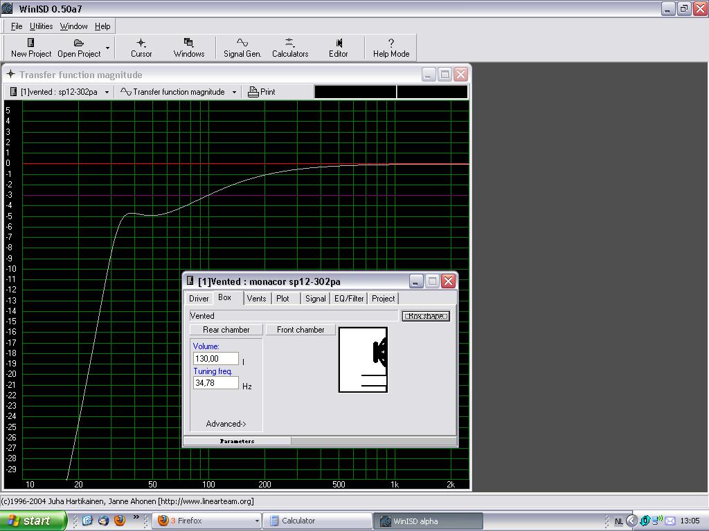

simulation in winisdpro.

Check, also, for a (dB's) difference of ~10dB@30Hz more for Monacor Menhir vs. the Visaton (75dB@30Hz). The bigger difference between the level for Monacor Menhir (85dB@30Hz) and the main level (100dB@frequency range), of ~15dB (~10dB for the Visaton), can be balanced with the filters (bass/loudness/treble) on the amp, I expect. Any ideas?
Check a (dB's) difference of ~10dB@30Hz more for Monacor Menhir vs. the Visaton (75dB@30Hz). The bigger difference between the level for Monacor Menhir (85dB@30Hz) and the main level (100dB@frequency range), of ~15dB (~10dB for the Visaton), can be balanced with the bass/loudness/treble output of the amp, I expect. Any ideas?
Your conclusion isn't right inductor. the evarage soundpresure of the monacor woofer is reduce to 93dB/1wmtr with the filter. So the speaker is on level down to 40Hz. And not producing 99dB as you stated.
With placement of the basreflex tube on the back of the box you can raise the output level at 30Hz-40Hz with the room gain of the back wall.
The bas-reflex tuning stretches the low end in this design like I did simulate in winisd. The raise of the sound presure at higher frequencies is suppressed with the filter lay out in the Menhir design to 93dB average. See L4, C7,R5-8. That is what many beginners do not see what can be done with a smart filter lay out.
@ PIPSK to reduce costs you can make a bassreflex channel from wood only thing you have to do is to make it the same length en it must have the same crosssection area like the 99mm round tube=77cm^2
