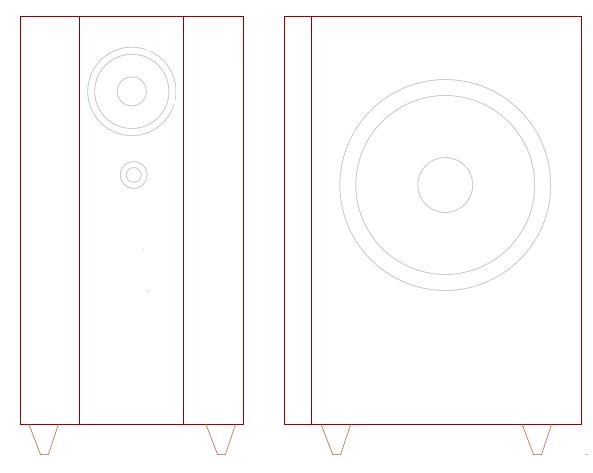

Hi pipsk,
When I read your reactions about what systems you like and cost effective. I have a idea.
I can buy expensive stuff but I personally like to build a design with normal driver and combine them the right way.

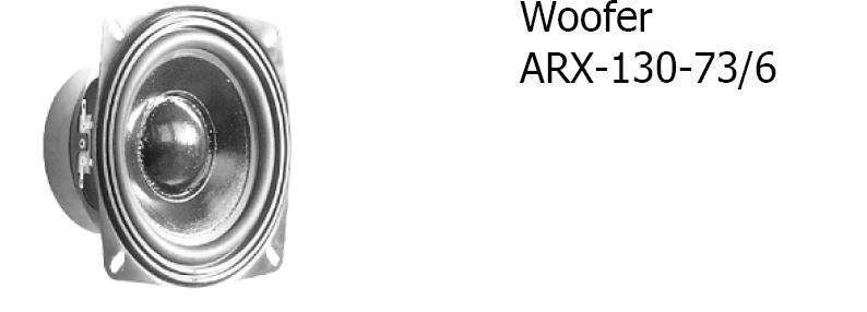

What would you think of a closed loudspeaker With a TVM acoutics 12". A really cool aluminium frame coated paper cone woofer.
50Liter box closed with arn312. I attached a simulation. That shout give a clean punchy bass.

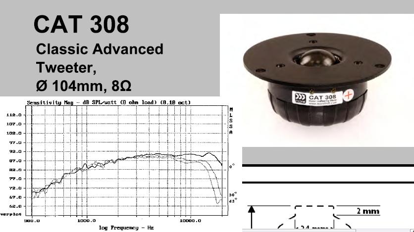

Mid speaker a arx130-63-6 also nice as mid woofer in a two way design. If this isnt good enough peerless has nice price 4" middrivers. Or tanband.
And a quality tweeter like a budget morel cat308 they are sold as matched pair to prevent difference in left and right channel. And these morel tweeters have good off axes up to 15kHz important for a bright sound.
Personally I have good experience with monacor dt300 very nice and cheep. Used in this project of mine.http://www.diyaudio.com/forums/multi-way/137036-big-bandpass-fatboy-8.html

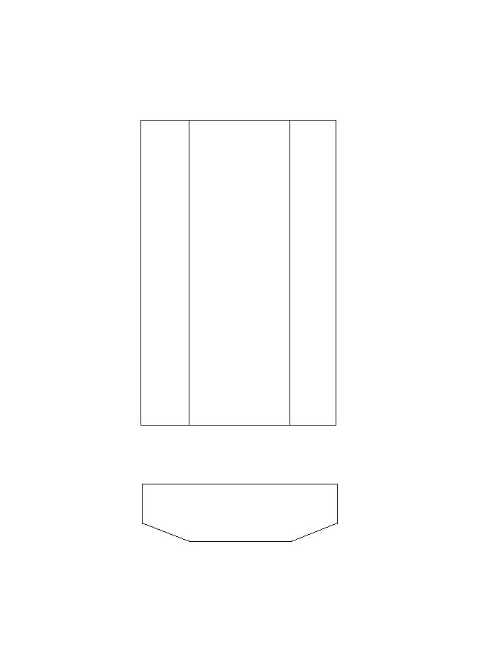

I have attached a design idea to place the 12"at the side of the enclosure.
To build the prefessional you shout have to use freeware as arta or holmresponse and your pc soundcard to measure the loudspeaker. And then improve the crossover.
If this is to complicated you will end up copying a design.
