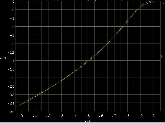

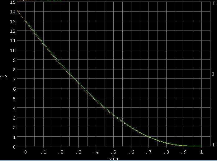

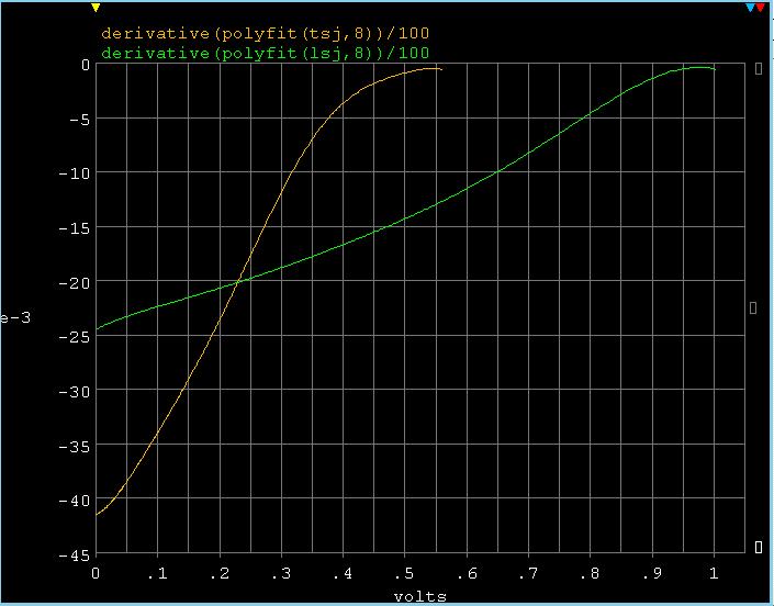

More grist for the mill. This is a comparison of the LSJ74 and 2SJ74 for conformance to ideal square law behavior (the derivative of Id vs Vgs should be a straight line, gm).
This is a sample of LSJ74C date code 8/27 (upper curve). The lower is a 2SJ74 BL both ploted as Id vs Vgs, Idss at the crossing of the left axis. The straight derivative of this raw data is very noisy so I did an 8th order polynomial fit and ploted that in the second figure (gm vs Vgs). Near pinch-off there are sub-threshold effects just like in MOSFETS that do not conform the the standard model. Otherwise give or take a little the lines are reasonably straight. The LSK part mainly comes up short on transconductance, but there is some deviation at moderately low current above the sub-threshold behavior.
To get a good estimate on the beta parameter and Vp. I would toss the data near pinch off and fit the equations.
EDIT - the 1/100 is from my 100 Ohm current sense resistor.
EDIT2 - In looking more closely there are some real issues, the gm at 1mA on both devices is comparable but at higher currents it is not almost as if there is excessive internal parasitic resistance in the LSK part.

Yes in general you can substitute the polynomial expansion into your circuit equations and use the trig identities to extract the harmonics, if you want to do it by hand.
I'm working on a model fit using my parasitic resistance assumption. One problem with just normalizing is that it is not a multidimentional approach and the underlying process differences usually have a complex interaction.
I'm sure I have enough parts to find one of eash within a few percent of Idss to confirm any assumptions. If there are significant extrinsic resistances it opens up the possibility that the FET is not exactly reversible, an experiment I can do today.

Ah, I thought your purpose in using the fitted equation was to smooth out the measured data so the numerical derivative (gm) would also be smooth
If you post or PM me the noisy (Vgs, Ids) dataset, I'd be happy to fit a few different functions to it, including the two in post #177, and take numerical derivatives of each. It might also be fun to horse around with Savitzky-Golay FIR filters too, since SG's original (1964) design goal was extraction of numerical derivatives from noisy data.
As you allude in post #176, extracting the harmonics "by hand" is one way to skin the cat, but not the only one.

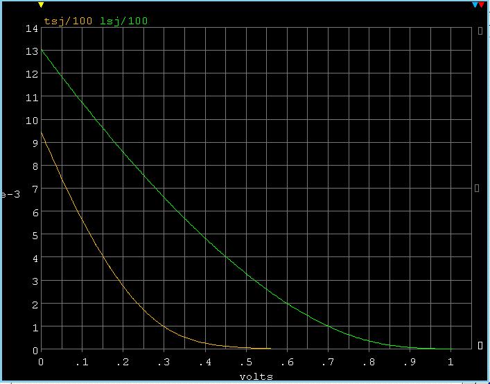

Well actually the little Analog Discovery box has no averaging feature that I can find so that was a quick fix. A running average smoothing would probably be enough since there are way more datapoints than needed. The data file is only 13k so I will attach it (Vgs,Id comma delimited with lots of pointless resolution).
Here's a quick fit using an extrinsic Rsource of 11.2 Ohms, Idss = 16.5mA, Vt =.92V. Starts looking pretty good most of the higher order fitting tries to make the subthreshold region fit. I mis-spoke there is provision for subthreshold in the level 1 model just almost no one uses anymore than the default values.
I think the main point here is that by just measuring Idss you grossly under estimate the actual model parameter. The Toshiba 2SJ74 fits with a much smaller Rsource.
EDIT Don't forget Id = V/100
