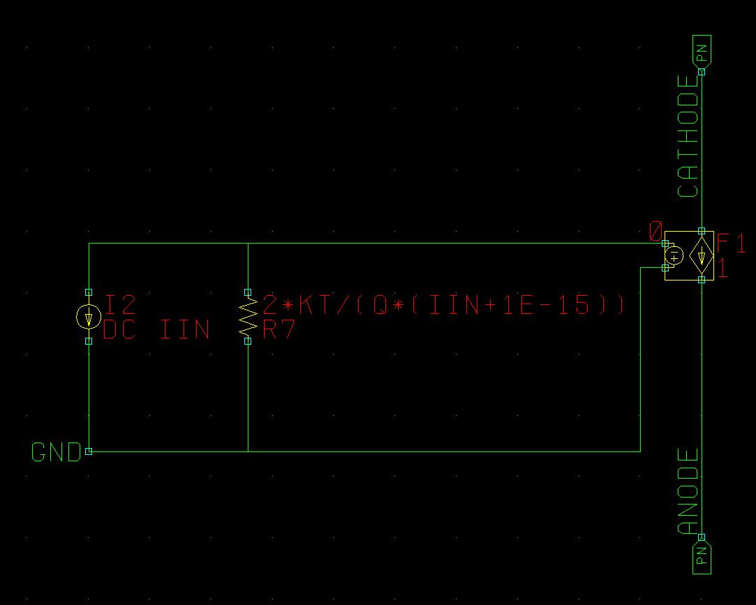

Mike Engelhardt, author of LTSPICE, seems to say that behavioral sources have an exploitable bug: they simulate noiselessly. See msg # 11349, 02 Aug 2006: Yahoo! Groups
That's not a bug, it would be rather non-physical. Behavioral sources can be used to model any number of processes, the underlying noise sources need to be inserted separately.
For instance and ideal current source does not have any noise so if you model a photodiode output you need to insert full shot noise. If you are substituting an ISRC for say a bipolar current source to simplify a circuit you would need to insert an appropriate noise current. I use an "F" source CCCS with appropriate resistor to make the noise current. Barrie Gilbert pointed me to some of these tricks 20yr. ago.

A quick picture to clarify my point on modeling with ideal sources. The process of photons to carriers in a photodiode is random and has full shot noise. Most "photodiode equivalent circuits" are wrong because they simply have an ideal current source to represent the photo current. The model below fixes that, the tiny added current fixes the singularity at 0 and represents the true dark current which is only due to ionizing radiation and can typically be ignored.
