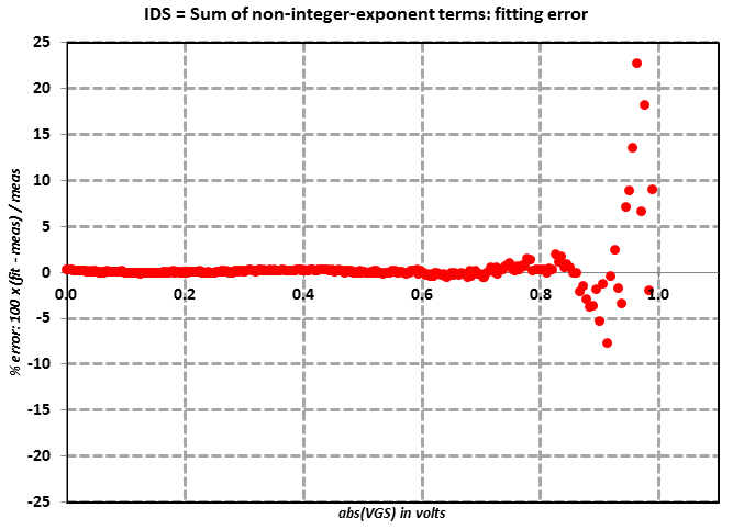

Iv'e attached CSV files that contain 345 rows; a header row and then 344 JFET datapoints. Each datapoint contains VGS, IDSmeasured, IDSfitted, %error, and dIds/dVgs at that VGS.
%error = 100 * (fittedIDS - measuredIDS) / measuredIDS
Since they're CSV format, you can open them with Excel and plot the data just by clicking on the columns.
Fitted coefficients for the 8th order polynomial (with integer exponents) were
Fitted coefficients for the sum of non-integer-exponent terms (see post # 177) were
i.e. the exponents were 0.974, 2.111, 5.840, and 8.159.
$coeff[0] = 1.3088344e-002 ;
$coeff[1] = -2.2937478e-002 ;
$coeff[2] = 9.7438075e-001 ;
$coeff[3] = 7.6904537e-003 ;
$coeff[4] = 2.1116741e+000 ;
$coeff[5] = 5.1756029e-003 ;
$coeff[6] = 5.8400235e+000 ;
$coeff[7] = -3.0127659e-003 ;
$coeff[8] = 8.1590383e+000 ;

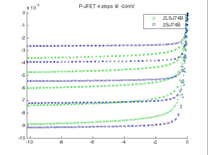

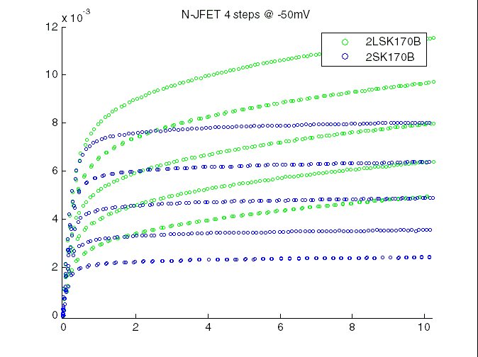

I/V Curve trace results of my Linear Systems LSK170B / LSJ74B (Thanks Jan Didden!) vs. Toshiba 2SK170 and 2SJ74:
-- xLoff
Wow is the lambda (output impedance) of the LSK parts that bad? Transistormarkj, what values for the model parameters does this give?
If those curve tracer plots are real the lambda parameter becomes very important and must be extracted before any other curve fitting. Also there's not much hope of getting a sim to match real distortion performance, just the basics.
More or less 5k?
Right, Early voltage looks to be only 50V or so. Without cascodes these would behave very differently from the Toshibas. OTOH they are more triode like. 😀

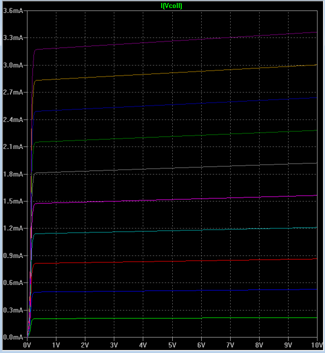

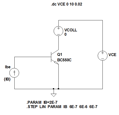

Oh, I don't know, folks seem perfectly happy to simulate distortion using LTSPICE BJT models, whose output conductance is similarly limited to a perfectly straight line with no curvature (d2Ice/d2Vce = 0).Also there's not much hope of getting a sim to match real distortion performance, just the basics.
Here's the BC550C BJT model from the Cordell website
That's the spirit!! Although most of this is way over my head, my intuition tells me that people are concentrating too much on whether they are identical to the toshiba's and less on what the implications for real world applications will be 🙂 Sure it might be a bit different, but can those differences be used to advantage, rather than be a hindrance?
Tony.
In modified designs yes, as straight replacement rather no. The nVrtHz performance is an important question also.
It follows a real Philips BC550C nicely (marked PH7 3 with HFE 535).
The Level 1 JFET model deviates grossly from reality for these short channel FET's, which folks like to use in simple open-loop or minimum feedback circuits. Over much of their range bipolars are far closer to a straight line. BTW I couldn't get that extra JFET parameter in LTSPICE to do anything useful. The level 3 model uses the tanh fitting parameter (pic).
Yep, a standard kludge people use to make long channel models, kinda sorta fit the behavior of short channel transistors, is to insert a source resistance. This causes the saturation knee voltage "VDSsat" to grow more slowly, and kinda sorta emulates carrier velocity saturation. When you go past the knee and get into the saturation region proper, the model will give a straight line with no curvature.
