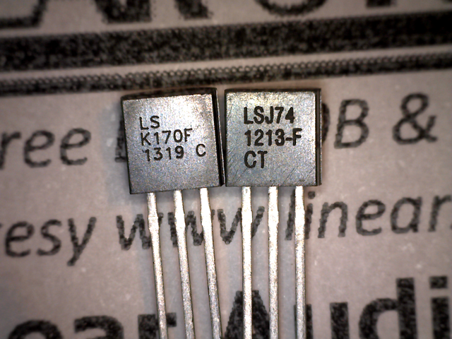

NicMac must have connections to get LS parts that are not even listed on the mfg web site?
I do not think that Jan would be the one to teach SMT, since he has just learnt it himself. More to it than meets the eye. ha ha
It starts with tools, then goes on to technique. It can be done without a stereo microscope, but it is a very time consuming task, well that depends on what/how many you are doing & what type of parts.
Just buy the latest issue of Linear Audio and you get one set for free😉NicMac must have connections to get LS parts that are not even listed on the mfg web site?
