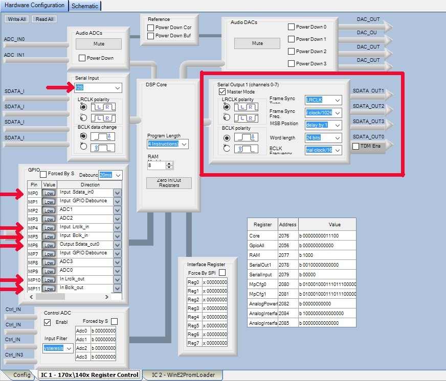

Dear DIYers,
My post is about outputting an I2S signal from up2stream Mini/Pro v3 board to the Wondom adau1701 dsp module.
It is clear that the Mini/Pro boards work as MASTER, then the adau1701 should be set to slave, oscillator desoldered and so on...
I found a topic on the Arylic forum and the autor claims that it is possible to do it in the following configuration. I will quote part of the topic (The images are from his original post as well).

This setup should not work, since the adau1701 is set to MASTER as well, and the MCLK is connected to the MCLK of the up2stream board. But the author assured me that it is working fine. Can you give your opinion on how is it possible?

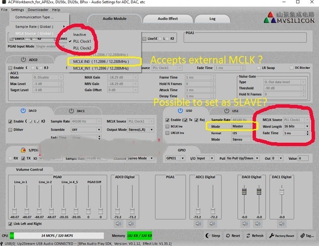

Another image from the same post got me puzzled. It is from the ACPworkbench sofwtware (sold separately by Arylic for approx 20euro)
There is a dropdown menu called "MODE" where Master is selected. Is it possible to set it as a slave? And then from the Settings -> MCLK source (Global) menu to select MCLK IN0 (11.2896/12.288MHz).
If this is possible, in theory the Mini/Pro v3 will accept the external MCLK from the ADAU1701 (set as master) making the desoldering/replacing the oscillator not necessary.
I would be happy to hear your opinion!

When you say "the adau1701 is set to MASTER", it looks like you are only referring to the Serial Output. That means the DAC on the output will get its clocks from the ADAU1701. However, the ADAU1701 is a slave on the Serial Input, as the clocks are generated by the Linkplay module on the Mini/Pro v3 board. The master clock for the ADAU1701 is also generated by the Linkplay module, so you will need to disable/desolder/cut the trace from the oscillator on the ADAU1701 board. The ADAU1701 will be sampling at 44.1KHz, so you will need to set up SigmaStudio to use that frequency vs the default 48KHz (that will affect your filter coefficients).
I can't answer your questions about the Arylic software, except that you would want to select 11.2896MHz as the MCLK IN0, since that is what will be coming from the Linkplay module. And you should double-check the ADAU1701 board to make sure that the original oscillator was 12.288MHz and not 24.576MHz--otherwise, you would need to change the PLL pins as well.

Okay, lets remove the PCM dac from the equation and discuss only Mini/Pro <=> Wondom ADAU1701
To be master for the Serial Input MP4 and MP10 should be paralleled as well as MP5 and MP11, thus providing the LRCLK and BCLK to itself. And the MCLK should be provided by the adau1701. Is that correct?

To be honest I did not think about it. You're right. In this example The ADAU1701 is master only to the output (to the external DAC).When you say "the adau1701 is set to MASTER", it looks like you are only referring to the Serial Output. That means the DAC on the output will get its clocks from the ADAU1701. However, the ADAU1701 is a slave on the Serial Input, as the clocks are generated by the Linkplay module on the Mini/Pro v3 board.
Indeed! But in the OP example (take a look at his topic) he connects the MCLK of the Mini/Pro 3 with the MCLK of the adau1701 module. He does not mention anything about removing the adau oscillator and claims it is working. I don't understand how is it possible.The master clock for the ADAU1701 is also generated by the Linkplay module, so you will need to disable/desolder/cut the trace from the oscillator on the ADAU1701 board.

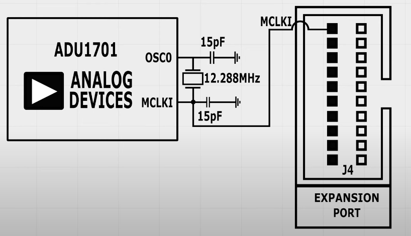

OK, the OP shared a video showing his setup working.
I'm not a guru in the field. This is how I interpret his results:
The Arylic module MCLK is 11.289MHz, 44.1kHz sampling rate (it is always master)
The Wondom board:
-The MCLK pin (pin20 on expansion port J4) is connected to MCLKI (pin 32 of the microcontroller)
-If the oscillator is not removed, the dsp sampling rate is still 48kHz (256*48kHz=12.288Mhz)
I assume there’s no effect by connecting the two MCLK pins (arylic to wondom)
I also assume that the serial communication is somehow still working, but the input (wondom) is not 100% synchronized to the output (arylic) since there’s no unified MCLK for the entire “system”. This should cause some jitter (even though it may not be audible).
To make sure the system is "politically correct" we should remove the crystal and feed the MCLKI pin with 11.289Mhz from the Arylic MCLK pin. In sigma studio we can set the system sampling rate for the dsp to 44.1kHz and redo the program so that our filter coefficients are also fine.
Do you approve the above said?
One last question. With the oscillator removed, the adau1701 board will not have its own source of MCLK, meaning to say it's not an autonomous device any more. It will not boot until it receives the external MCLK signal. What would happen if I want to make adjustments to the sigma studio program and upload it to the 1701? May I use the external MCLK to make it run while programming?

Sorry--I had forgotten the circuitry. That's a crystal, not an external oscillator, with the amplifier inside the ADAU1701. Apparently, driving the MCLKI input from an external oscillator at a lower frequency than crystal resonance will simply cause the ADAU1701 internal oscillator to not work. Somebody with a good crystal model could probably analyze this circuit to assess whether the design is "guaranteed" to work with an externally applied 11.289Mhz clock, but experimentally, it seems to work OK. There is probably some degradation of the MCLK signal with the extra capacitance in the oscillator circuit, but it looks like that is not a problem.
With the 11.289Mhz external oscillator applied to MCLKI, the ADAU1701 will run at the 44.1Khz rate. If you disconnect the external oscillator, the internal oscillator will "take over" and the DSP will run at 48KHz. Either way, the ADAU1701 will have a clock and it will work. The EEPROM programming and real time control aren't synchronized to the clock--that is all done via I2C.

By the way, I just finished my conversation with the guy on the other forum. So he finally desoldered the crystal on the ADAU board and fed the MCLK from the Mini/Pro directly to MCLK pin of the dsp. According to him there is an audible difference and the sound improved.
He also tried to change his up2stream Pro 3 to slave mode using the APCworkbench software - it is not possible.
So with all that in mind, I can say that the finest solution was already discovered long ago - removing the crystal. Thanks to all of you who shared your experience with these boards, because the information given by the manufacturers is not really detailed.
