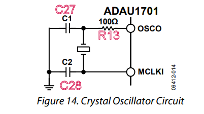

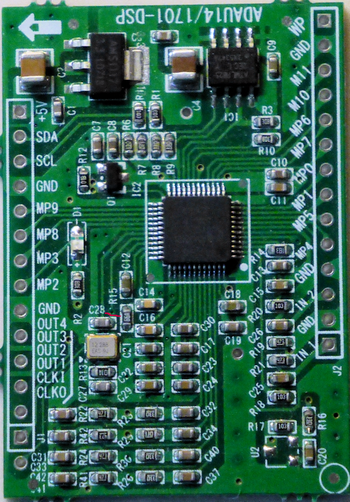

It's labeled on the silkscreen: CLKI and CLKO. CLKI used to be a ground and the new "pin" is CLKO. That will make connecting synchronous I2S devices easier. I haven't buzzed out the connections yet to determined whether they switched from a crystal to an oscillator or what it takes to use these pins.. But I'm assuming the mod to 44.1KHz sampling will be easier with these pins.
I traced the two new connections, and yes, they do go directly to the ADAU1701 MCLKI and OSCO pins. Unfortunately, the new version of the module won't work in the board I made, because that CLKI pin used to be a ground, and that is what my board provides. So I have to cut that ground connection. That's one of the risks of using these low-cost modules: the design can change without notice.
The board can be made to use 44.1KHz sampling by connecting a 11,289.6MHz oscillator to CLKI. Most of those small oscillators specify a maximum of 15pf loading, so you should remove C28 and probably R13. That's not too hard to do--removing SMD components is much easier than soldering them to the board. Just add enough solder to the device to cover it and then flick it away with the iron or use tweezers to lift it off the board.
For those who prefer cutting traces to removing components, you can make a small cut between the via and pad near C28 (see the tiny red line in the picture). The via goes out to the CLKI pin, so this cut has the same effect as removing C28, the crystal, C27 and R13.

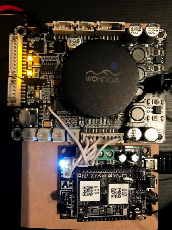

Hi everyone,
It's been a little while. I figured some more stuff out. It is possible to hook up a Jab 3 DSP amplifier to an Up2Stream module directly (V2 & V3). However, this again requires some modifications to be done. Both the crystal and 3V3 LDO have to be desoldered from the sure amplifier board. Even though these are SMD components they can easily be removed with a genereric soldering iron and a generous amount of solder after which the pads can be cleaned up.
The master clock signal will have to be connected to one of the pads on the footprint of the crystal, it's marked by a small arrow. GND, 3V3, LRCLK, BCLK and data can simply be connected between the two boards. In this configuration the supply voltage for the DSP will be provided by the Up2Stream module. Normally the DSP is powered by a power supply on the amplifier board but this can cause audible distortion due to interference.
Cheers
Cheers
