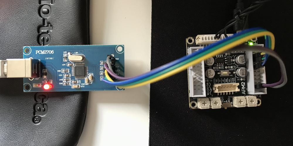

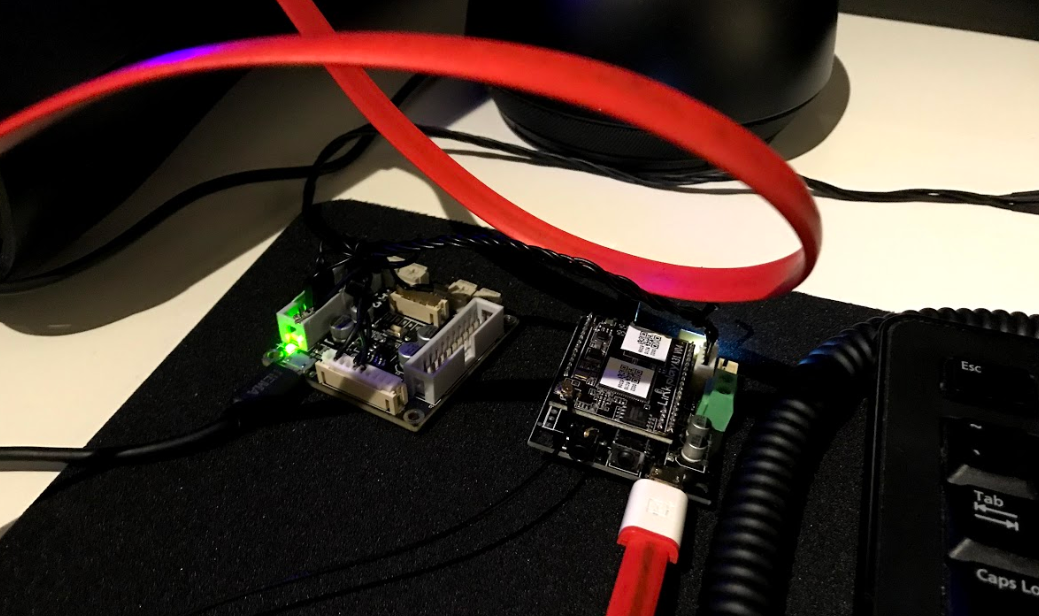

For anyone who's interested in connecting an ADAU1701 DSP to a desktop computer or laptop, I have been able to get the DSP working with a cheap PCM2706 USB to I2S board. The connection is essentially the same as with an Arylic Up2Stream module. I desoldered the crystal on the bottom of a sure dsp module, see attached picture, after which I simly connected the clock and data signals between the two boards. In this case the setup is limited to 16bit 48kHz which is not quite high-res but it sounds fine. In Windows 10 the volume slider does not function though, only software volume control works for instance in Spotify.
Yeah, those are the same connections I used to connect the Arylic I2S to my Sure board. The Sure DSP isn't my preferred 1701 board, but it does have the advantage that MCLKI is brought out to a connector. It looks like you surgically removed the crystal! Did you use hot air? I used a soldering iron which worked, but with less clean results.

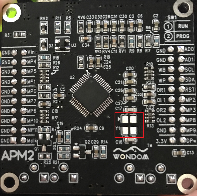

I just used a soldering iron but I cleaned up the pads afterwards with some soldering wick.

And it would be an even better solution if it was easier to replace the crystal on that cheap ADAU1701 board...
Which brings up a question I have. I modified my 3e Audio 1701 DSP to use the MCLK from the Arylic motherboard. It works great, but it would have been easier just to replace the 3e DSP crystal with a 11.2896MHz with the same format.
