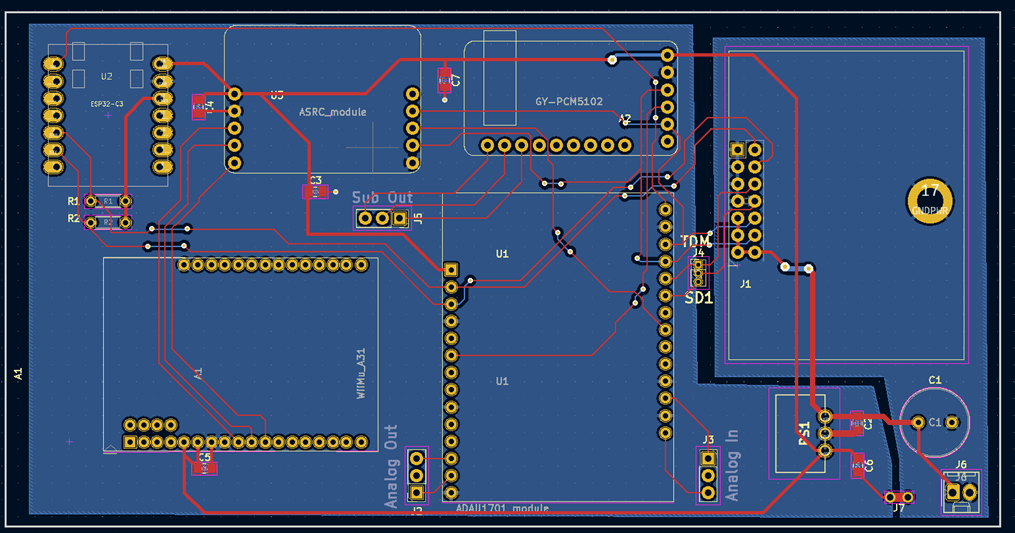

Hi Neil,There is a page describing the several prototype boards alluded to in this thread at: http://www.audiodevelopers.com/next-generation-evaluation-boards/
The discussion of where this is heading next is here: http://www.audiodevelopers.com/next-generation-beyond-the-adau1701/
Some conclusions so far:
- The CS8421 works great for connecting the older Linkplay modules with the ADAU1701
- The ESP32 can generate the I2S clocks for the A31
- The A98 is a master with its own clock generator. It doesn't require any support chips to output digital audio--the module can be directly connected to an I2S slave and can be controlled by the app.
- The SSM3582 amps are especially well suited for line arrays that use digital delay and multiple amps for "electronic curvature"

I haven't tried to update the firmware, and it won't update on its own. There may be a way to get them programmed to behave like a WiiM module, but I haven't looked into that. Also, I bought the last A98 from Parts Express--I don't think you will be able to find any more of them.
Have you looked at the WiiM Pro Plus? It's an upgrade for the Pro, using an AKM 4493SEQ DAC.
I could send you boards, but it would probably be just as cheap to get your own made at a Chinese Fab house. I used SEEED Fusion, but there are some even cheaper. The Gerber files are attached. The Kicad 7.0 files are also attached.

I haven't tried directly connecting a DAC to the A98, but I don't see any reason why it wouldn't work. Some DAC's require a master clock in addition to the bit clock, and there is a signal labeled "master clock" that should do the job. However, I haven't looked at that signal to verify that it is a "standard" 256*fs output.
Hello,The fact that the A31 is shipped as a slave device simply means you must provide a bit clock and LR clock. Those clocks are usually generated by the ADC chip (or the MVSilicon SOC chips that include analog inputs). You could also generate the bit clocks and LR clock using one of the ESP32C3 boards, which have I2S I/O. I made a board with the A31, an ASRC board, ESP32C3, ADAU1701 module and a 4-channel amp board as phase 1 of a larger project (line array amp). I've got the boards and all of the parts but found out I screwed up the A31 footprint by using .1" pin spacing rather than 2mm spacing (I corrected that error in the picture below). So, I need to test this board with a Dayton WBA51 module. I should be able to debug that circuitry over the next month. The amp board, on the right, is what might take the most time.
Phase 2 will use the A98, along with the ADAU1466. This is done in Kicad and files will be available.
Is it possible to get the kicad files for this board? Since you already have the footprint for the A31?
