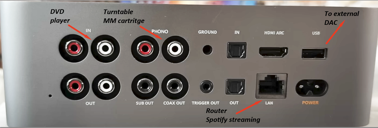

Has anyone tried the connectivity options as per the photo below??? Would that work?
The DVD player and the turntable are inputs; the digital audio stream is going to the WiiM Ultra USB out, and then to an external DAC. Can I:
1. Control the volume on WiiM Ultra with either input selected?
2. Use the WiiM Ultra 10-band PEQ with either input selected?
Is there an embedded Spotify app, for hassle-free streaming through USB out? (I assume the 10-band PEQ will work in this case 100%)?
What is the resolution of the digital audio out (USB out) stream?.. and can it be changed for each input option? Is there an upsampled combination at which the PEQ is not available/can not be used/does NOT work?
If you bypass the volume and room correction, then the USB output is bit perfect to whatever digital input you put in. For the analog inputs, it looks like the ADC has its own settings so I guess the volume and room correction would follow the bit rate? I haven't tried this but.. hmm... it would be easy enough to drive some analog signal into the unit and look at what bit rates come out of the DAC.
When I run Tidal Connect from the PC, Chromebook and Android phone via WiFi and then connect the DAC to the USB, whatever bit rate is being streamed in Tidal: "low", "Master", Redbook, 24/96, 24/192, etc... is also the bit rate that WiiM Home and the DAC show.
I have not yet tried connecting via the ethernet network. I just bought a 2nd WiiM Ultra yesterday, so this weekend I will try it with a hard wired ethernet connection. The reason I think they both will work is because they both use the same TCP/IP stack.... the only difference is between the datalink: ethernet or WiFi. Just like your PC. I recall reading in their site that if you plug ethernet it automatically overrides WiFi which makes a lot of sense,
My wife uses Spotify, so we'll give that a spin since this second unit will be primarily for her. I'll let you know. In the User's Manual, page 8, it tells you to go to spotify.com/connect
For your experiments in other connections... ideally you'd use a DAC that shows the bit rate. The Topping D90SE is perfect because it has a BIG display I can see from 10 feet away. I suppose WiiM home has a display somewhere

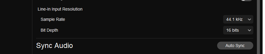

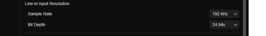

Aaahh did you see this setting?
the sample rates are 44.1, 48, 92 and 192. The bit depths are 16 and 24
I suppose this is the same bit rate that will go out the USB?
BTW, I set the SPDIF and Coax also to 24/192 but there is no setting for the USB output. But based on the settings and behavior with Tidal Connect, it looks like the USB connection will output whatever the ADC is generating. Even when the volume control is turned off ( Fixed Volume Output ) at the top of the WiiM Home Audio configuration page.

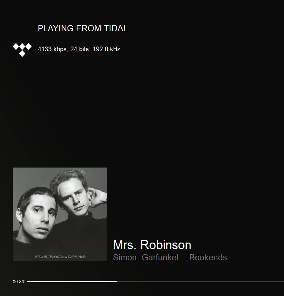

Last night I was playing a Simon and Garfunkel Greatest Hits stream over Tidal HiFi... it's been up'd to 24/192. And the WiiM and DAC were both playing at that level... it sounded very good. So, I've been sitting on the 2nd WiiM Ultra not knowing where I was gonna put it, den for wife, living room for me.
Now I don't have to think about it. I think I'll set the one I got on Sunday in the living room, easy to access. I'll install the 3rd one in the den next weekend... that one requires some moving of stuff.
