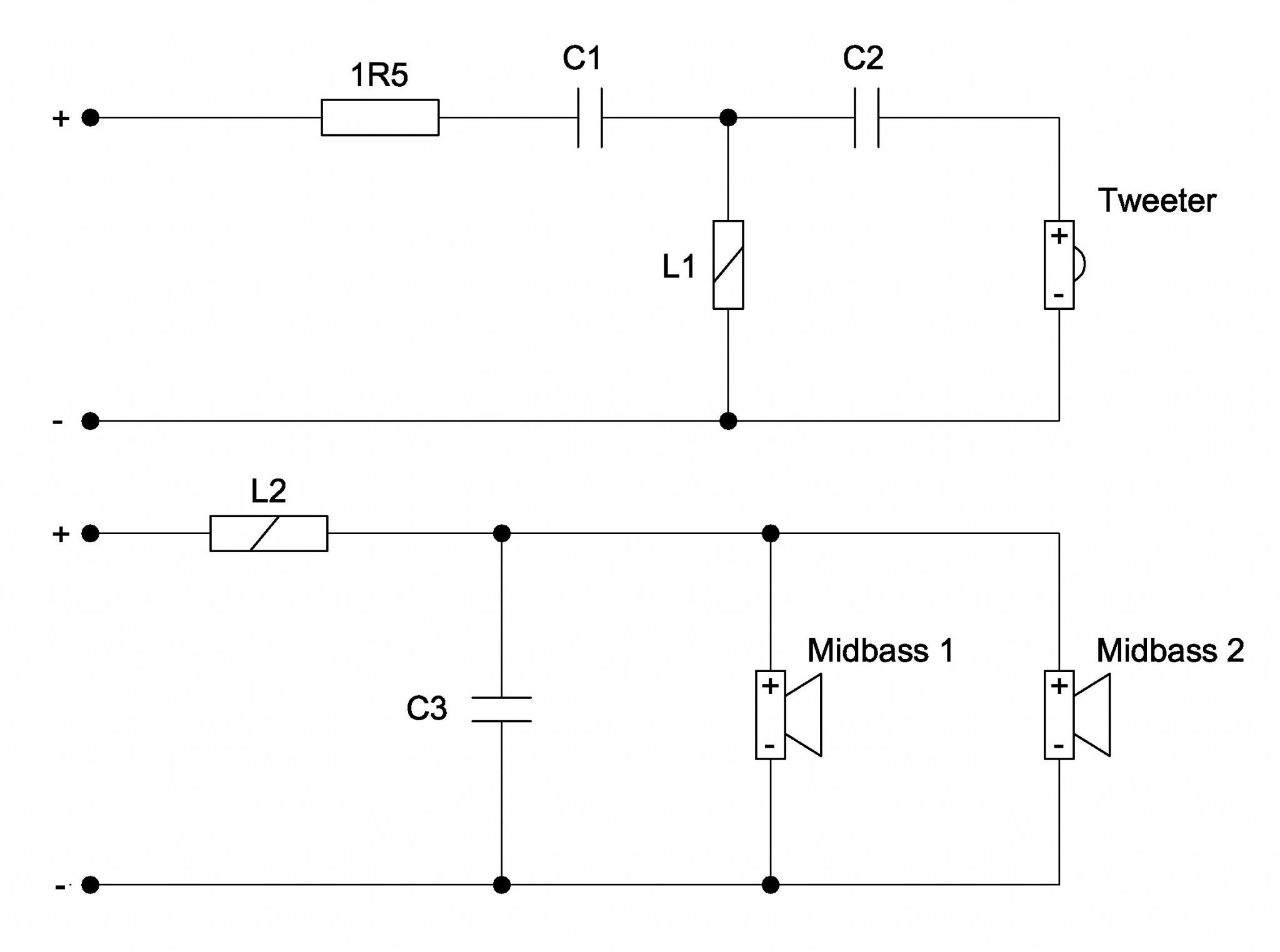

Attached is NIXIE's interpretation of the ProAc DT8 crossover.
Thanks Galu. If the two different 6.5 play // , that surely was funny to develop! How two different drivers playing the same frequencies on several octaves can not echo ?? A mtm is already complex with two same drivers but with two different that have dissimilar T&S... It is above my understanding.
Are our ears so little sensible...really odd to me. As wrote AllenB the lower woofer must roll off in the highs way early the top driver. Below the Schroder room frequency the parreleling should be less important, the room dictate the behavior somehow and the // drivers fixe the baffle step.
They did had made a lot of measurements...
@ diyiggy
It is not a 2.5 way. Check out the link: https://planethifi.com/proac-response-dt8/

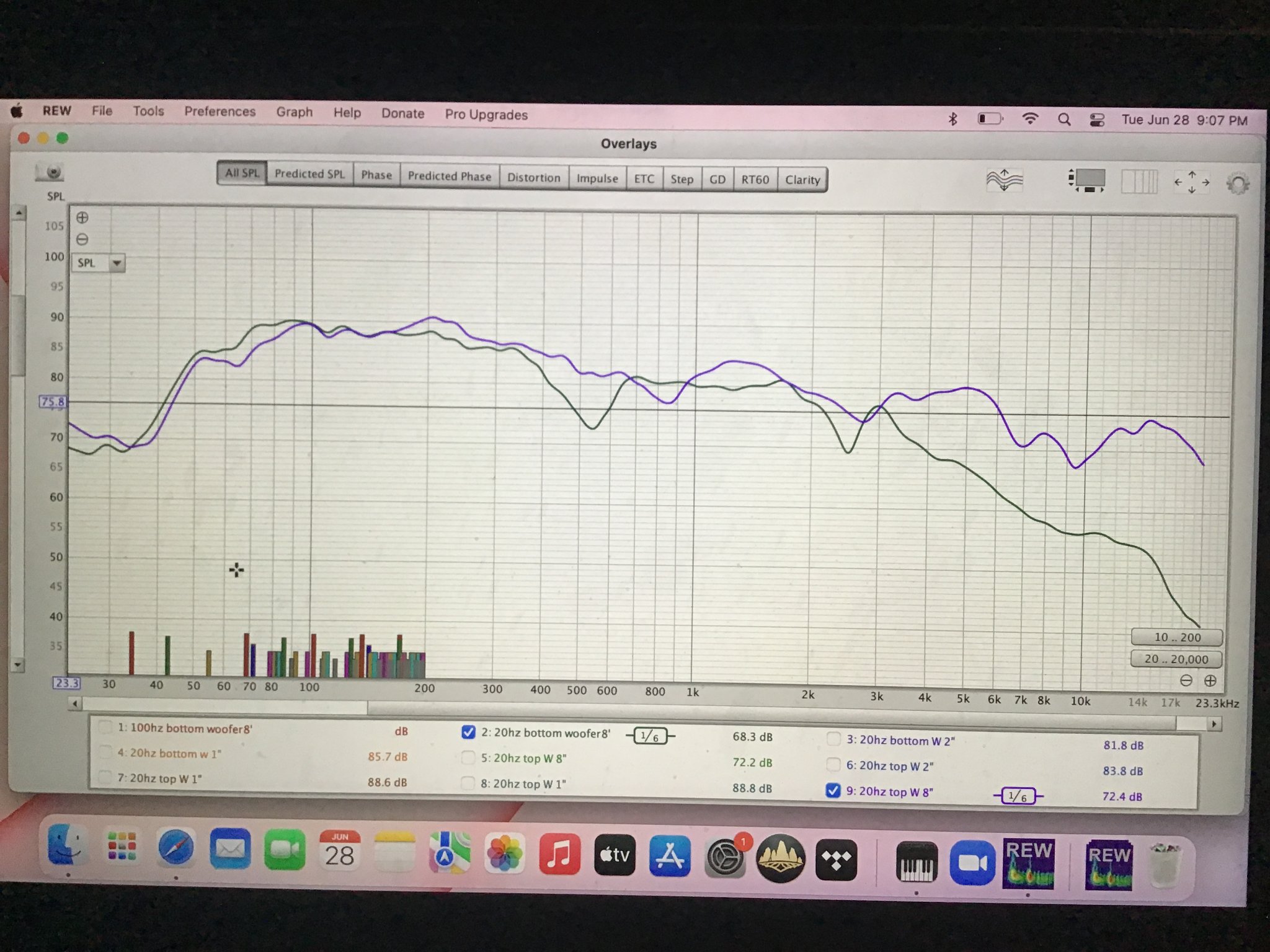

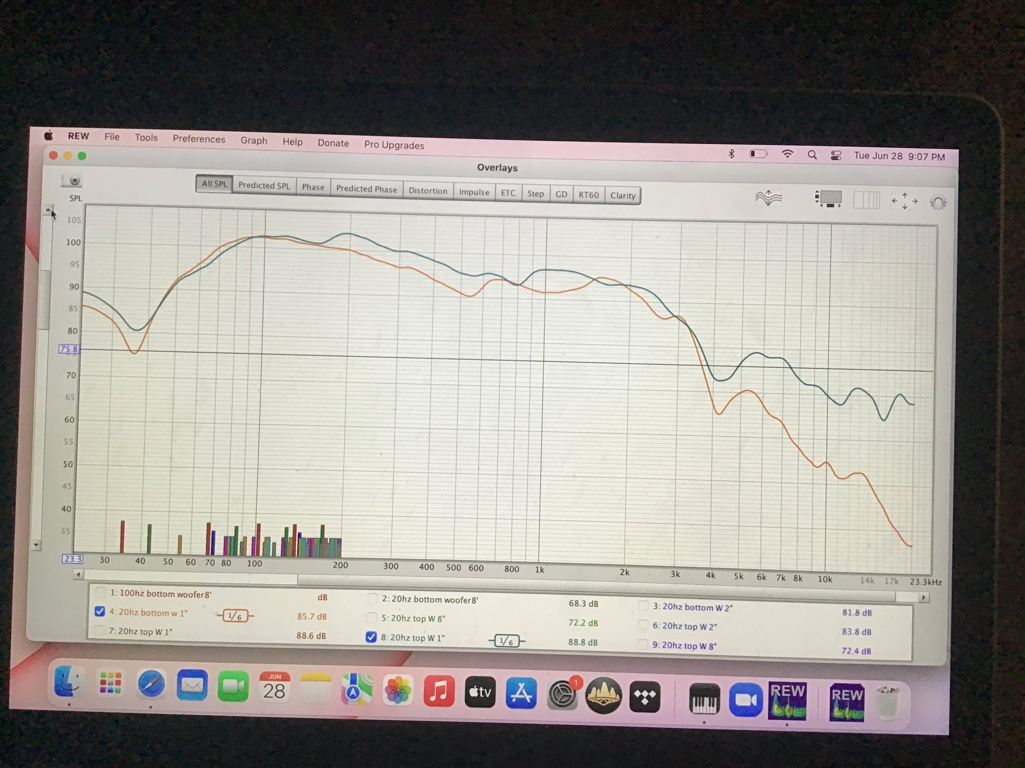

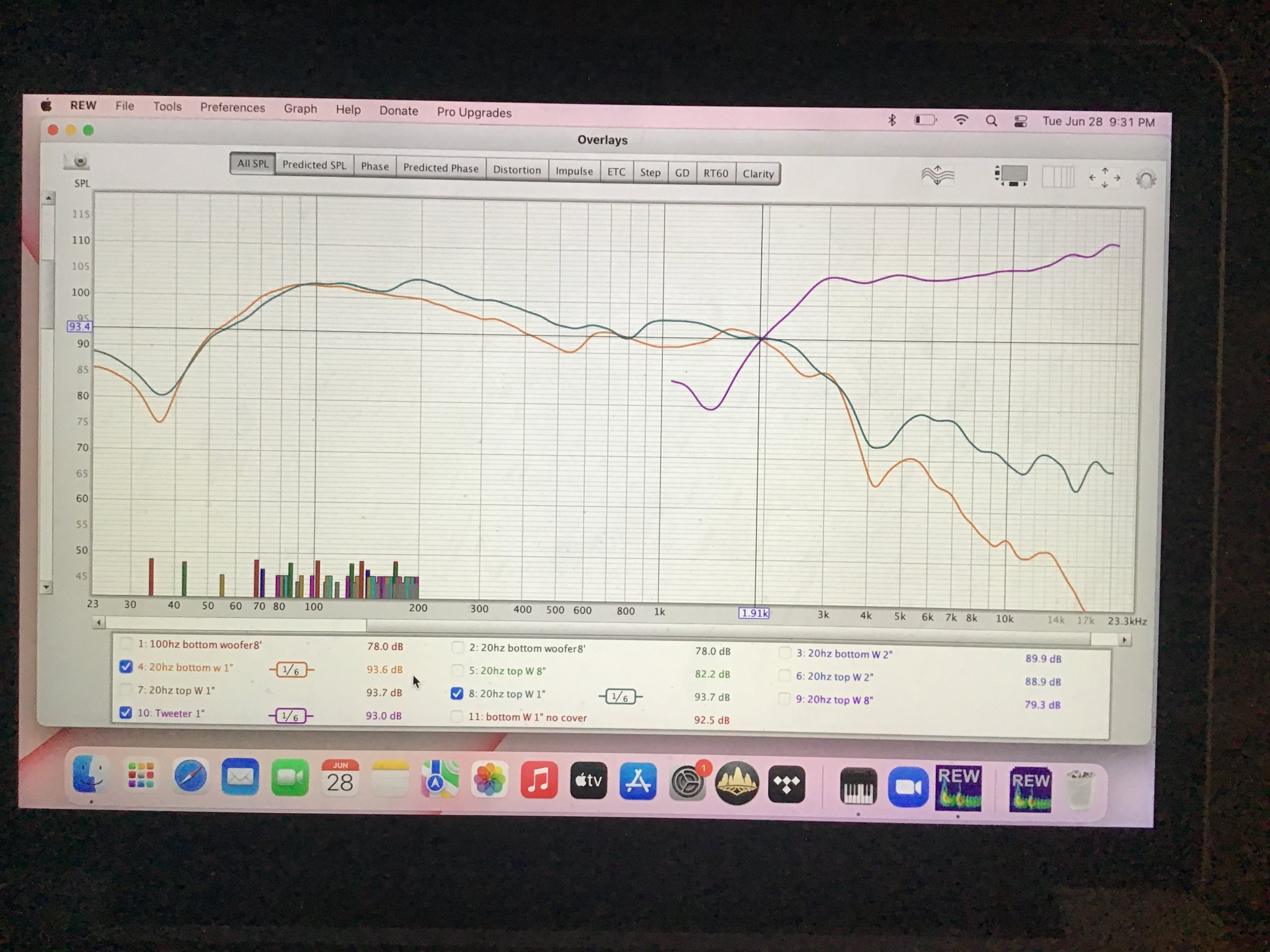

ok here are the measurements I took
I measured each woofer with the tweeter and other driver covered with a thick pad of memory foam.
measurements were taken at 8” and 1”.
of course this wasn’t perfect.
oh and mind you this is with the 16uf value on the woofers xo instead of 18uf.
tomorrow I may take measurements again with 18uf in there
addendum. Added a measurement of the tweeter as well l but didn’t cover up the woofers. Started the measurement from 1khz
