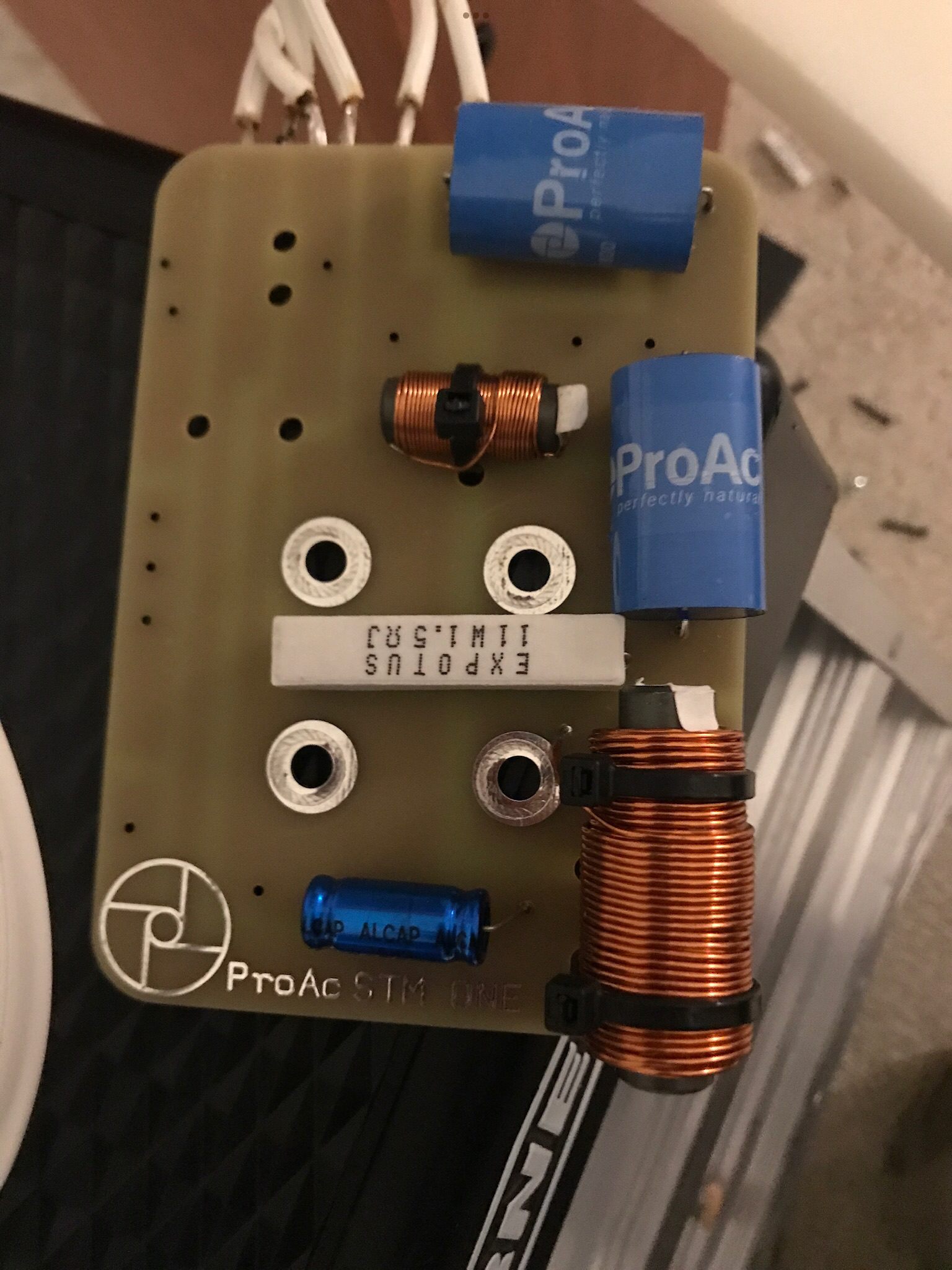

here is the xo in case you didn’t see it.

But if you want to re design the filter, why would you change it ? You have just to find the precise capacitance of the Alcap value to have the good XO cut-off.
Look the coil, it is unwinded to have a precise value too.
This is not a gogo filter, what you have to do is just to find the precise Alcap value with your ears ! Easy 🙂

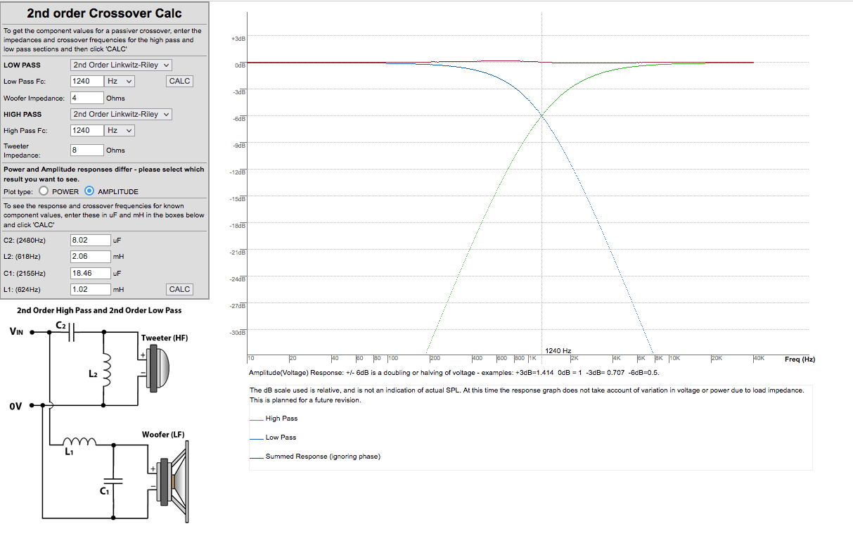

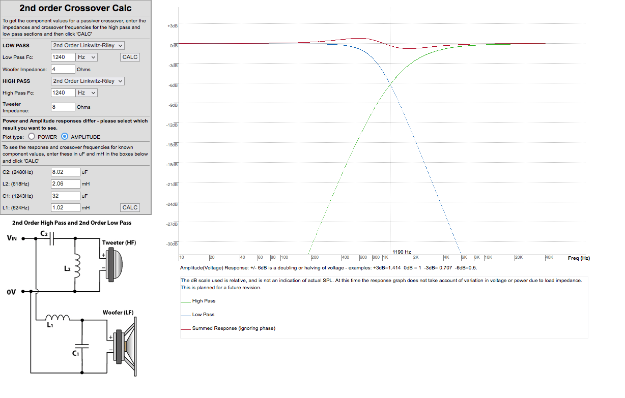

Using this calculator, which allows substitution of individual part values:
https://speakerwizard.co.uk/1st-and-2nd-order-crossover-calculator-and-response-simulator/
And with no idea of the your speakers actual crossover point or type (BW or LR), ran a few examples.
Though the examples assume fixed impedance and inductance for the drivers through the crossover region, (usually not valid), they do indicate little change from a 16 (design goal) to an 18.46uF woofer capacitor value.
Doubling the value to 32uF makes the slight difference in what you are hearing more apparent.
View attachment 1067250View attachment 1067251View attachment 1067252

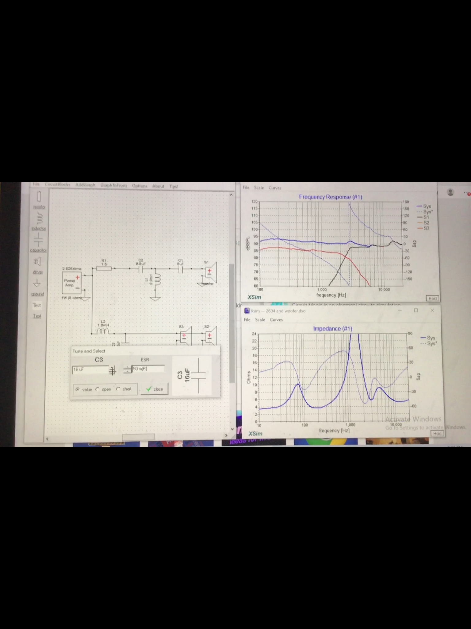

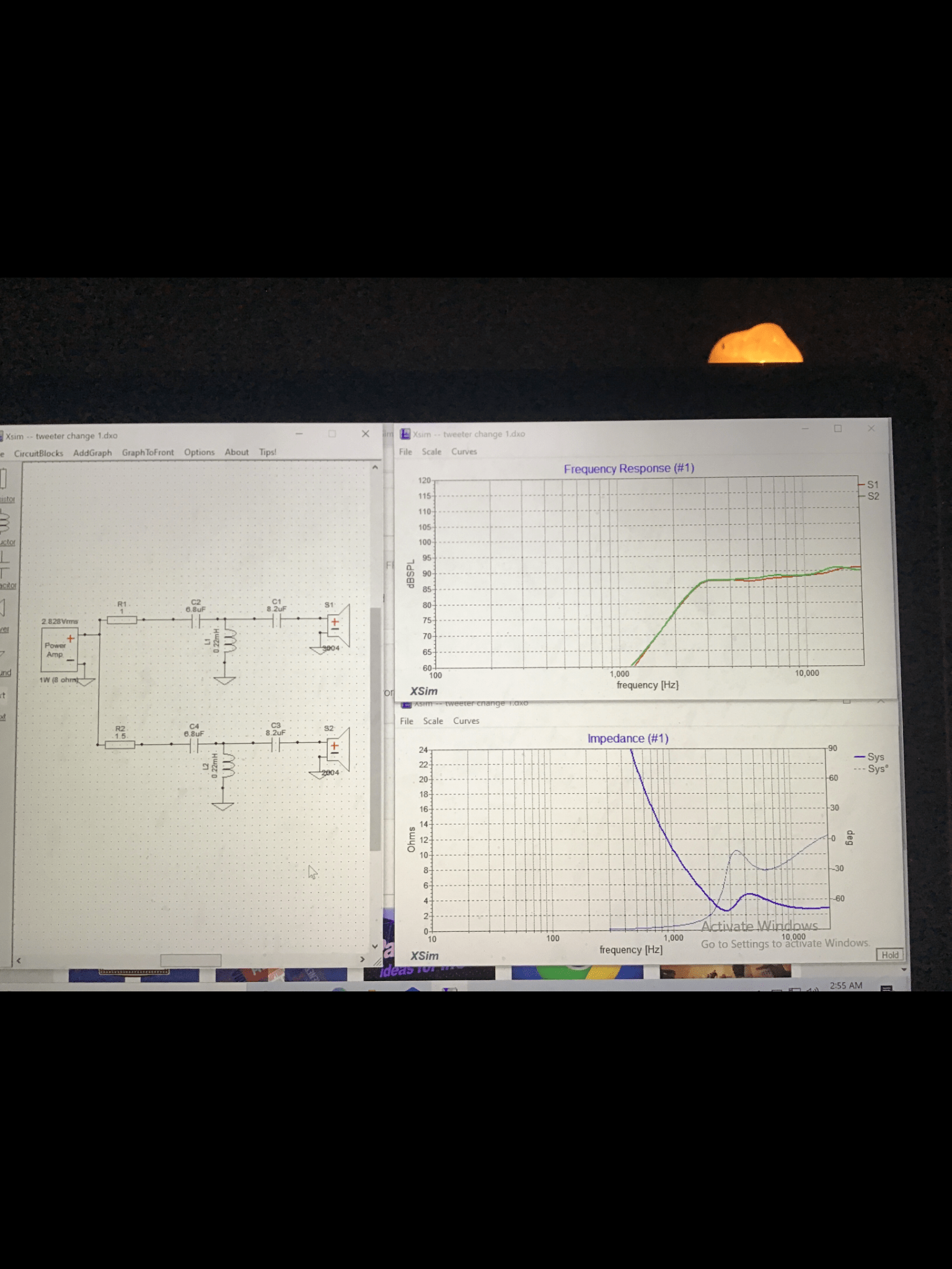

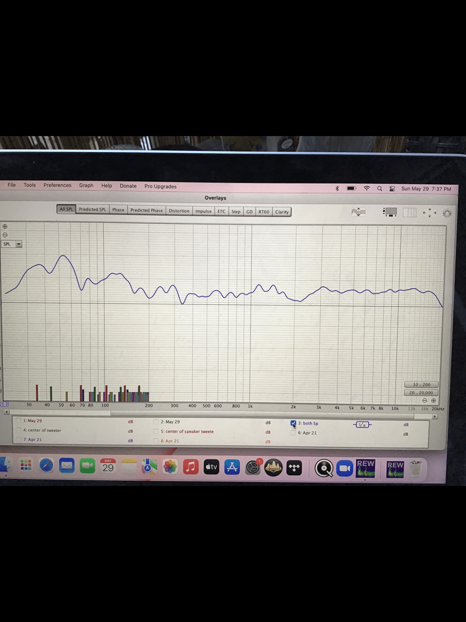

My xo looks more like the attached file.

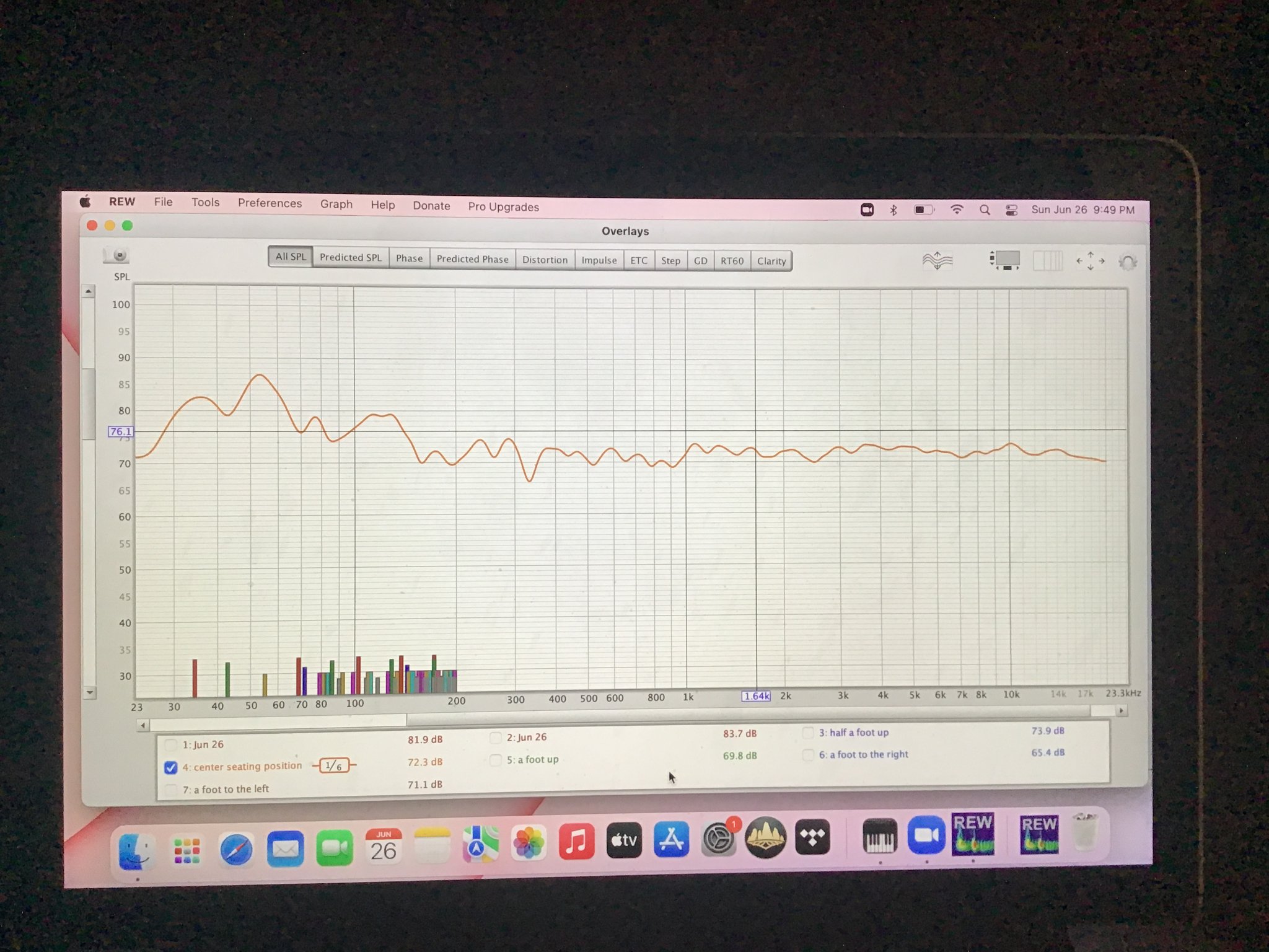

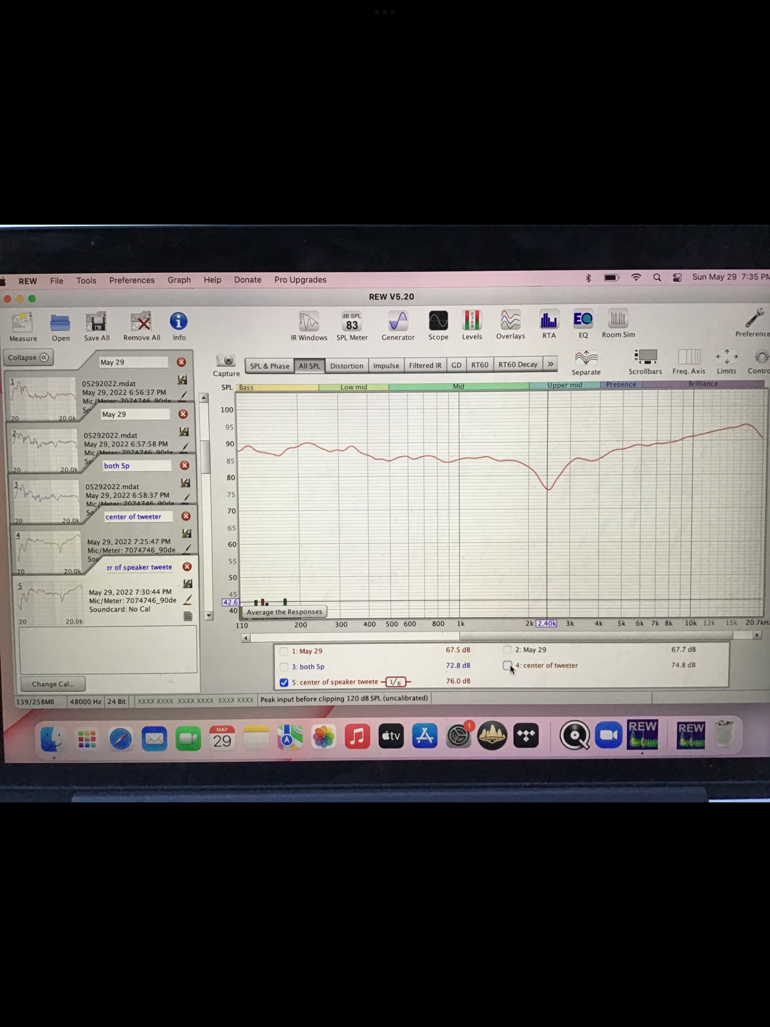

Also attached is a measurement of my speakers ( with the 18uf value in there) at a close up measurement. I’m assuming my XO is at around 2.5khz.
thing is that on axis in my seating position the freq response is pretty flat. Other than that I get a bit of a BBC dip from 1.5khz to 3khz off axis
one attachment is on center at my listening position and the other is about half a foot or so up. So you can see what I am talking about.
the speakers are an MTM design.
i was thinking of maybe ‘ filling in that BBC dip ‘ by making some changes to the xo values and see how it sounds. Maybe I like the BBC dip.

i don’t know if Proac made the xo to have a 16uf cap which is +%10% and is over that. The speakers are only 2.5 years old. Of course I don’t know how old the capacitors are. If they had them lying around or something.
i do know that I prefer the 18uf current measurement of the cap versus the 16uf which is printed on the label.
tomorow I will get a couple 2uf caps and put them in parallel with the 16uf to make 18uf and see how they sound compared to the electrolytics that were in there as an experiment.
ProAc DT8 are fairly expensive loudspeakers, so markbakk is right. Capacitors are selected based on actual measurement and, by design, they should be 18 uF. Though, I’m still surprised to find electrolytic capacitor at any xover position, considering DT8 price.
well they are proacs entry level speaker for their response line.
but then again think of the space a 16uf or 18uf poly cap would take on that small board. And the cost would be quite different.
my initial ’ experiment ‘ was to see if I could hear the difference between the electrolytic in there and a poly cap. Little did I know that it didn’t measure at 16uf but 18uf.
and to your point and markbakk. I don’t think that both caps would measure 18uf by accident if they drifted. What are the odds.
