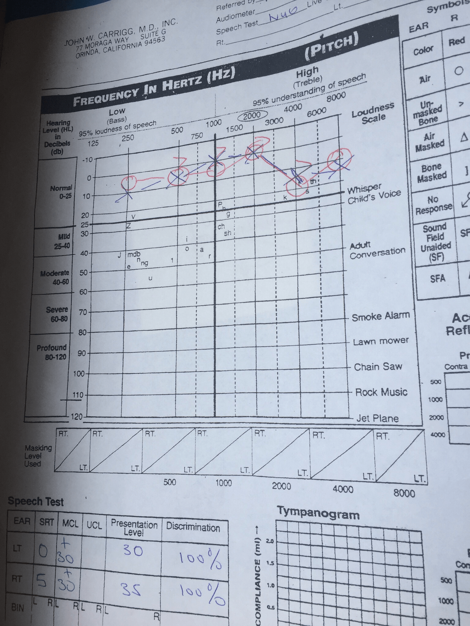

Before diving off into money spent on bypass caps, check your hearing. Mine stops at 14 khz no point in spending money on any sound above that. Most males over age 12 are significantly worse than that due to fireworks, firearms, scooters, motor in general, rock bands, excessively loud concerts. I was trained to use earplugs by the Army in 1969 and have done so in all those situations. My damage results from firing the Howitzer at that camp, an experience my draft # would not allow me to avoid.

Still can heat up to 16.5khz in my left ear and 16khz on the right.
but still that will wane with time.
and it’s funny you mention that, whenever I mess with XSIM and I check out the tweeter, as soon as I get to around 15khz I’m like yeah ok. Lol
14khz at your age seems really good though, if I were to guess you age by what you wrote. I’m 53.
