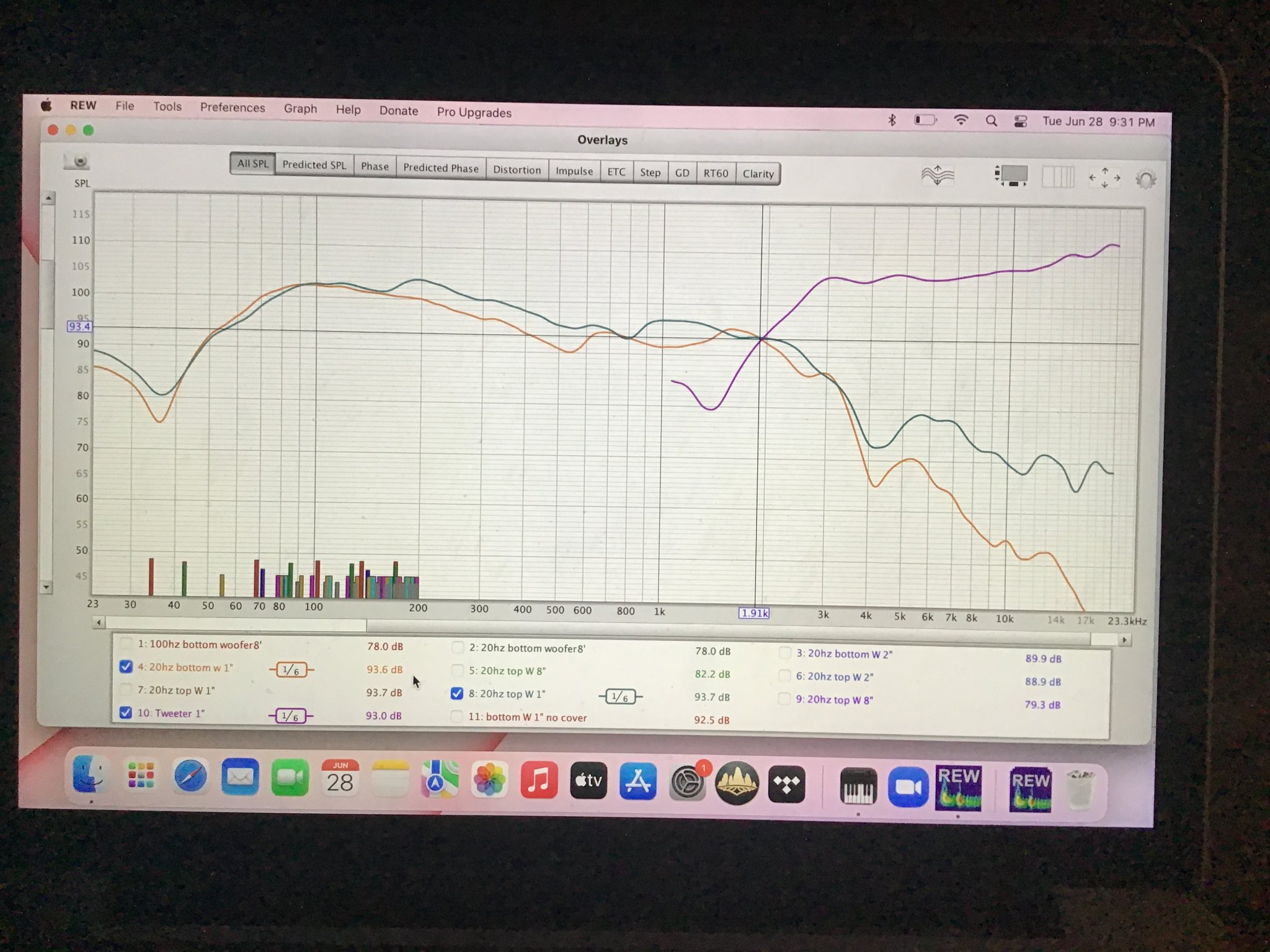

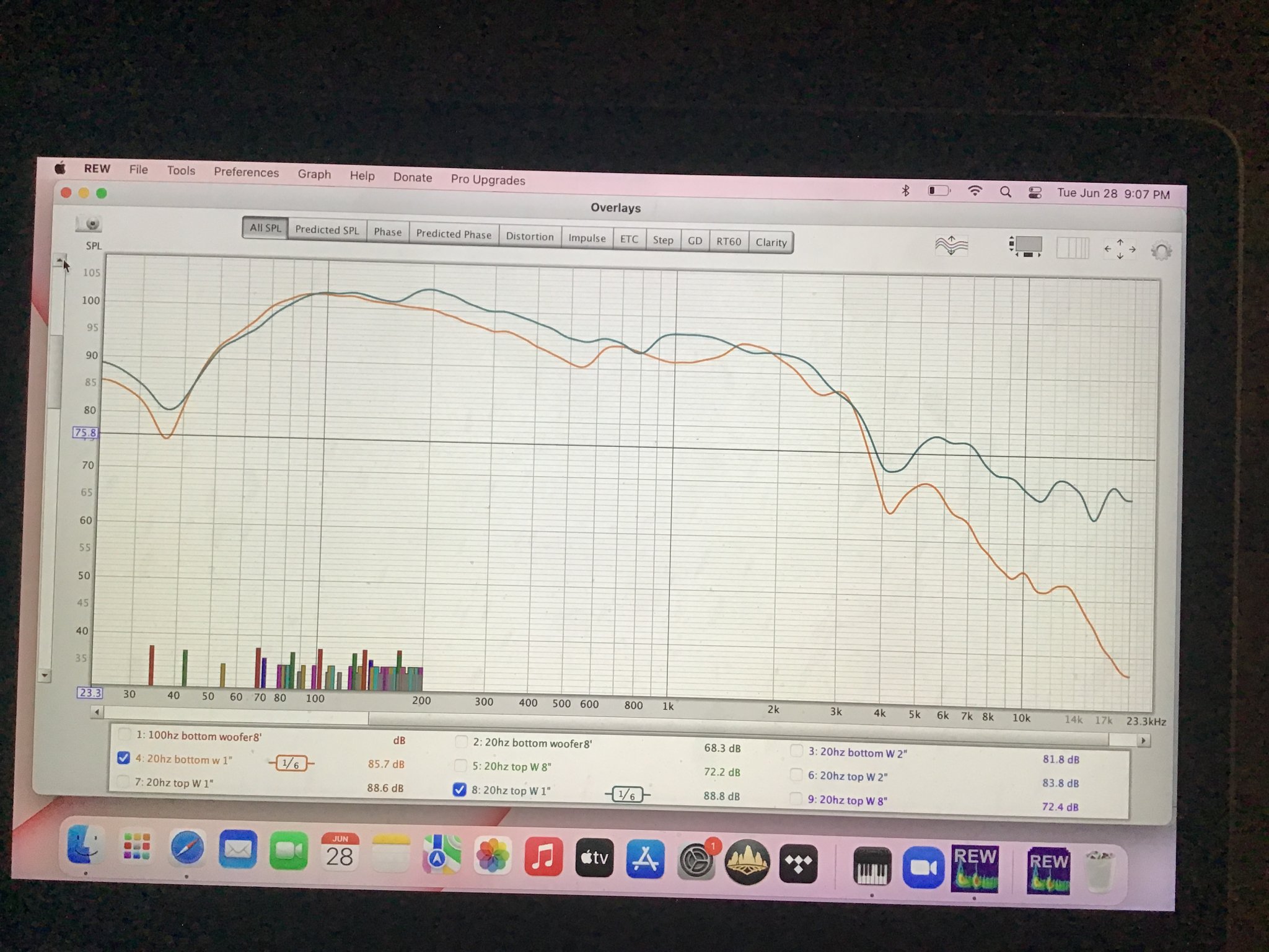

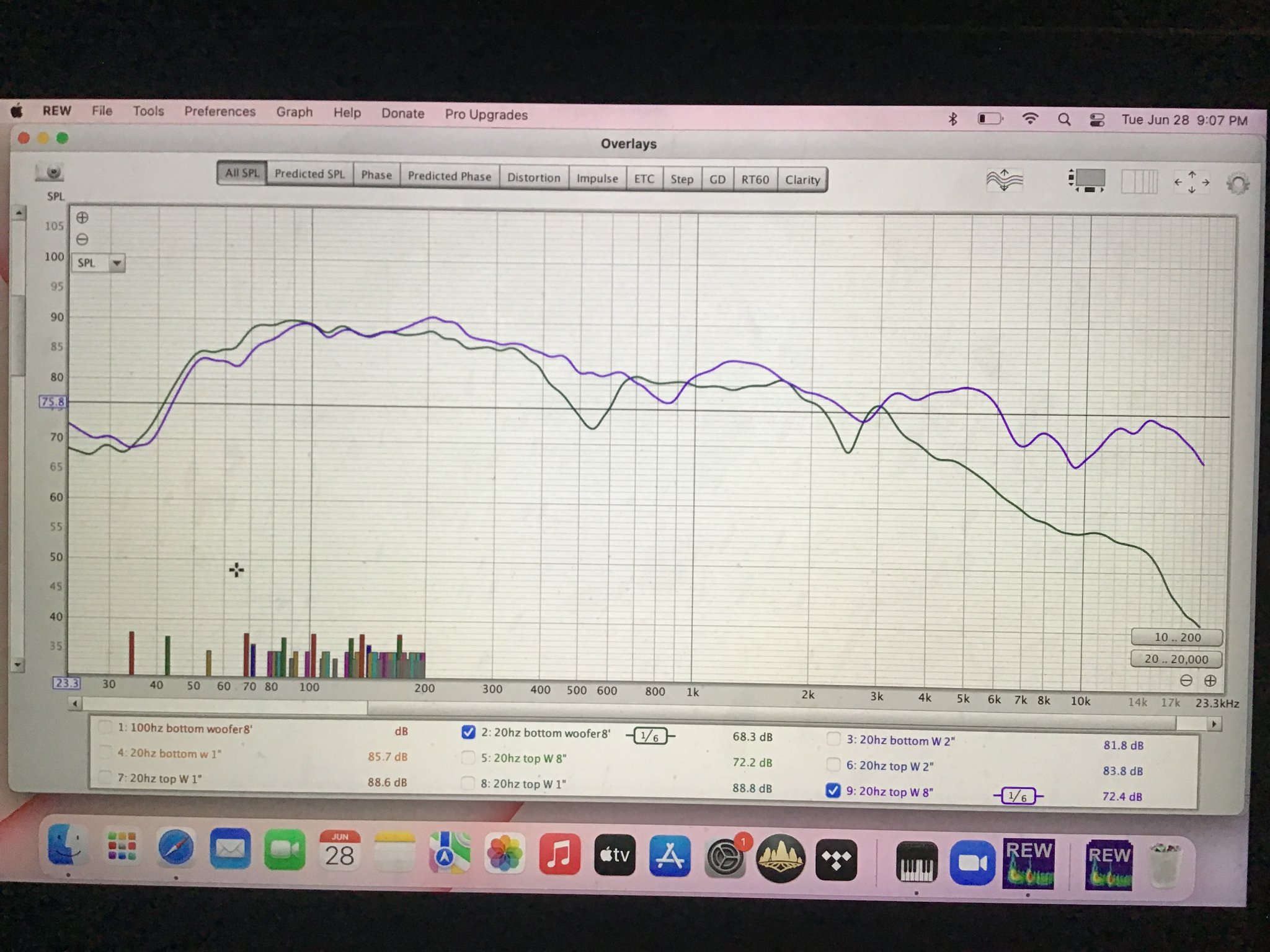

hey Allen did you check out my measurements I took yesterday of the woofers?
i posted them a few posts ago.
but here they are so you don’t have to go digging
I put a thick piece of memory foam around the drivers I wasn’t measuring.

Ref the charts. I can barely read the legends at the bottom, one color seems to be 100 hz middle color seems to be 20 hz. That is perhaps smoothing function? Also I can't tell if left is paper woofer and right is poly woofer or what, both legends say bottom woofer, IMHO. Anyway that drop at 550 hz and 2.4 khz on the left looks nasty. Somewhat smoothed out by the middle chart, except not a lot of help at 2.4 hz from the middle chart woofer.
