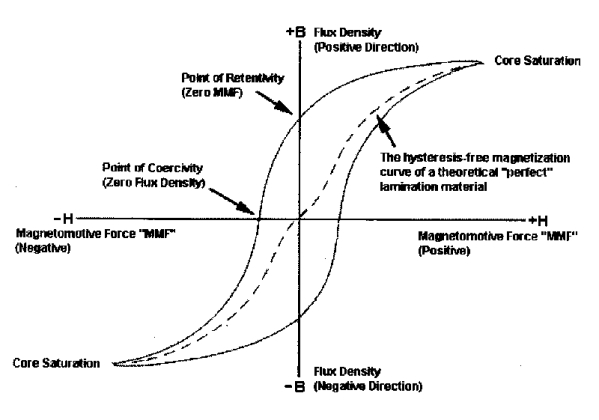

This is wrong. You are just substituting the correct term " hysteresis" with the incorrect term "kink".
Perhaps. I do know what the graph looks like:
attachment.php
The dotted line passing thru zero plagues every PP amp with an OPT.
Ideally it should be straight, it can be made very small.
dave
Dave - you can look at it like this. Hysteresis is caused by re-orientation of magnetic domains. With DC magnetization, some proportion of domains do not change their orientation while constant magnetization is present, so they can be excluded from the picture. The remaining domains do change their orientation, so they behave according to the same B-H curve as in a transformer without DC magnetization.
It's not like that at all. Transformers of any kind and DC voltage is a poisonous combination. Even a small DC voltage has a huge impact on the AC magnetization of transformer core, leading to core loss, core saturation, hysteresis, unsymmetrical magnetisation, production of harmonic voltages, overheating and a bunch of other problems. You have much left to investigate.
