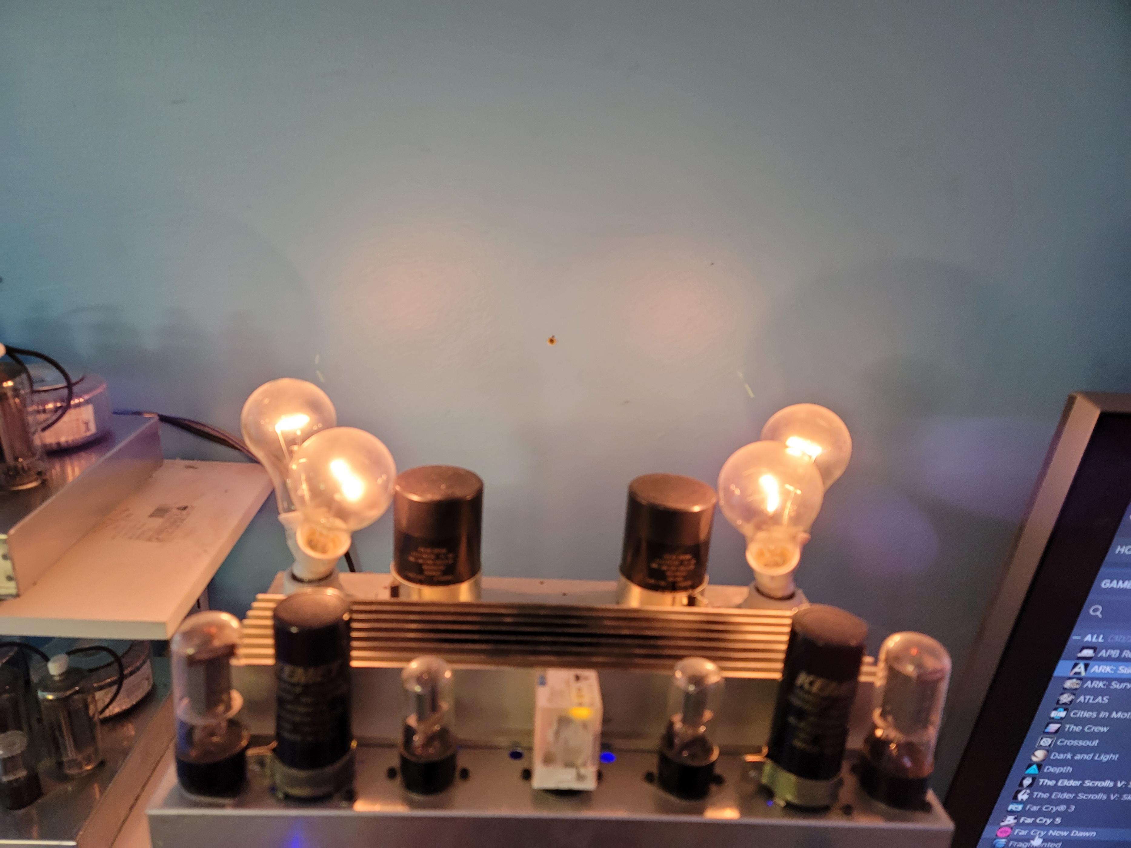

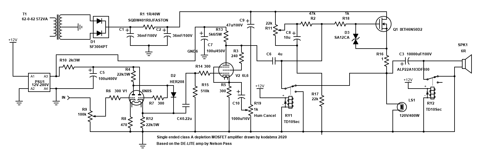

I built this instead 🙂
The "Hum cancel" circuit is only a thought, I didn't build it in. I might have ditched R16 for a short, too.
D3 is REQUIRED or blow up your MOSFETs
