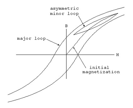

For reasons related to field coil loudspeaker driver design and construction, I have spent time examining and dealing with magnetic hysteresis, particularly the ‘zero crossing’ kink. In a field coil driver, the magnetisation path is the tapered hysteresis loop in Dave’s diagram with its locus (centre of area) lying over the origin (the point [0,0]). In my experience, the ‘kink’ is hardly evident, as the magnetisation curve is almost never at [0,0] in the presence of any signal (even very very small, musical or otherwise). What is evident is the distortion generated by the signal travelling around the hysteresis curve – for small signals, it’s proportional to the signal level and inversely proportional to permeability (big signals can put the extremes of the hysteresis curve into saturation and proportionality evaporates). Symmetry around [0,0] tends to reduce even order harmonics.
In push-pull amplifiers, the locus of the OPT hysteresis curve is at [0,0] when the anode currents of the output valves are exactly equal at the operating point – as with closely matched valves. And it would stay there if the valve characteristics were matched at all signal levels. I have never quite experienced this. In practice, each valve is a bit different including differences in rectification when dealing with a signal - feeding the valves a signal usually produces a measurable DC offset across the primary of the output transformer when, at idle, there was almost none (RDH4 addresses this phenomenon). The offset varies with signal magnitude and (often) frequency. The locus of the OPT hysteresis curve therefore wanders around [0,0]. Symmetry (and cancellation of even harmonics) varies somewhat with frequency and signal level. I don’t want to exaggerate this – 2nd order cancellation is evident even when the signal starts to saturate the OPT.
Single ended amplifiers show an analogous effect. At idle, the standing DC in the OPT primary places the magnetisation at some point [A,B] on the B-H curve. Once a signal is imposed, the magnetisation travels around what is called a ‘minor hysteresis curve’ in the upper right quadrant of the magnetisation curve (see the illustration attached) roughly centred around the point [A,B]. I say roughly because the output valve will to some extent rectify the input signal, moving [A,B] to some new point on the magnetisation curve (measurable as a DC change in operating point) that depends on signal magnitude and frequency. Importantly, the minor loop is asymmetric and the resulting output includes both odd and even harmonics. Most single ended OPTs are designed so that the idle locus [A,B] is in the upper right portion of the B-H curve. In practice, large signals tend to induce saturation in the upper right portion of the minor hysteresis curve well before the lower left portion approaches [0,0].

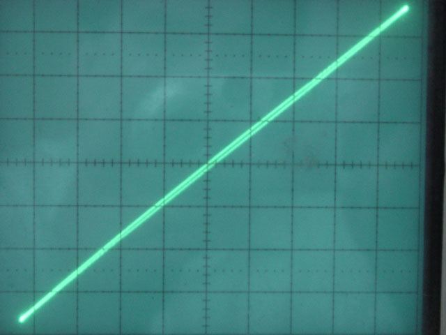

In praxis, the curve becomes almost a single straight line.
Certainly for OPTs with a significant air gap in the core.
SE and PP transformers BOTH go through zero crossing of the magnetization curve. What DC magnetization causes is not moving the operating point to a more linear area, but moving the whole B-H curve upwards and squeezing magnetization headroom. The analogy with tube DC biasing for Class A is wrong here.
Transition through zero magnetization has no "kink", it is straight line.

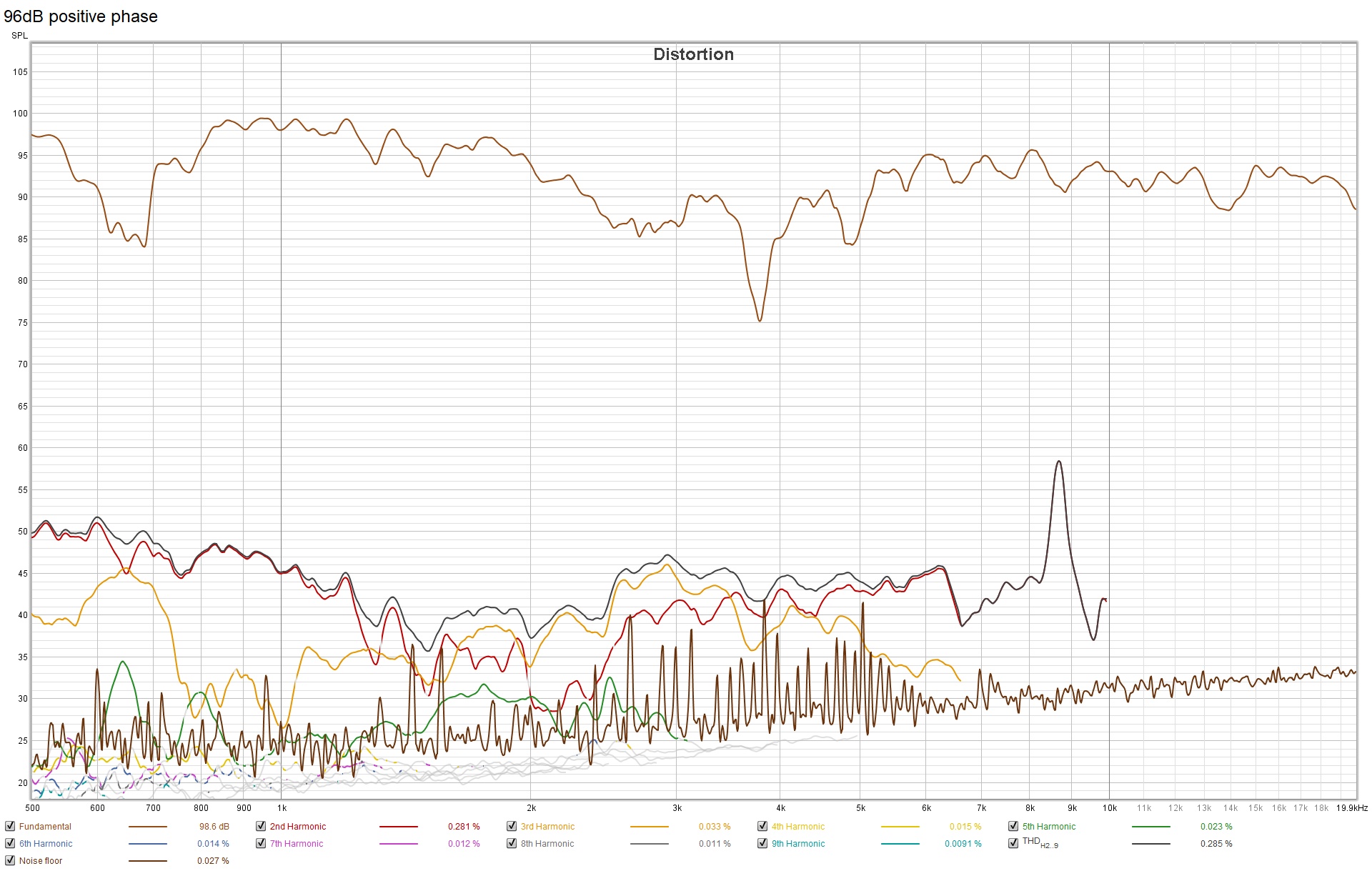

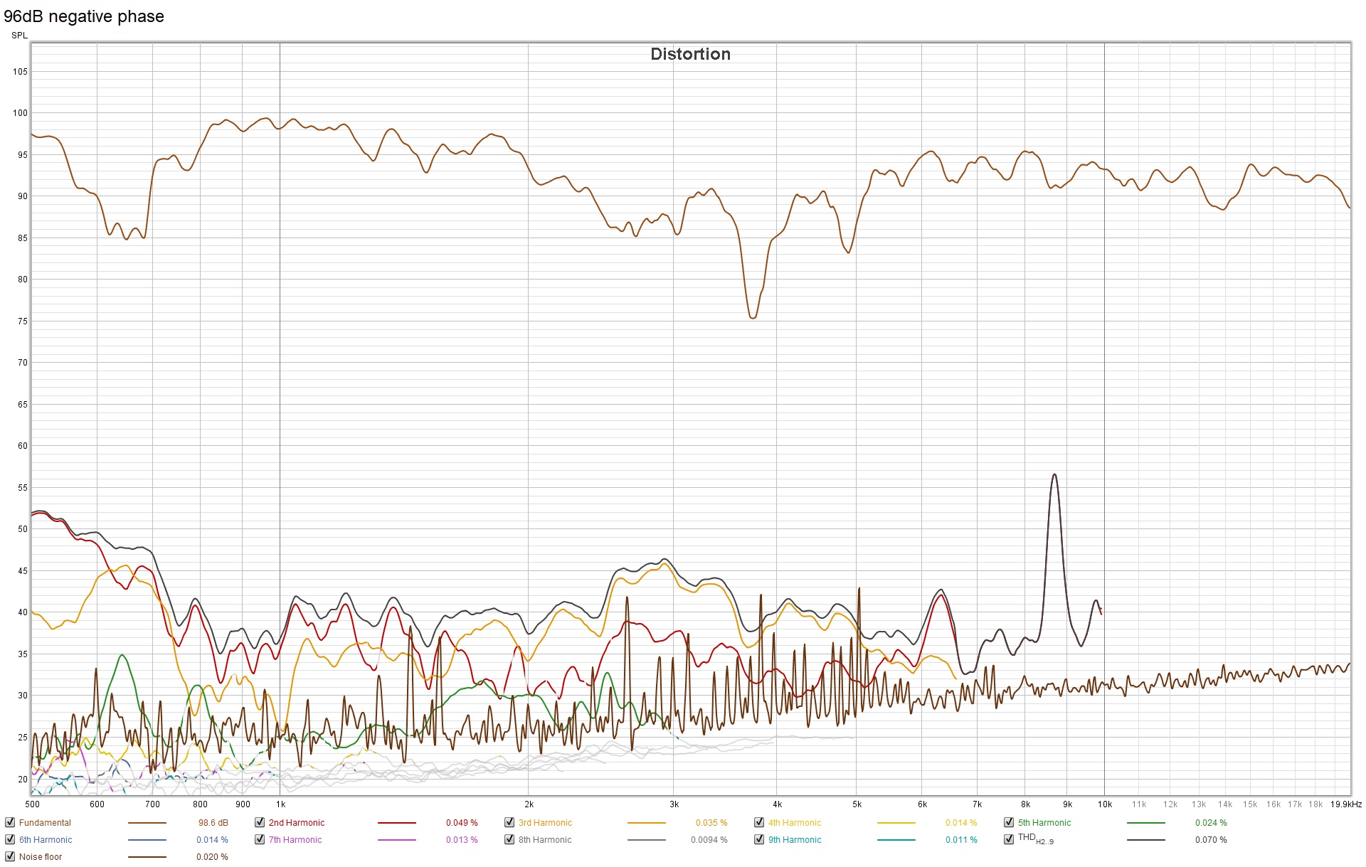

It's measurable. Two distortion plots below, a bench 6LU8 pentode SE into an old PSB Alpha Mite. The only difference between the plots is flipping the speaker phase. A pretty intuitive result obscured by decades of audiophile bun fights.Correctly phased, H2 of SE amp can cancel some of speaker generated H2 producing less total acoustic distortion. Works for single driver or multi amp with LLXO setup.
