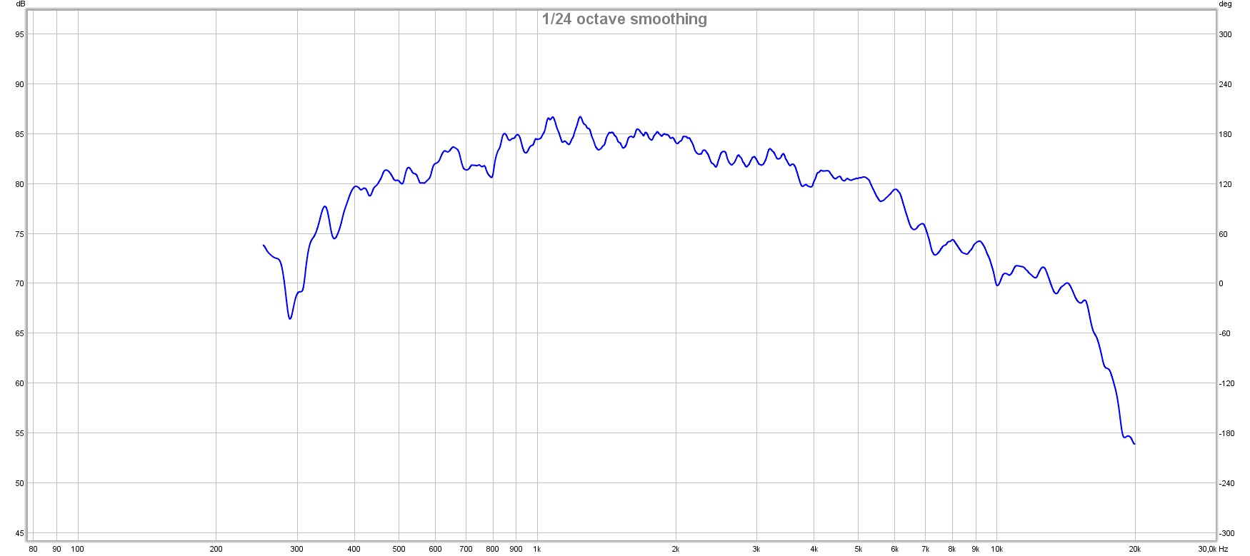

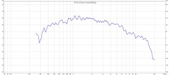

You can do fine without another tweeter too when using a 2" driver. You loose sensitivity because there's not much support above 5 KHz, but I doubt it will matter much for indoor use.It doesn't solve the problem of the need for another higher driver and the inherently problematic crossover at VHF. Better to use a smaller driver and no higher driver at all.
Here's a 2" driver in a Klipsch horn measured without any EQ. There's enough output here to 16 KHz. So what's the problem?
Off axis response of a larger format driver isn't that good so VHF driver is needed.
The thing is that nobody says that 2" compression driver in a horn isn't good enough and that its directivity can't be matched to VHF driver. It's just harder to do that than using a smaller driver and not having to care about another xover point and directivity matching - but it isn't impossible.
