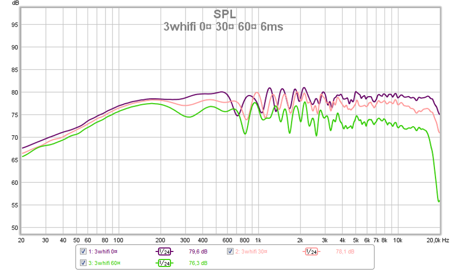

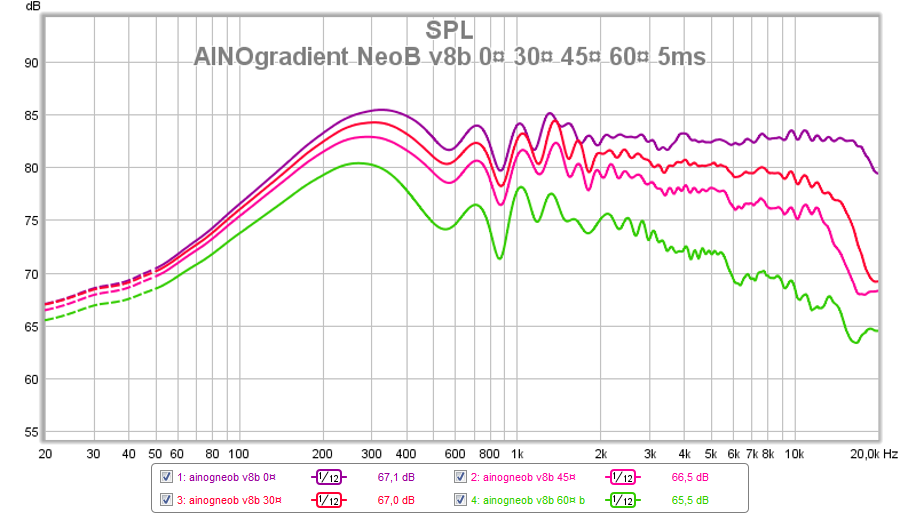

I have two recent diy designs with very much nice directivity, but different. It is this multiplex variabilty that makes speaker design and evaluation so interesting! First one must rationalize the goal, then means to achieve it and finally construct it to the best.
