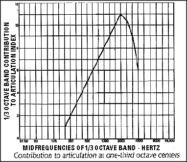

now that´s interesting! Thanks! What´s this "articulation index"? How is it measured?The reason I do it:
You're welcome! I will have to get back to you as time permits. The short answer is I don't know. At the time I saw it I took it to be a graphical way of showing why/how the pioneers chose XO points based on then known hearing acuity data, but here it is many decades later and I still haven't gotten around to studying the DESIGNING FOR SPEECH INTELLIGIBILITY section of Don and Carolyn Davis's SOUND SYSTEM ENGINEERING simply because choosing XO points based on my [right/wrong] interpretation of it has worked well for me.
GM
I've seen similiar graphs as well, all peaking at 2khz.......which immediately reminds me of the all the 6" two ways crossed at 2khz. Maybe 4khz isn't even low enough?
The pioneers didn't think so, they chose 5 kHz, which makes sense based on the early hearing curves and really should be up around 7-8 kHz for the more recent ones. I've traditionally used 7.5 kHz once I found out that this was an easy way to deal with many driver's excessive sibilance.
