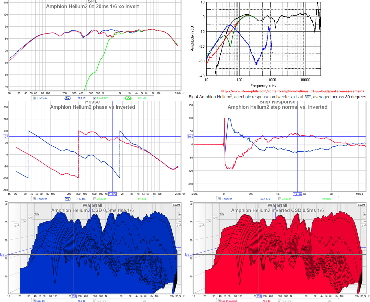

Some of my measurements of it. The xo is said to be asymmetric, I swapped polarity and summed response was about the same but phase changed. Blue is standard in the last picture ( I listen to them modified, bass polarity inverted if I remember right). I use them for HT rear channels now. I was unable to hear a difference in sound when switching polarity. Perhaps I should do some more tests with them now, I might learn something
