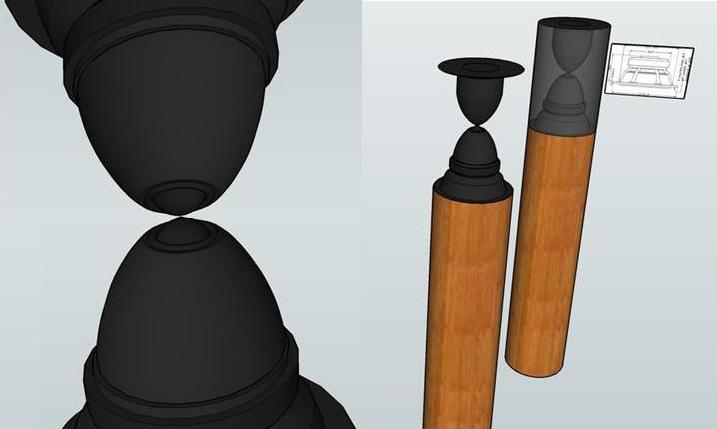

Was playing around with this idea for a while. ER18RNX with a neo tweeter. As in initial guestimate profile curves match those calculated for a dome tweeter waveguide, but wrapped around the central axis. The woofer is inverted. Pretty transparent basket on that one.
Would be very easy to make on a wood lathe.
More flights of fancy ideas than time to mess with them I guess. Probably a good thing.

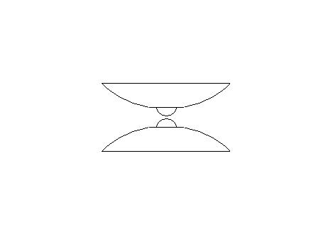

looking at design in post331 got me thinking whether anyone ever tried two domes playing against each other
yes.
CLS has also done this with eminence compression super tweeters.
-my experience..even under the best of circumstances (i.e. good "reflective" profile), there is still treble loss that needs correction.
The other limitation is high-pass filtering and integration with the mid-range driver.
It's particularly interesting to move the two sources apart, where you lower the height of the bottom driver and raise the height of the top driver. 😉
Ah ~ mine is a bad example 😱
