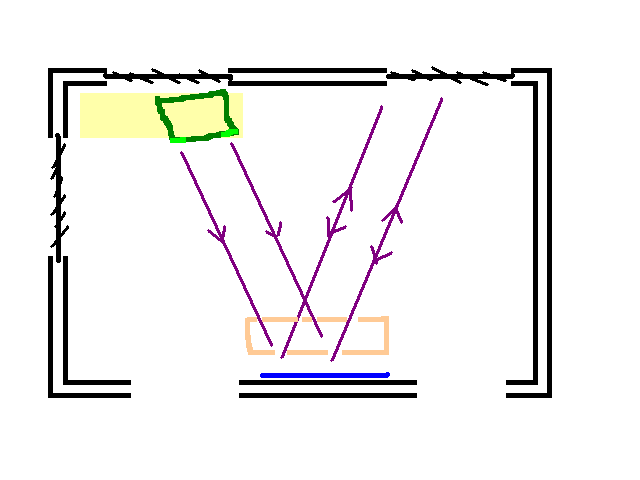

I have a situation in my lounge where the TV is pointing towards a large mirror on the opposite wall, which reflects the sound towards the blinds, and then the sound is reflected back to the couch. On certain material, there is clearly a midrange "presence" coming from the blinds, which is 3m to the right of the TV. It sounds quite awful most of the time, but is interesting nonetheless. 🙂
