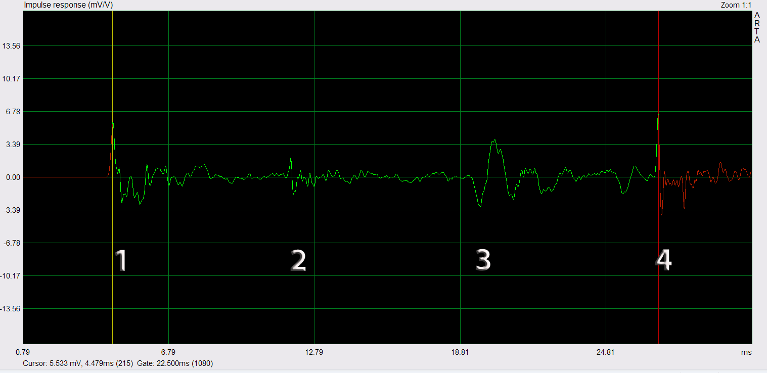

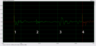

Hi Radugazon,
how loud is that 22ms reflection? I found that precedence is easily overridden by percussive, high frequency sounds if they are loud enough. 22ms is pretty long and can cause echos with percussive sounds.
Markus, I agree :
I notice it on music only on a couple of records (the last Miles Davis for exemple), on congas, once in the disk. It's very fast and I have to be concentrated on it. Even if this could add a permanent fuzzyness, I don't feel it because I must be totally biased and this is classified as "spaciousness" (dn't laugh).
For the occasion, I did a sweep on the right midbass channel (mike in list spot, no filter, no Eq, front speakers only and some stuff in the middle but it's still representative). Impluse is enough to comment the phenomenon : it's a reflection museum here.
1: direct sound
2: 7.35 ms, probably the ceiling, small intensity, same polarity (I have diffusers) but almost full range
3: 15 ms, inversed polarity, it's the backwave of the dipole coming from the ipsilateral side, from the shape (and gated measurememnt) we can see that all that's after 1000 Hz is missing
4: 22.5 ms, normal polarity, it's the frontwave from the opposite wall, and I see today that it contains more HF than the direct sound (normal, this last is at 30° as the reflection is around 10° finally).
This is why I hear the HF part of the sweep coming from the wall. Simple and straight explanation. It's not precedence but directivity effect. About levels, except for the ceiling, they are all grossly the same.
Notice that with my too regular implantation (almost a 3 m multiple everywhere) the reflections have a pace of 7.5 ms. Not a good example, but I don't hear echoes, so...
Of course, in the listening configuration the roll off of the filter attenuates all this or make it disappearing. But this pattern is not reproduced by the
2" and 1" that I have as tweeters. The ceiling reflection vanishes (diffuser...) and the wall ones are reduced to symbolic glitches. Again, it's because their directivity is very different. IIRC, Rudolf once shown this on dipole tweeters, I listen probably in a lobe with very high level at 30°.
Now a good question would be "what is this adding or removing to the reproduction ?"

Reflections are additional sources. They are perceived as spaciousness, apparent source width, listener envelopment, repetition pitch, coloration, etc. When the reflection is too loud and/or too delayed it's perceived as an echo, a source separate from the direct sound. It really doesn't matter if the reflection is coming from a wall or from speakers. What really matters is the overall reflection pattern and the perception it causes.
You disregarded the express context of "sources" as *direct sound*.
You are also discussing concepts regarding larger room acoustics, not small room acoustics with reproduced music, or even small room acoustics generally.
Radugazon's experiments actually parallel these larger spaces because his listening environment is far larger than normal. Additionally the *extreme* loss in pressure above 1 kHz of a 10 inch open baffle listening beyond the null will most definitely result in a vastly lower sp-level for the direct sound above 1 kHz, with a vastly higher sp-level for the reflection above 1 kHz.
