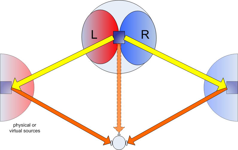

No reaction yet ? Graaf must be on vacation or in power outage, because if quoting this from ro9397:
Personally, being a fan of pure analog Trinaural, I'd likely prefer hemisphere L/R with each L/R hemisphere center facing the opposite channel (the flat side of the hemisphere parallels the nearby wall), with an omnisphere center. The front wall to back of the speakers = 4-6'. Yumm!
with a little decryption it comes close to the center side firing principle (Stereolith if you want) with virtual side "hemispheric" sources, highly debated subject...see the graph for refreshing the memories.
BTW, the analogy with Trinaural stops here, the genuine Stereolith being more primitive, making no special treatment to the difference R - global or L - global.. But, with a more complex system, it's maybe possible to go much further, at the price of a very small listening spot.
PS : what's this Toole's recommended design ???
edit : thx for the info ro9637, but can you make a scheme or show pics too ?

It's said the center channel sees "true center" which is the common portion of R & L. (so the signals of far right and far left would not appear at this ideal center)
Now the basic (stupid) question: how to get it by an analog circuit?
First, if we sum R & L by a mixer circuit, what happens to the common portion of both channels? A commonly seen analogy is a diagram of 2 circles with some overlap between them, as what we see in the math class:
http://en.wikipedia.org/wiki/Set_(mathematics)
So, there should be "2 layers" in the area of overlapped. Is that right?
What's next? How to utilize this?
