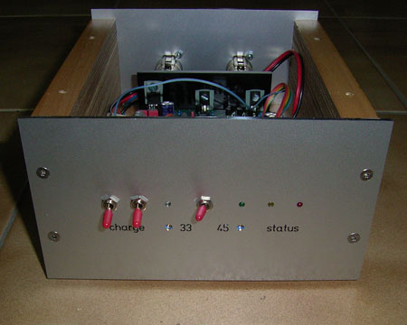

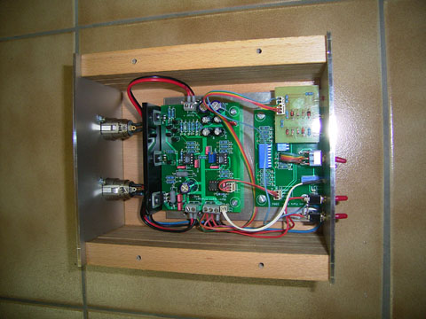

Up and running ! Enclosure time...

I completed my 'Kelly Controller' and wanted to share some pictures and say thanks to all involved in getting this done. When the effort started, I did not imagine how big an improvement this controller is ! Bas - you should reconsider and complete the project. The BIX turntable improves a lot, the bigger diameter pulley and the controller cause a very noticable improvement. The sound is even more detailed, and the bass has a lot more 'clean' punch.
Thanks Mark for sharing this design with us and for providing the boards. Thanks Dave for getting the pulleys done - I ended turning my own in order to keep my motor housing and overall high as it was before ! Thanks superhkm for getting the Maxons. Thanks Algar_emi for sharing your project - it provided some inspiration for my housinghousing and finally thanks to all who participated - your comments, ideas, questions and answers were a big help in getting this device built.
Best regards,
Andreas
