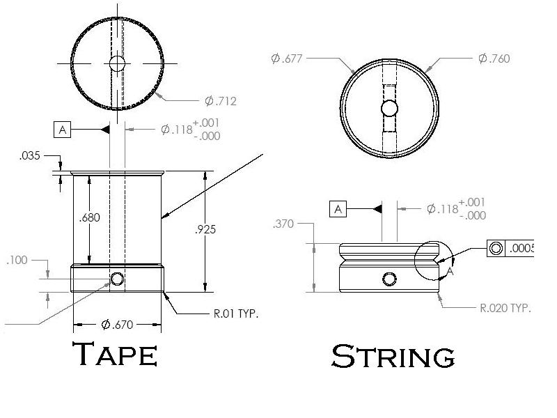

Custom Pulley Offer
Hi Everyone. As you probably knew from the thread, to support both speeds, Mark Kelly controller needs a custom pulley with a diameter of about 17mm.
Following the Maxon GB 2007, Greg Nuspel is working on the custom pulley and will offer both designs, tape and/or string. Prices are not out yet but I asked him to match the Teres price of 25$ or better if possible, Greg will make a prototype for me to try before production.
See the included image for details.
Greg will do a production run of the pulleys, so I can supply you new pulleys if you want to use an other design than the original one supplied on this first Group Buy.
It will be made of aluminium T6 treated material to prevent oxidation and platter deposit. It also offers great strenght and it is light.
It will be manufactured to really thights tolerances, offer a thru hole and can be mounted using two opposite set screws as recommended by Vinyl-Addict. So it will be easy to remove without motor damage.

Algar_emi said:Custom Pulley Offer
Thanks...
If you are going to use opposing set screws it is absolutely critical that the holesize be a very close slip fit with the motor shaft and concentric within 0.0002" The set screws are a very convenient feature but they will work against you if the holesize deviates more than 0.0002" since they are so close to the bottom of the pulley.
I would eliminate the shoulder on the tape pulley since it serves no purpose. It won't prevent the tape from walking and could cause damage to the tape as well. It is very hard to align the tape during the initial setup, at least that has been my greatest challenge since using tape so patience is crucial, however once you have it set up it is worth it.
I see there's no crown on the pulley. It's going to be VERY hard to keep the tape from riding up or down without a crown.

Eric Weitzman said:I see there's no crown on the pulley. It's going to be VERY hard to keep the tape from riding up or down without a crown.
- Eric
Eric, crowning the pulley doesn't work for tape, although rubber belts work best using a crown. You have to adjust the "tilt" or angle of the motor pod to align the rotation of the tape with the platter. I see no up or down movement at all in my application. It does take patience initially to set up.
Well, let's call this a difference of opinion and not get too excited about it. 😉
I've been using tape drive and have had three pulleys, two of them crowned. The belt was hardest to set up on the flat sided pulley and was nearly impossible to keep running true, which is one reason I changed over to crowned pulleys. My motor "pod" is bolted to the 600 lb plinth and doesn't move. I think the belt ran untrue on the flat pulley because of temperature changes and/or slip in the splice's adhesive.

Eric Weitzman said:Well, let's call this a difference of opinion and not get too excited about it. 😉
My motor "pod" is bolted to the 600 lb plinth and doesn't move. - Eric
Ha, Ha. I'm definitely not "too excited" Whatever works for you Eric. I machined several crowned pulleys for tape and none of them prevented the tape from conforming to the shape of the crown as it came in contact with the pulley. I didn't like that, obviously you find it acceptable.
The problem as I see it is your non-movable pod. I don't use a splice in any of my tape belts because the splice is the weakest link and a gap opens up over time due to stretching, then the adhesive is exposed and causes an annoying clicking sound with every rotation.
Your are correct -- I don't mind the tape conforming to the pulley's crown.
The motor distance/belt tension and tilt are changed during adjustment, then the "pod" bolts are tightened. I made an adjuster to tilt the motor axis with respect to the platter/bearing axis. The tilt adjuster was an afterthought. Experience is the best teacher...
