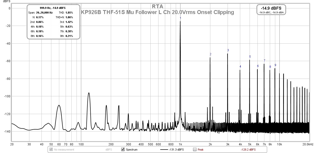

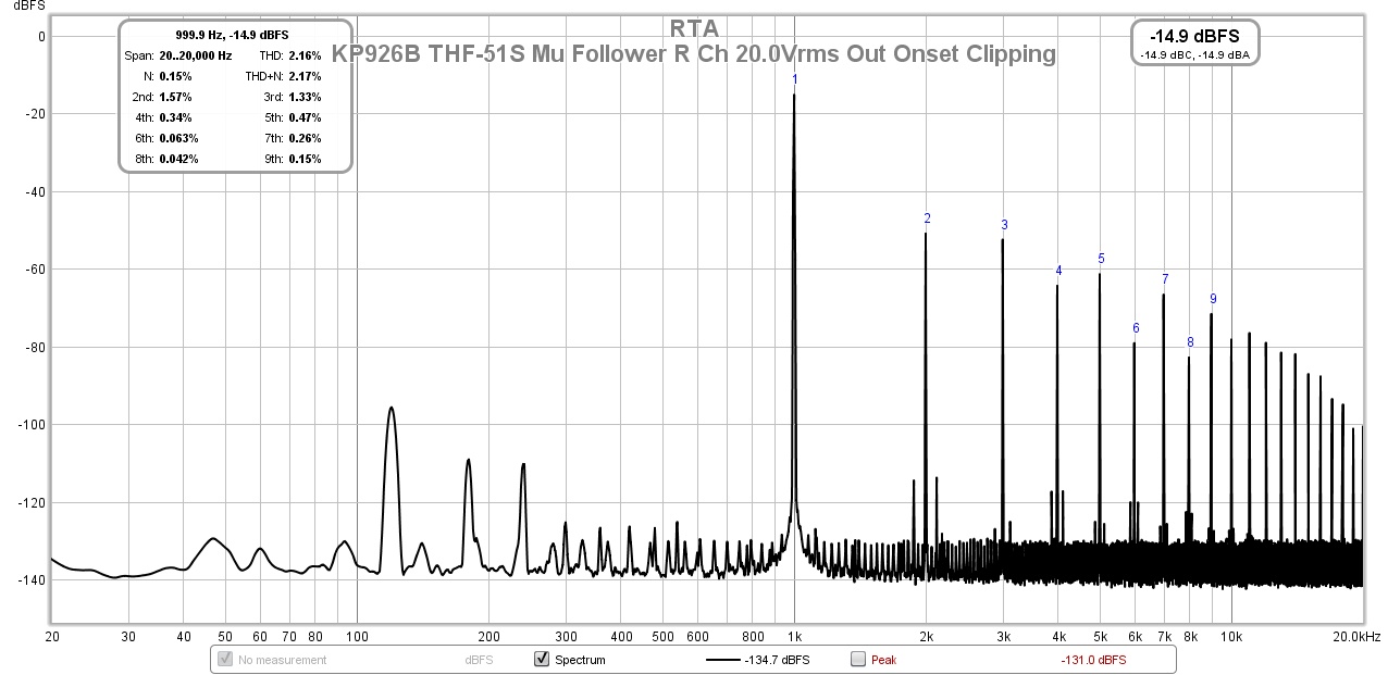

Mu follower common drain THF-51S at onset of clipping (50W into 8 Ohm), left and right channels. Two percent THD is quite good and probably no worse than VFETs, except VFET can't output 50W.

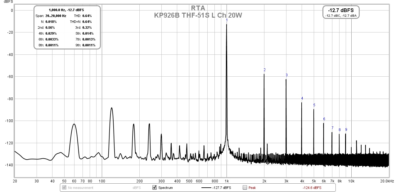

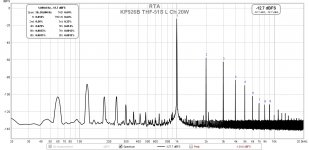

20W added.

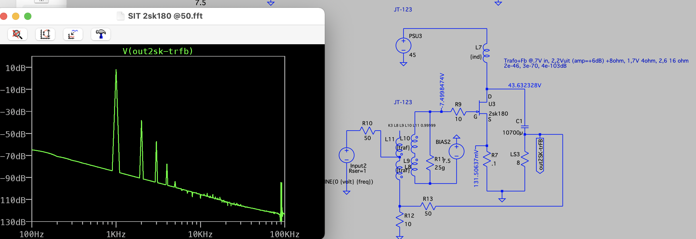

here my experimental set for the source followers
Various feedback, also the famous F6-style feedback.
The transformer is modelled so-so, could be improved
Thanks for the experimental set, but there is a problem with loading.
I replaced the missing symbol with an 'njf' and set the prefix to 'X'. Now everything is OK.
