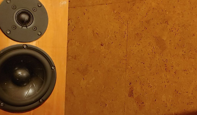

While they last...
You can probably build some nice diffusers to hang on the wall if the corks are cut in different/random lengths?
Yes You are right :magnet:
Recycle cork organic material to make fabulous speakers boxes and room acoustic adjustements make sense in Hi-Fi

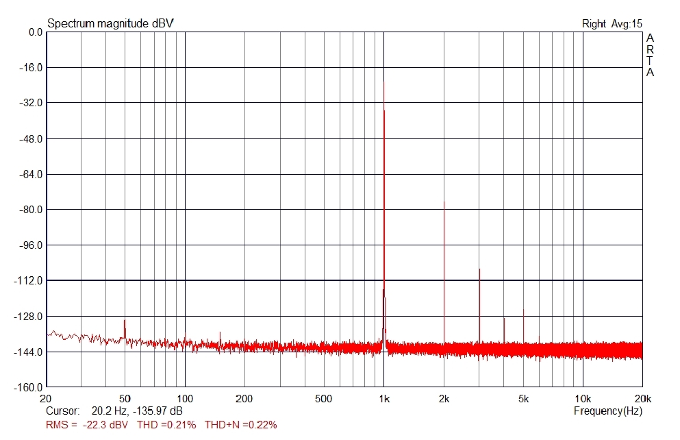

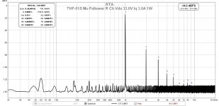

There is no need to complicate the circuit. This is the Harmonic distortion measurements of a Fokin (THF-51S) with a PSU of only 24 V, 2.6 A and Vout = 2.82 Vrms. The Bias can be adjusted to lower the THD. However a clearly predominant second Harmonic is lost. If it has to look like an 845.... 2-jpg bis.jpg

I agree with Claudio. In single ended follower mode the Tokins' distortions are more than acceptable to me, with second harmonic dominant. More importantly, they sound lovely.

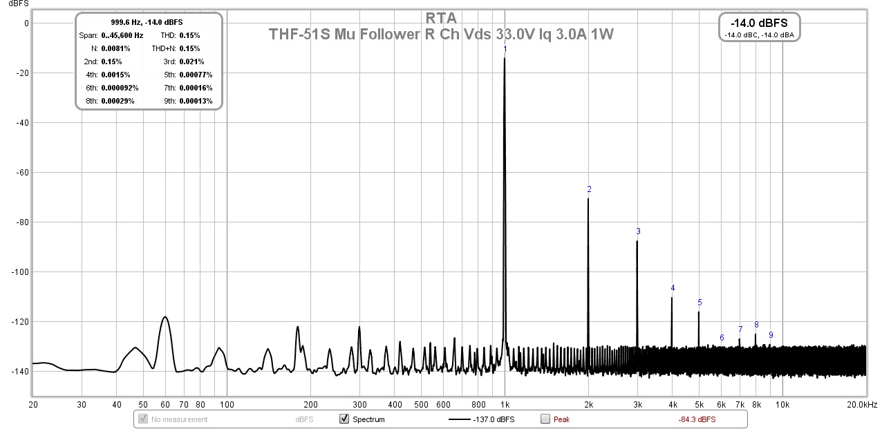

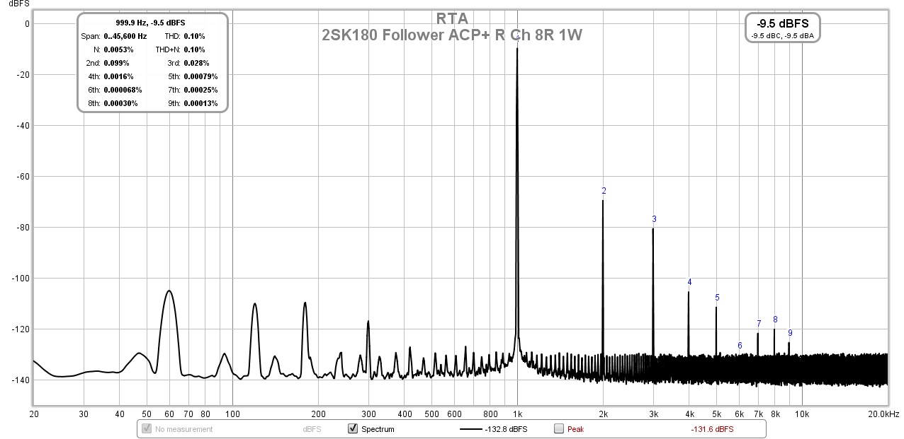

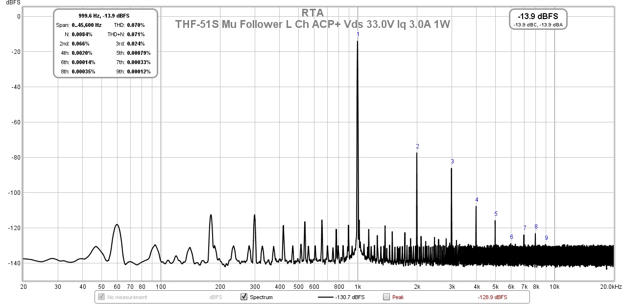

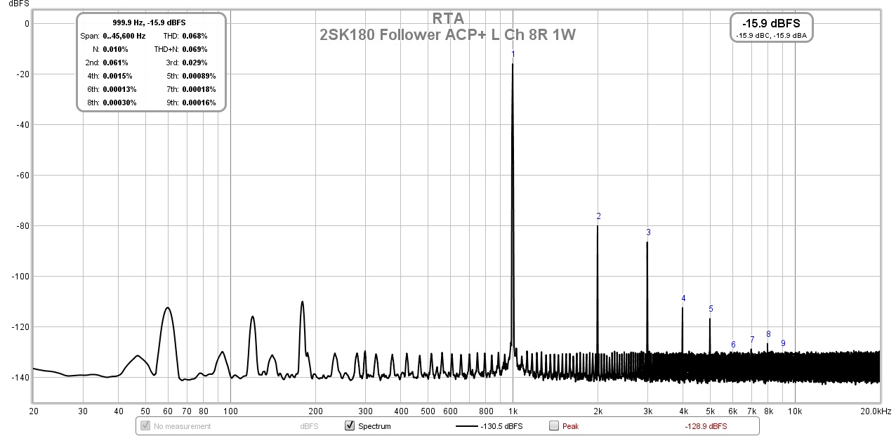

Here are 1W output into 8 Ohms of my Tokin follower amps. The first two are left and right channels of Hammond 193V loaded 2SK180 follower, Vds 35V Iq 2.5A. The last two are left and right channels of Mu follower common drain THF-51S, Vds 33V Iq 3.0A.
Joined 2012
The Tokins as well as the Sony VFETs in common source mode have much higher distortion, similar to single ended triodes. I have had Tokins and VFETs in common source mode previously, but as soon as I heard them in common drain mode, I was won over. Definitely common drain sounded better to me.
