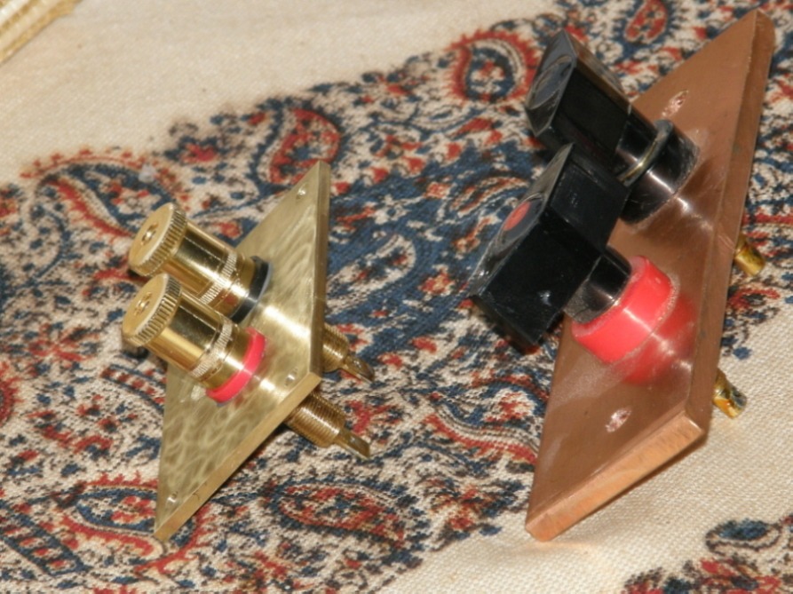

Yes, it depends on your needs/preference. I had enough out of trying to tighten just right, the usual connectors and ended up with the ones on the right. I mounted these on thick copper plates (because I had them), and haven't looked back. Obviously not the choice for an amp, but fine with speakers.

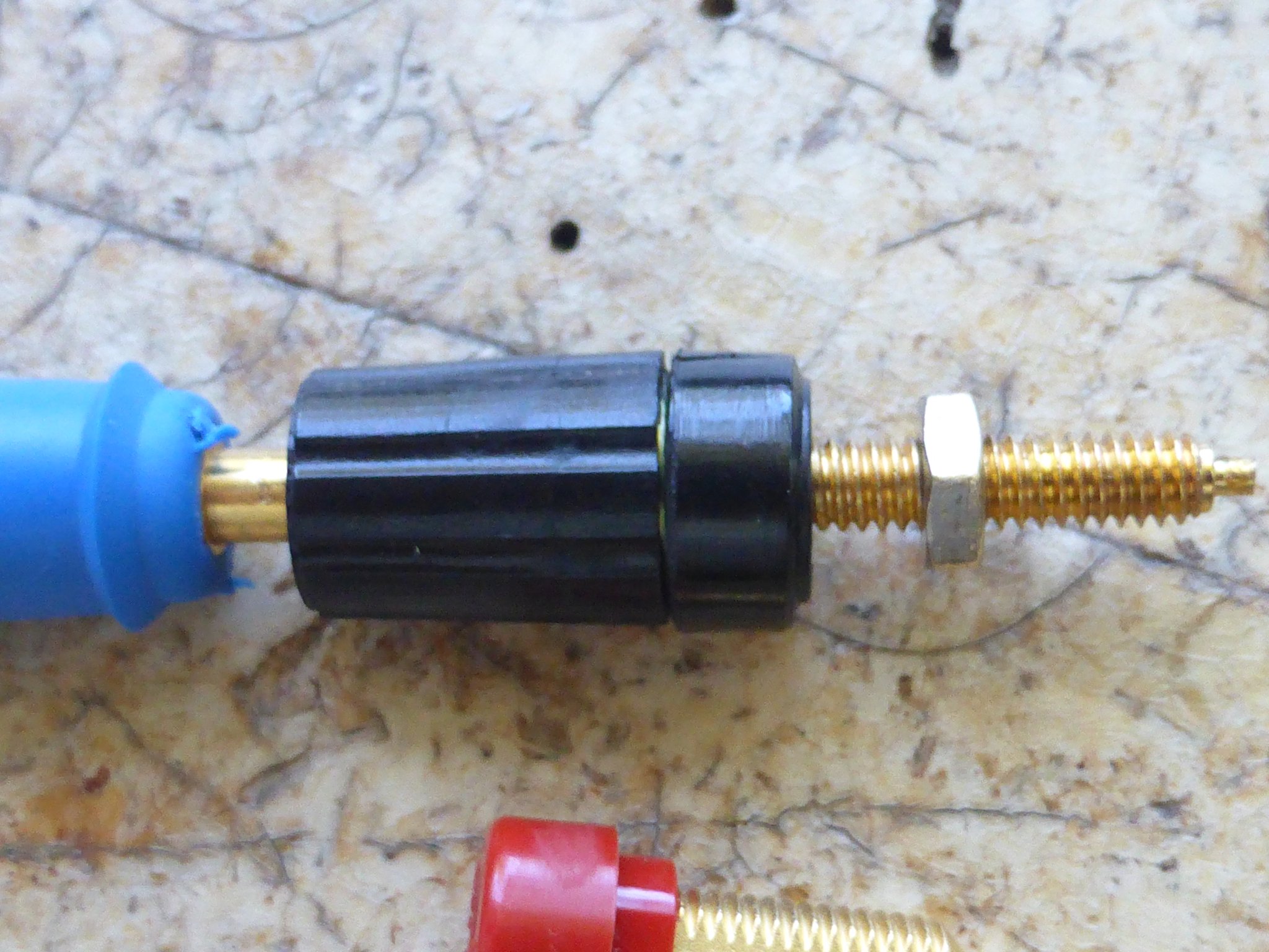

Ive used Mueller Electric binding posts from Element14 (other places Mouser Digikey stock them also). I would go with the Pomona instead with mine the plastic has broken gold worn off, to what appears Nickel or Tin, however when cut one, it does have a copper look. (black terminal in photo)

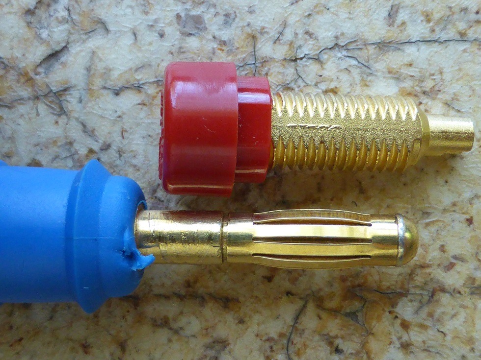

HIrshmann are gold plated brass and very small, and quite cheap at the moment, They are banana plug only, so not for bare wire
The only Mueller binding post, not broken, though gold has still gone on the inside where the banana plugs insert
The small Hirshmann, and Hirshmann banana plug with BE spring and rest brass gold plated, I thought the close connection between the banana and where the wire is soldered was a good point, but i guess they are still not low mass

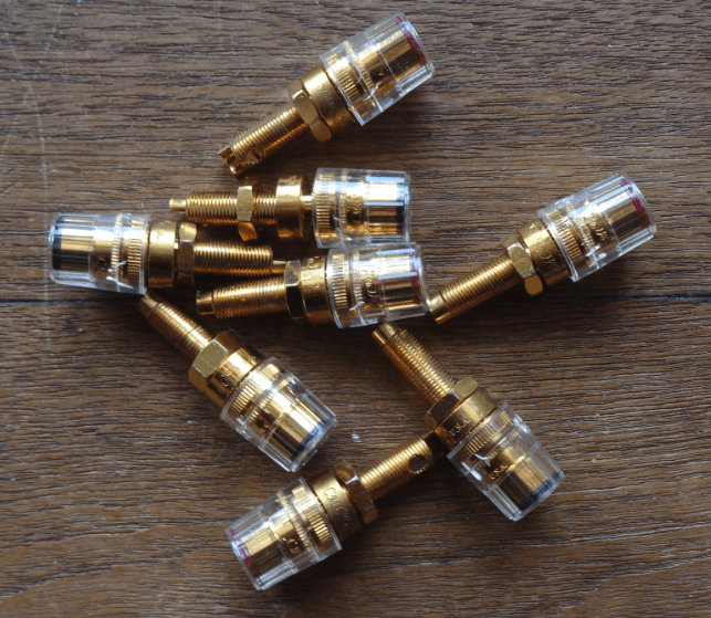

I've always liked these very rugged, but not cheap, Superior Electric 5 way binding posts.
Ok, you got me when I spied the metal set at the bottom. I like things such as connectors to be heavy duty and these look be just that. Funny sometimes how hard you have to look to find something that you really like.
Superior Electric posts are the heaviest duty ones I know about.
The Lexan won't break easily, even with a wrench.
And they have an anti-rotation mounting feature, which is really necessary when cranking on them.

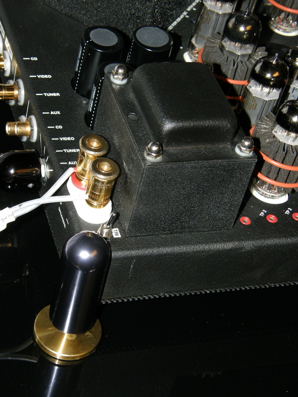

You know, the Manley Stingray that I bought earlier this year has binding posts that I really don't like. I looked at what it would take to change them out, and in a rare case for me, I put the cover right back on. On later models the problem was lessoned by the placement of the binding posts. As many times as I connect and reconnect equipment, I am starting to like the idea of the 'right' banana plugs. The other idea that I have is to make a sort of friction wrench for these, as you can't get your fingers in there very well at all to tighten them.

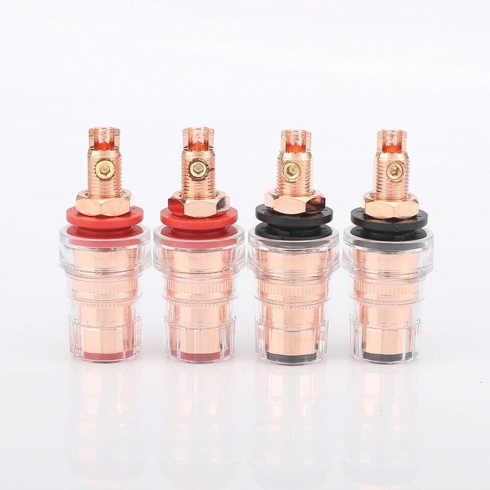

Are those 100% non-magnetic? Source/details? Thanks!typical brass covered steel
"typical brass plated steel" would be magnetic, yes. He was referring those as being the ones replaced. The new binding posts are solid copper as stated in the post, but no source was given.
I think they are referred to these onesThe new binding posts are solid copper as stated in the post, but no source was given.
https://www.bxemall.com/?aid=307663
https://www.ebay.com/itm/203863876133
although I can't believe that at that price they are really 99,998% (!) copper...
However, I preferred these CMC USA (which look almost identical) ones
https://www.hificollective.co.uk/in...8mu-gold-plated-medium-speaker-terminals.html
that I own and which are more honestly declared as "high copper content brass" and that are really excellent to my ears.

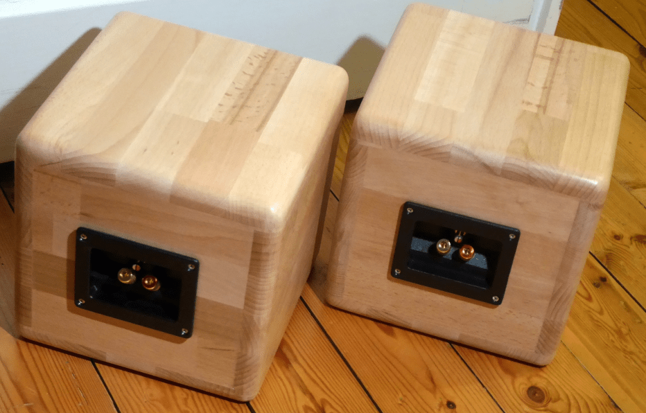

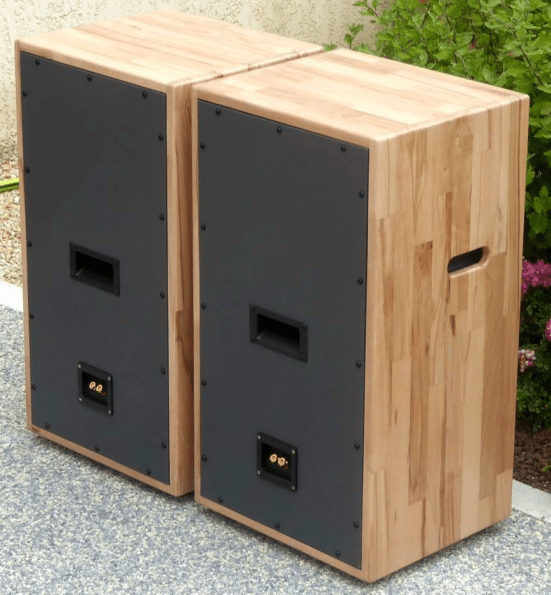

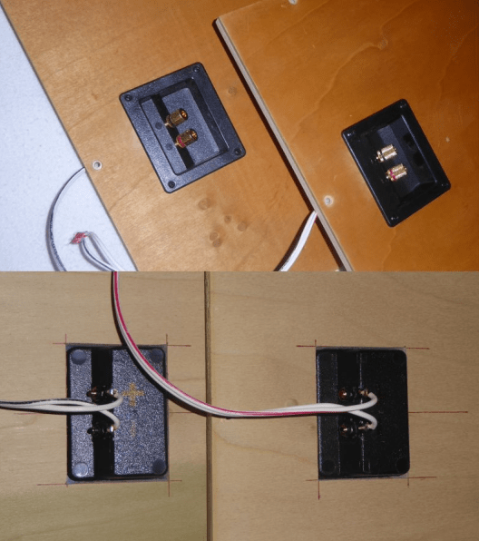

I use this very common type of terminal plate / receptacle :
I found them practical to install and they are not protruding, so protected...
