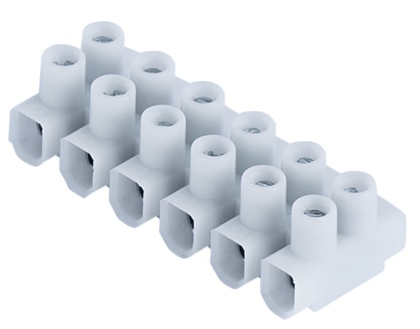

For prototyping:
Quick, easy, handles more power then most connectors of same size/useability.
Does not vibrate loose. No screw to mar multi core wires. Secure clamping from 0,25mm up to 4mm2 or 6mm2 fx, regardless of the size of each wire.
Can even put in a gel box for waterproofing. Din rail mounts available etc.
Very simple to use, remove insulation to ca. correct length, insert wire,close clamp, even see through to check everythings okay. No need for ferrules on multi core, adviceable for 0,25mm2 as it will increase the wires mechanical strength.
Cheap, and comes with 2, 3 , 5 holes.

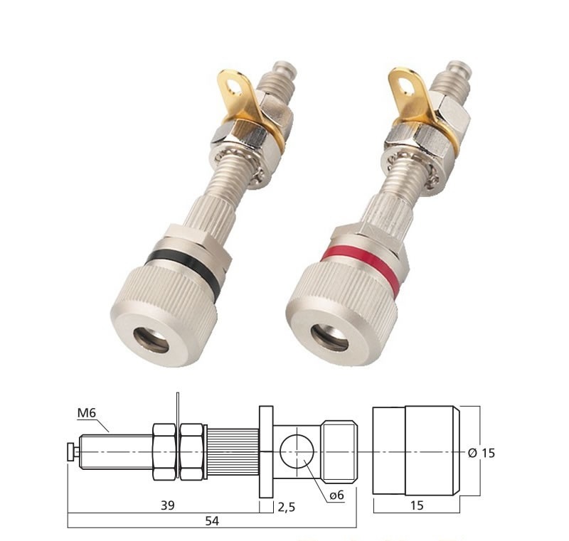

When building my own equipment it is really nice being able to choose a connector that you like. Since I tend to use bare wire, and also have a touch for the tightness that it should have (not crushing it so tight as to cause breaks in stranded wire), then a study brass post does the job for me. Yup, usually change them out if I am to sell the equipment to someone who wouldn't appreciate them.
In a few cases, I have found strong well built spring loaded connectors that can be good as well, but you have to really investigate the connector so you don't end up with a low quality type.
