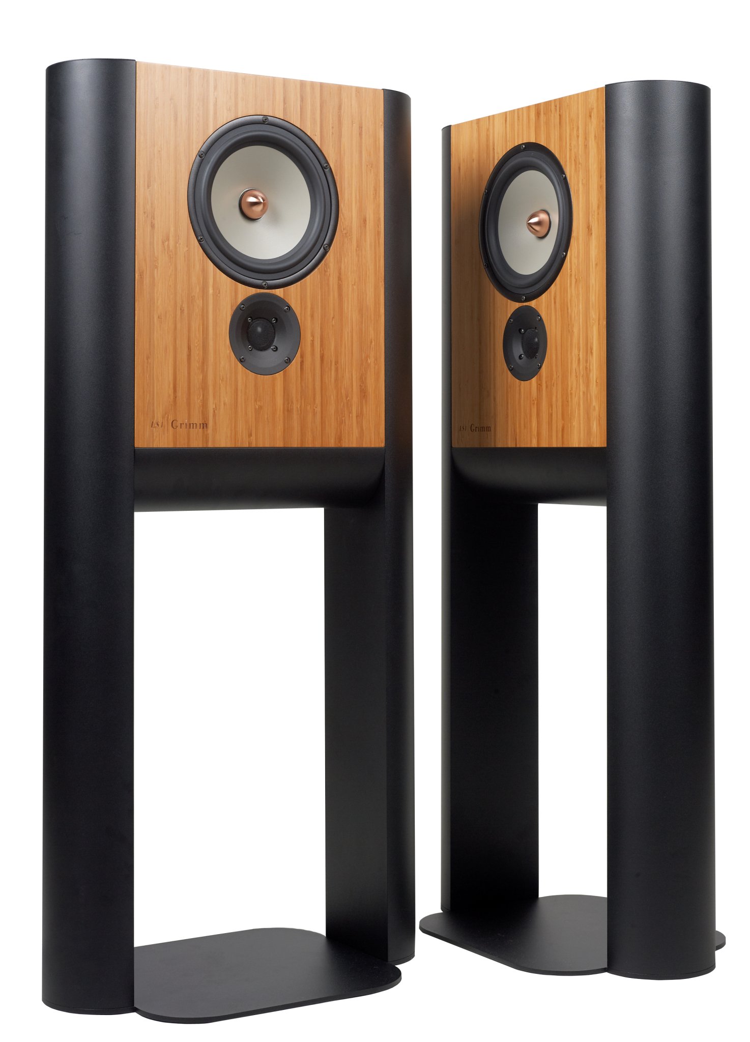

looks like too many edges nearby please try to find a better setup!
With nearfield setup we stumble directly into the next problem : The other channel speaker/cabinet edge(vertical) creates a strong dominating reflection! (rounded cab edges even worse)

Given the design of this loudspeakers i'm not surprised it makes some changes. Maybe you should try same thing on your three ways too? Could even be asymmetrical ( larger radius at side closest to drivers).
How did you assess the results? In stereo? Try it with only one loudspeaker and with mono source if possible, it's revealing too.
Hi, here is one way how to visualize the sounds from edge diffraction. http://legacy.spa.aalto.fi/demos/diffr-visual/And what in terms of the whole cabinet? The thread is about the cabinet, not the baffle only. You would object that the baffle is where 'the sound leaves the speaker' so the game is there, but it isn't. The cabinet reflects ( and diffracts and refracts) the sound that bounces from all over so it become a ghost source, or better, many sources. How would you compute that ?
Yeah the whole structure affects, it gets complicated quickly. Luckily level gets down rather quick, for example if a box was one foot deep sound to back edge and back towards listening position is two foot roundtrip, 2ms, floor reflection could arrive earlier I think. Effect towards listening axis seems to be much less in amplitude than what front edge does. Effects of back edge sound source seem to be mostly toward off-axis and sound going all around would add it's thing, peculiar looking "ridge" in a polar graph. There is an effect but the front edge seems to be more important as it makes frequency response vary inside listening window. Still, not sure how audible this is, I have not done listening comparison like that, perhaps I should.

If you look at the old measurements Olson did on cones, you instantly know a teardrop shape isn’t that optimal. Of course aesthetics play a role too, but any ‘point or corner’ shape causes sharp diffraction and DI anomalies on a broad spectrum. The polar pattern isn’t per se bad, but it won’t be uniform in all directions. Should be basic knowledge to anyone designing enclosures.
Yes - I agree. The shape of the cabinet on the sides and back DOES have some effect on the diffraction signature, but complicated-to-build teardrop shape is not necessary. Other shapes can achieve the same effect with less complexity. The teardrop shape looks really cool, however.The teardrop is something chosen to facilitate laminar flow, such as that over a vehicle. A sound wave travelling normal to the surface is a different thing.
