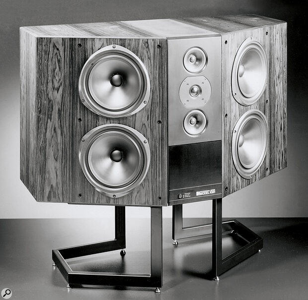

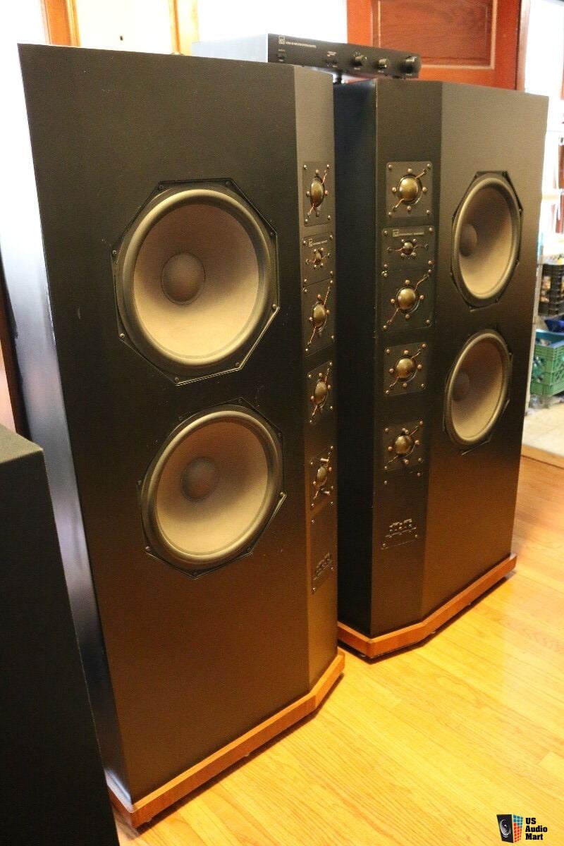

To my knowledge, the narrower baffle will provide a better image of sound. However, there are some designs that are likely to be considered narrow baffles, despite the full-sized enclosures. For example, the old ADS speakers model LXX30 series; here I'll use the L1530 as an example.
As can be seen, the midrange and tweeter of the L1530s are mounted on a small baffle located at the edge of the cabinet.
I'd like to compare the cabinet shapes of the L1530 and L1590, as depicted in the attached.
1) IF EVERYTHING, including the drivers and crossovers, is the same, which model will give a better image of sound?
2) In my view, the L1590s perhaps give a better image, but how about if we change the L1530 to the flagship L2030? The L2030 has four midranges installed in a vertical array. Hence, could it compensate for the destroyed image and result in a better image than the L1590?

Diffraction off the edge of an enclosure creates a secondary wavefront, similar to the initial wavefront, but delayed and filtered. (Because the edges are a few centimeters from where the drivers are.)
Small baffles reduce that time delay, causing it to be perceived as (closer) to the initial wavefront
Big baffles increase the delay to a point where it may not be perceived as part of the initial wavefront
With a big enough roundover, I've heard big baffled speakers that sound like they're much smaller than they physically are. In cases like this, it helps to listen with the lights out, because seeing the speaker will give you cues that define the soundstage.
If you can make the choice extended to the thousand ( of thousands) of different speakers produced in the last 40 years, to limit the research
OH! Acoustic Research! That was often mentioned when studying complex speaker systems!

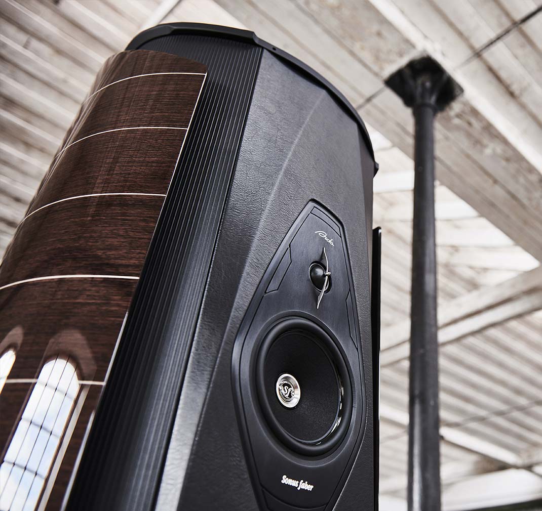

If having round-overs with 10 cm radius (4") on the front plate, I wondered if the external shape of tear dropes going to the back, gave a better imaging than the sides walls staying parrallel (but still with the same roundovers at the front as at the back of the cabinet ?
Any thougth ?
I know tear drop shape (B&W flagships for illustration) is one of the best to figth a little the baffle step (see Dickason book), but is it really better when having big radius like 10 cm already, so a smmoth transition already (talking about >300 hz).
I am not asking about internal volume but external shape about difraction behavior only, for instance see Sonus Faber Aida where the sides have such recess from the front to the back, even so the side are not touching the front baffle because there are vents (à la Onken) between the front plate and the rib sides : see picture.
Really wonder if those external ribs play a role due to their shape or are just here to suit for aesthic the core cabinet shape made for internal purpose only -internals modes )?
Seem constrained ply with a veener, what about vibrations, does they have a chance to sing ? I see the latteral vents as a big difraction behavior

At least in my case the ribs should be here just to smooth difraction if I decide to use them as the internal volume and front plate need only 16 cm width at minima if a square.
So with external ribs I found they add 10 cm on each side. So 36 cm not flat vs 15 cm flat for the mid cabinet... Bass to mid bass stay 36 to 38 cm width cause 12" driver.
If the ribs touch the front plate then the larger width migth reduce a little the baffle step or at least makes it bandwidth happens lower in frequency

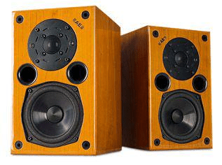

The best imaging speakers I've ever heard (like freaky big and wide soundstage) were the original Acoustic Energy AE1s, but I'm still not convinced it's only because of their small size.
The source, pre-amp and amp have a bearing, too.
Reactions: ScottG
How far away were you listening? acoustics of the room, and listening distance and positioning make huge difference. Perhaps amplifier does too, but I suspect differences with modern electronics spatially are only audible if you are closer than the audible critical distance. Or, if there is something terribly wrong. Perhaps the speakers have tighter tolerance between their frequency responses than some other specimen you compare to?
Multiple things all interplaying, like with everything else loudspeakers 🙂
It was just a demo in a hifi store listening room, so-so room treatment, about 2.5m listening distance, on nothing special Target stands. Source was I think an AVI Laboratory cd player and amp was the old style ATC SIA2-150 (class A preamp and class AB power stage). The ATC amp also gave a massive soundstage to some Dynaudio Audience speakers that I also auditioned. When the amp was changed between an Arcam and a Naim and a Primare, the soundstage shrunk noticeably, so this all amps (should) sound the same is bullcrap.
Reactions: ScottG
Was the imaging accurate in the sense of what was in the recording or was it enhanced? Small speakers with flat baffles and sharp edges are going to have significant diffraction off the close edges and so cannot be expected to image accurately. However they do seem to push the imaging about significantly. A look at a typical HRTF and how the edge diffraction is likely to modify it may be of relevance.
