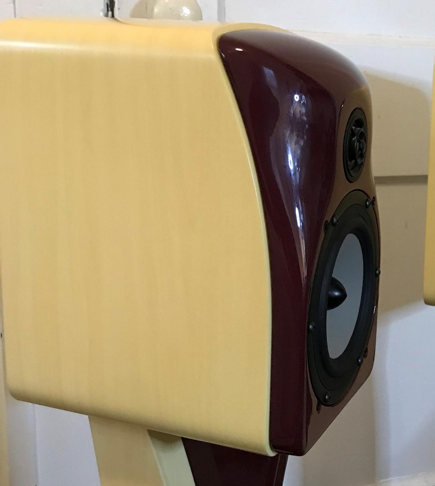

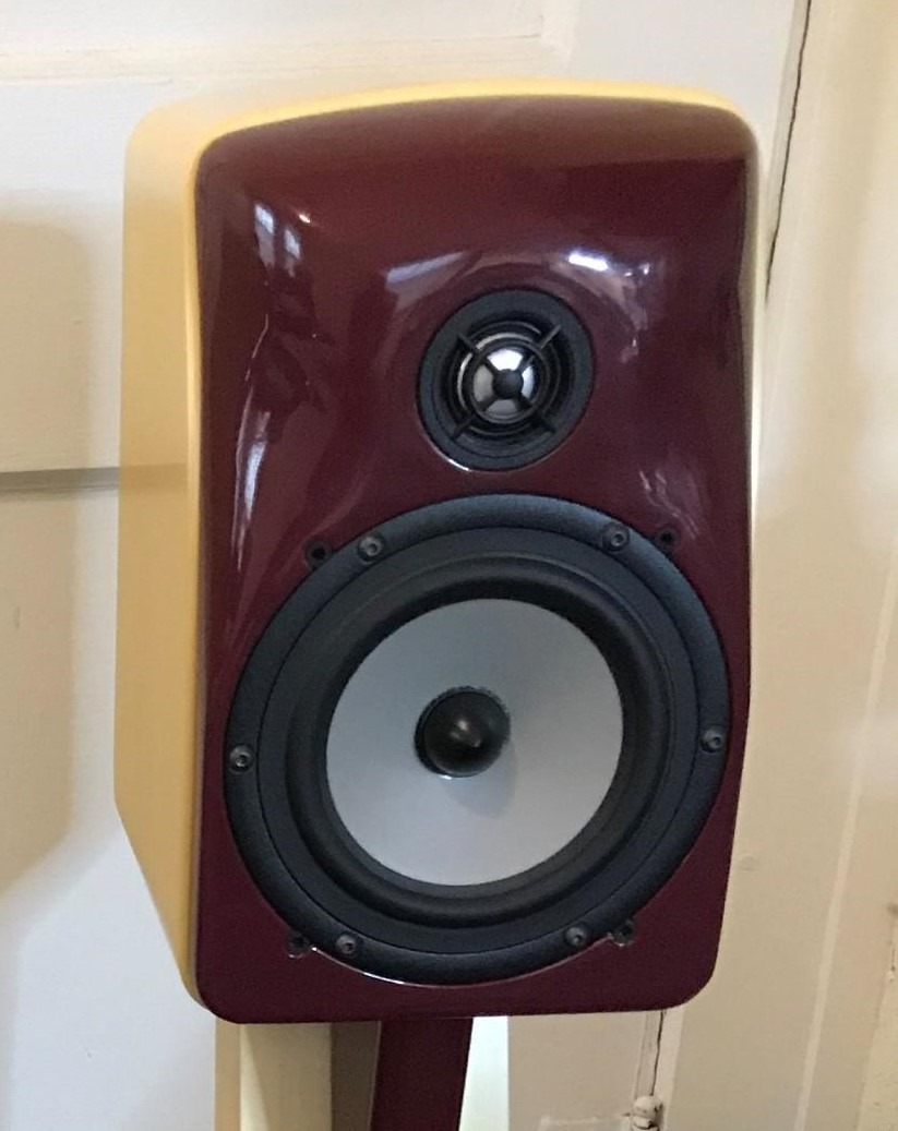

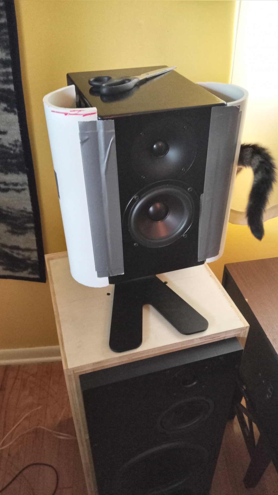

Thread got me trying some thing with materials left over. I call these the Grub LS-420/69.
- Which shape of cabinet gives a better image?
