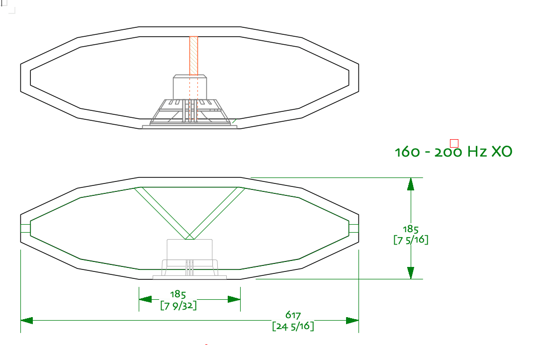

I wondered if the external shape of tear dropes going to the back
Start slow and increase curvature as you reach the edge.
One of my designs took that to extremes in the ones in post #5.
A chamfer will give a more effective radius on a typicl box, and they started out with a 0° > 30° > 45° before it folded back to the sides.

The easiest way to weed out speakers which produce an unnaturally big false acoustic image is by playing a mono recording of acoustic music. If the image is free of most reflected and diffracted artifacts, the music will come from dead center between the speakers as it should. If the recording sounds like its stereo and the image extends widely, the reflected and diffracted components are the main contributors in creating the false illusion of stereo.
The poor man's strad is a great design. It addresses most issues with large baffle designs and actually performs better than many narrow baffled speakers in terms of holographic imaging and a solidly centered phantom mono image.Start slow and increase curvature as you reach the edge.

Rightly or wrongly, I've assumed that the > 12 deg included angle for 'slap' echo/RFZ is sufficient for vehicle truncated aero pods. Ditto, walls, floor, ceiling of custom HTs.Any thougth ?

Yes.I owned two very similar speakers-Yamaha NS 1000 and Yamaha NS75T.The baffle,box dimensions,shape and driver type and location are almost identical.The NS1000 has a slightly bigger dome midrange but other than that they look almost identical Both have square baffle edges.
The NS75T images really well but the NS1000 has quite poor imaging.
It would be easy to hear the NS1000 and blame the wide baffle and square baffle edges for the poor imaging but clearly that is not the problem.
I believe wide baffles have been wrongly blamed for poor imaging.Association is not cause..

I think edge diffraction is kind of an important thing here. I'm dealing with a speaker atm that is leaving me disappointed and it has hard edges on the baffle. I swear if I'm in the right spot near them, I can hear the edge that is closer to the driver as a secondary sound source. So it's probably best to minimize diffraction, probably a reason for a lot of high performance speakers pursue fixing that problem.

So my belief right is now that having smooth dispersion and minimal diffraction effects are the key to great imaging and sound stage.
I also think there needs to be some talk on what a wide baffle is. Seems it's mostly anything wider than your typical 7-8" bookshelf speaker baffle. I'd argue it should be defined as narrow, medium, and wide, or something of the like. I think speakers in the medium width baffle area the least forgiving reguiring hefty round overs.

Seems like no baffle is a cost effective way to get good results.

Except the no baffle tweeter is then going to be placed near the midrange with it's cabinet and edges.Seems like no baffle is a cost effective way to get good results.
Put the midrange without any baffle. Put lots of felt in behind ( and around: you don't want no cardiod nor dipolar emission)
