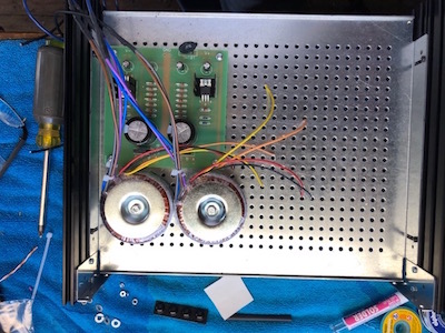

As eager as I am to get started wiring it up, I thought I'd pause and get some thoughts from more experienced hands. This is a "by the book" ZBLS, so pots on the inputs and outputs as well as trimpots on the circuit PCB. One XRL/one RCA out, two XRLs/two RCAs in, so four inputs total. I've arranged the power supply, including the IEC, fuse, and on/off switch, on one side. The signal inputs will be on the opposite side with the circuit PCB, select switch and input pots. The output pots will go about in the middle in the back.
I was going to run my power wiring along the left chassis wall. What's a good awg for the power switch. How about gauge for the IEC connections and especially chassis ground? Finally, from the power supply PCB to the circuit PCB?
I was going to run the input signal wires along the right side. I thought I'd use 24awg wire from a CAT5 cable for signals, a la 6L6's recommendation. Is that a single 24awg wire or a twisted pair as in the CAT5? Finally, gauge from the circuit PCB to the outputs?
I may be making harder than it is, but I haven't found an overview of preamp wiring anywhere. If you know of what please let me know. Thanks.
Jim

I used 18 AWG for all 110v wiring. I also used the same for the 60vdc rails including two 4 foot umbilical cables which run from the power supply to the Line Stage. I've used the same wire size for tube phono section wiring, once again with a remote power supply and umbilical cable.
Don't forget to find the Hot side of 110v, which is the larger pin on the 110v outlet. The Hot side must go to the fuse and switch for proper protection.
For the RCA inputs, I'm using two wire coax with a shield. The shield and ground wire for the RCA go together at the INPUTS only. The other end the shield is not used. For the RCA's in parallel with the XLR, simple 24 AWG from the XLR to the RCA works fine.
For the XLR inputs I'm using three wire coax with a shield, once again the shield and ground wires go together at the INPUTS only. The other end the shield is not used.
