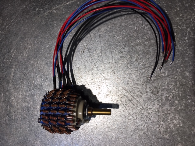

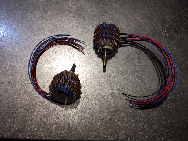

Here is what I'm using, one is 10K and the other is a 5K ohm 24 step pot. The red wires are input, which will connect to the output of the input selector switch. The blue wires are the output which will connect to the PC board L+, L-, R+, R-. The black wires are a shielded ground.

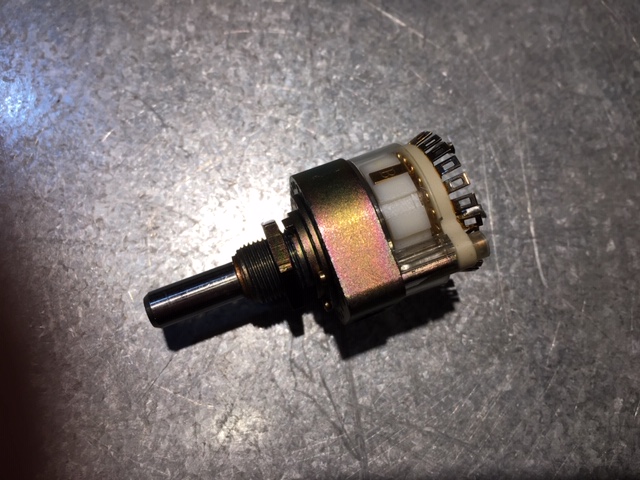

The selector switch is a DACT CT-3/3,4,5 which is adjustable for 3 - 5 positions depending on where the stop pin is placed. I have it at 4 since I only need four inputs. The website has drawings of how to wire the selector switch for balanced and/or single ended. Google DACT, beware these are very pricey, I had one from when I was building a EL-34 tube amp. I ended up using only two inputs so I used a DPDT toggle switch instead.

The one that Dennis Hui sent the link for is half the price of what I paid for each pot. Like I said, the 5K pot was custom made since i couldn't find one anywhere with four poles for balanced mode. I don't care about balance, if you are, then look for 2 10K dual pots, one for each channel. Since the 5K controls "gain" quality(?) I'm using a four gang pot.
Don't forget that no matter which pot you use, there is a resistor in series shown on the schematic that is not on the PC board as they go before P1 - P2 and again on P3 - P4.

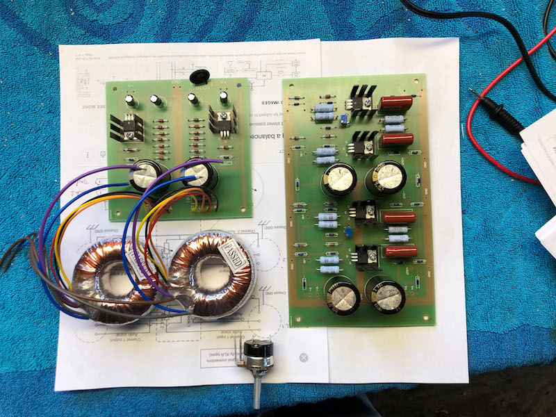

So I've got all my major components and now looking for a chassis. I laid the two PCBs for my ZBLS plus the two transformers and here's what it looks like on paper that measures the inside dimensions of diyAudio Store's Galaxy case. (That's not my pot, just a piece i had for scale.) That looks like enough space to me. Is it? I'll be using two input pots on the front, plus a power switch and a select switch.
Also, my tallest component is just under 2 inches. I planned to use 10 mm standoffs, so with the PCB that gets me up to maybe 65mm. The 2U Galaxy is 80 mm inside height. Is that enough clearance? Do steel vs. aluminum covers make any difference? Any advice appreciated. Thanks.

The case I'm using is only 70mm tall, so you should be good. I keep reading about how much heat the line stage makes, so I have a vented top cover to allow air flow and heat dissipation. I'm also using the silicone heat transfer paste between the MOSFETS and the heat sink, just a dab.

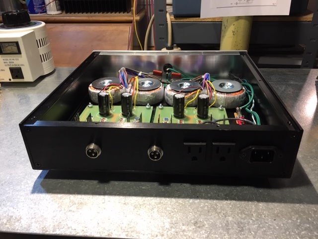

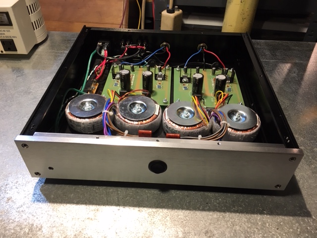

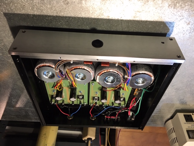

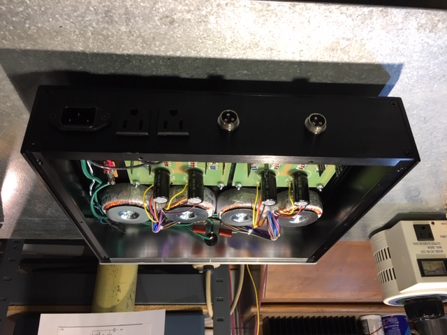

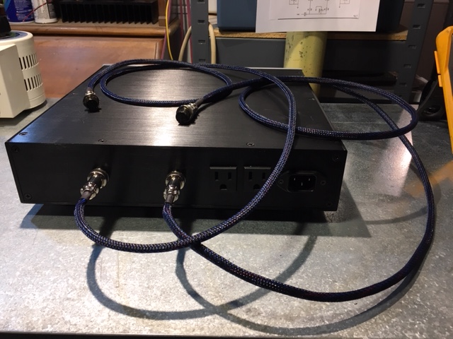

Here is my completed power supply for BZLS. I added a pair of 110vac outlets which are switched by the front panel switch (left over from my ACA kits), One outlet is for the power strip for the ACA power supply's. The other is for a second power strip for my Wadia 170, Music Hall 25.3 DAC, Marantz 110 tuner and a Denon CD player/transport.

No, they are 3 pin microphone connectors, identical to Radio Shack 4 pin microphone connectors. They use a 5/8" hole in the rear panel, and then have a slot in the plastic which aligns with a pin in the chassis connector so they only fit together one way.
