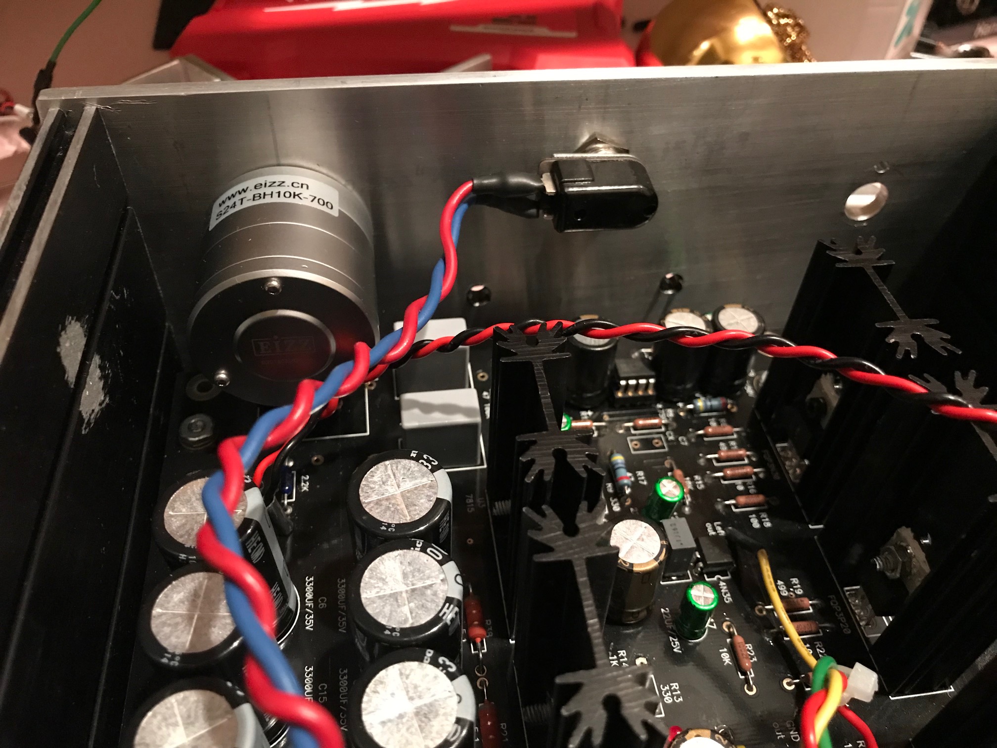

What have you used for volume control? Is an ALPS pot good, or should I look at theattenuators with resistors. I’m a little intimidated by the tight work on the attenuators.
I'm no expert on parts as far as good or bad. I'm following the article by N. Pass, he said four ganged pots using resistors was his recommendation. So, I found a company in China (along1986090) on Ebay, he sells four ganged 24 step pots with Vishay Dale resistors. I found a 10K and then asked him to make a 5k. It took about 2 weeks max to receive even the custom made one. I had no intention of trying to solder all those resistors on a diy version. Life is to short for some projects, like making my own PC boards. I've used enough bad chemicals for 46 years building cars.
He also sells enclosures which I've used for other projects. Now that I see diyAUDIO store has enclosures, I will probably buy them from them in the future.
Other parts such as connectors I bought from Parts Express in Ohio.
Attenuator option
I used an EIZZ 24 step attenuator on a WHAMMY based preamp. It cost about $60 USD with shipping. I have no comparison for the sound, but the EIZZ attenuator is smooth in operation, with no pops. It has nice large posts for soldering your wiring. The aluminum body can be grounded providing some sheilding.
Prior to that I tried one of the cheap Valab attenuators (about $20 USD), the wiring is tricky because the hookup tabs are tiny. One of the tiny surface mount resistors broke off. I just couldnt deal with the surface mount soldering so decided it was a paperweight. Also in the part of the range that did work it had small pops when it was turned. Would not recommend the cheap ones over the ALPS. After I discovered the broken resistor I decided to spring for the EIZZ attenuator.
Next time I need to use a volume control I'll probably just use the ALPs pot.
