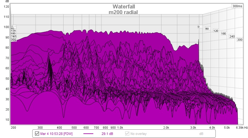

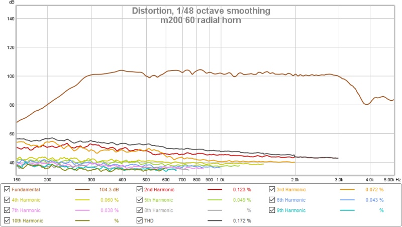

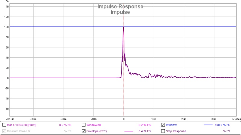

This was M200 measured last night in the JBL 2386 - it goes to 300 flat in my 180 flare round tractrix -
Apparently a picture or link didn't make it through?

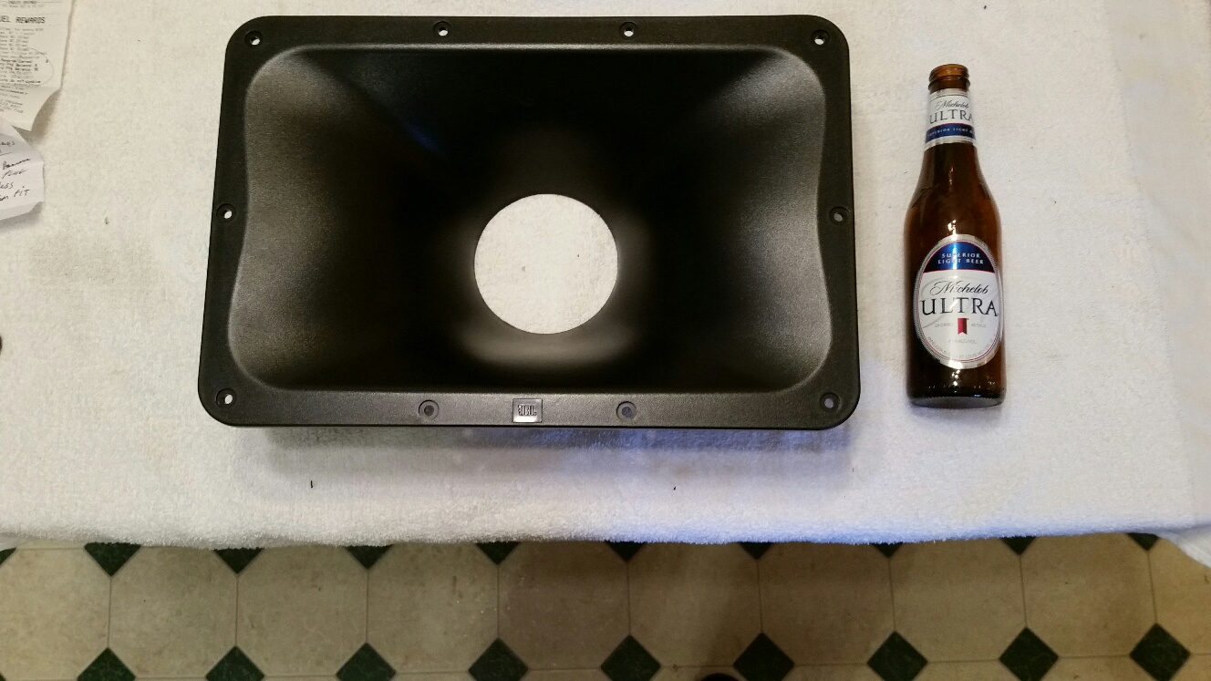

I knew what Earl.K. was talking about, but there is NO WAY I can remember which thread I first learned about the JBL mid range horns. But I did purchase a pair from Jack's Music Factory. They are now sold out.

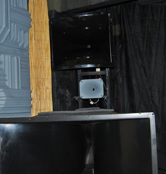

I always use a familiar object for a size comparison.

This shows the bandwith is quite limited with the CMCD, the 8" version is just as bad
I'd like to see the distortion along with the SPL - too bad I no longer have the drivers or I'd run that. My old measurements are gone with my old laptop
EDIT - I see it is the CMCD-82, not the CMCD-81 I had. I wonder what the difference is?

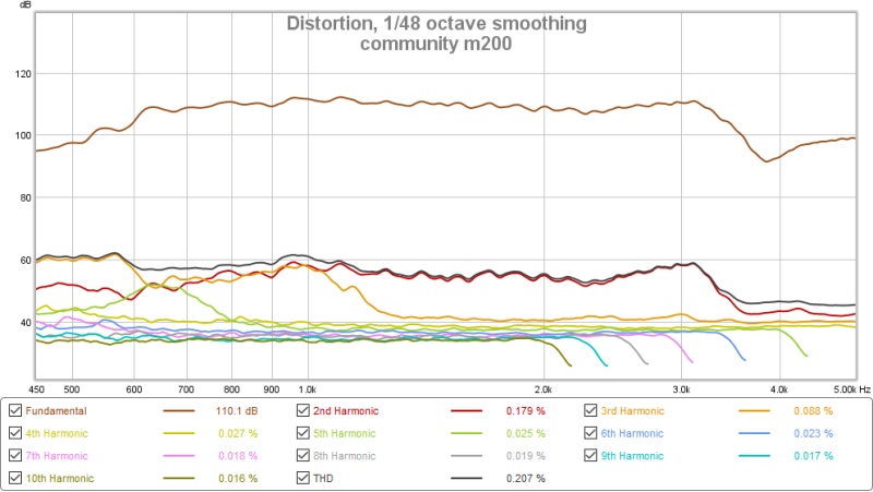

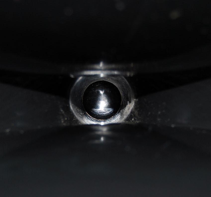

This is the m200 compression driver - nice driver/horn combo - even if the throat is mismatched lol - throat is 1.5 exit of m200 2inch
Is the horn used here the Community RH-60?
looks too good to be non eq´d
That's right, it's a low compression compression driver midrange. 🙂
No eq needed in this horn, horn is around 28" deep - even flatter ib the JBL 2386 but won't work well below 600-700 hz
