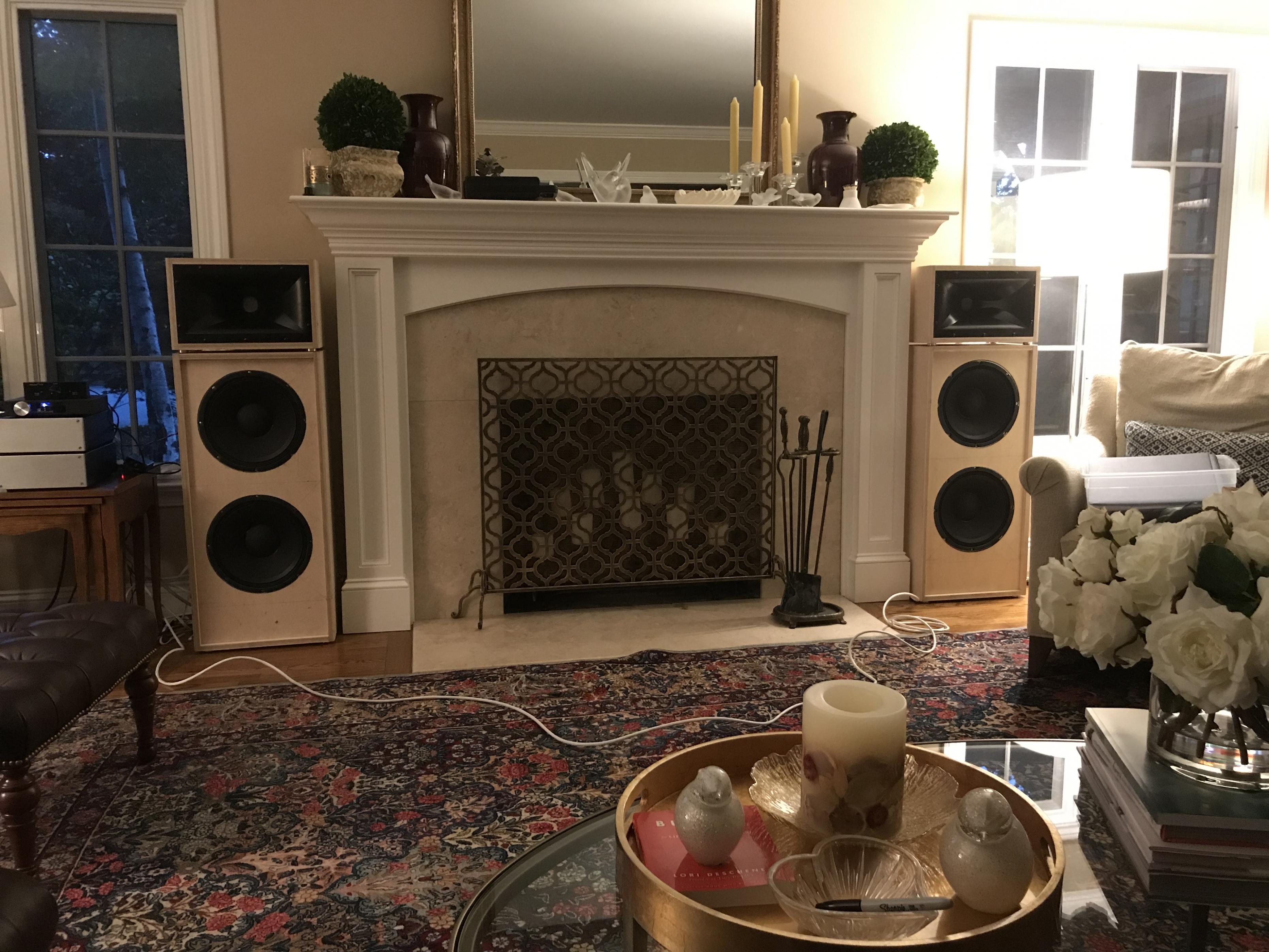

Did you mean K-402? If so do you mind showing measurements where it shows beaming past 10 KHz? It did not sound like it to me and this owner's system was using the cheap Klipsch (not sure if these are B&C or something else) compression drivers and not the TAD 4002 that many are using. All EQ settings from the designer.
edit: the reason I say this, he had a couch and I moved between the three seated positions 🙂

Yeah, IMO fairly normal for controlled directivity. I realized you're Bjorn from the Klipsch forum so you obviously have much more experience with them than my ~ 2 hour audition. To my ears I never felt they needed any assistance up top. I posted some subjective impressions on ASR forum.

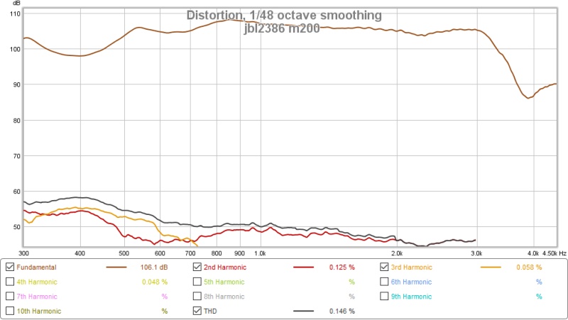

here it is - this is the cleanest horn compression driver combinations i have ever measured. it won't work below 700-800 hz though - as an upper midrange treble horn it is supremo
Thanks for posting this.
So the M200 is indeed a top candidate in my book. Too bad no measurements available for the Seos 24". I have to go with Face's min xo at 450Hz vs 2386 at min 600Hz. Of course your notion of what a min xo point should sound like and his aren't likely the same, but that's what I have to work with now. 600Hz min seems a little too high considering my intention to xo at 2000Hz above.
Nevertheles, a good place to start now.

It will be impossible to find a small horn that will load as well as the jbl 2386. I would consider using the mid 800 to 3k. The tweeter may actually perform better. When I look at the beyma it looks like a tweeter
This is the m200 compression driver - nice driver/horn combo - even if the throat is mismatched lol - throat is 1.5 exit of m200 2inch

I also have Community M200 drivers and 2384 wg and would like to try it. Your diagram shows excellent result.
