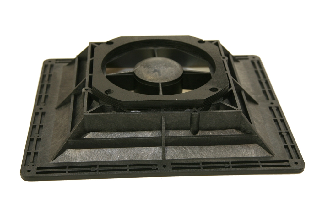

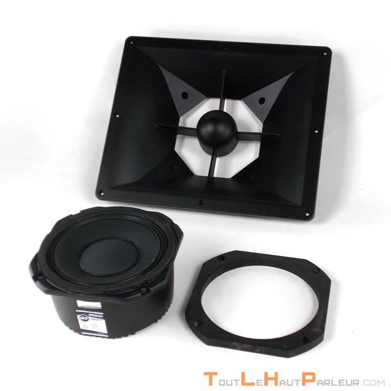

The RCF MR8N301 8" midrange speaker may be yet another option. They are roughly the same thing, and can be bought new from usspeaker or parts express.
With the horn (RCF H6000), it covered 500Hz-3kHz. That horn doesn't seem to be available any more, but maybe that's cos it wasn't very good - it looks fairly basic and was very small (16.18" W x 13.7" H x 3.27" D), so a slightly larger DIY version would probably be an improvement.

Crossed over at about 2000Hz you will also need a phase plug
Some of POOH's examples with small drivers (and no phase plug or rear chamber) look great. I've had less extended but still useful results from cheap drivers. Even a defective driver gave me 103dB
The RCF MR8N301 is an 8" and goes to nearly 3kHz with their very basic looking phase plug (an egg on sticks) - cloning or improving that seems within reach of a decent DIY effort.
Phase Plugs
"One of the simplest phase plug implementations involves increasing the baffle cutout diameter and suspending a conical shaped wooden (or other solid material) plug in the centre [...] I utilised this type of plug in my twin 8" design, and it allowed operation of an 8" speaker up to a crossover point of 2.5kHz"
With a 4th order electronic high pass on a horn that load well to 300 Hz (like in the examples I posted) 125 db output would not be unreasonable with the Faital 5" or B&C 6" drivers. Either driver will have sensitivity over 104 db with 2.83 volts. Both can handle 80 watts or more and without the horn are 99 db sensitive. Just do the math. Neither driver has a problem with output when loaded in a horn.
