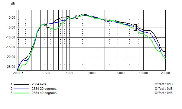

I have measured the 2384 waveguide on and off-axis to confirm the good DI spec for the JBL 4722 system:
The DI increases from 400 Hz up and is pretty linear. It shows the 2384 seamlessly integrates with the bass section. There does not appear to be any measured DI issues or compromises using the 2384 to 630Hz. If there are polar or DI measurements that show otherwise, I would like to see them.

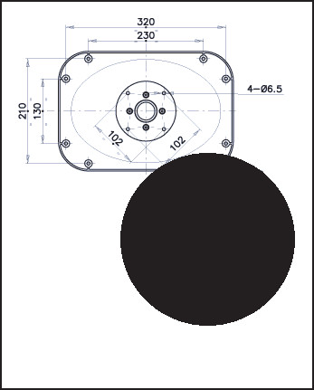

Knock-offs of the horn are available for $30, so cheap experiments ahoy.
(444) 9" x 14"Oval 1.5" or 1 1/2" Bolt-On Horn For Many 1.5" or 1.4" Exit Driver | eBay

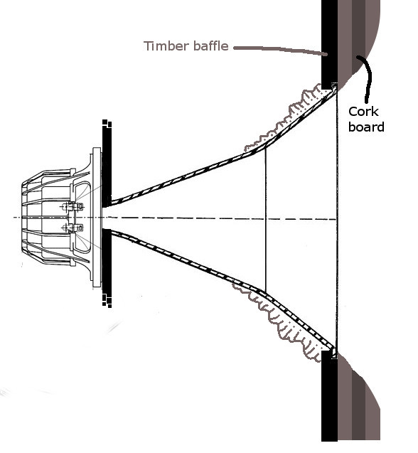

To make a beefy satellite speaker with these, I think I'd:
1) cut an inset, and screw the horn flush to the baffle (with only 7 screws)
2) plaster a litre of liquid nails (or similar) over the rear of the horn, to thicken it and to guarantee an airtight seal with the baffle.
3) Use a router to cut the woofer mounting hole right through the last of the LTH-142 screw holes, as pictured.
The layout would be like a big bookshelf speaker, with c-to-c spacing a lot closer than a 'normal' stacked system (separate horn placed on top of the bass box).

11" x 17" ABS 2" Bolt-On Long Throw Horn 90° x 40° For Many 2" Exit Driver | eBay
I got a pair of these and extended the mouth with a lot of effort (grinding + timber + filler). The result has the mouth size of the SEOS 24, but is about 15cm deeper.
In hindsight, my method was dumb: a lot more work than is needed. If I did it again, I'd just mount the cheap horns onto a baffle, then laminate on a few layers of something soft and easy to cut. A few sheets of cork tile would do the job.
