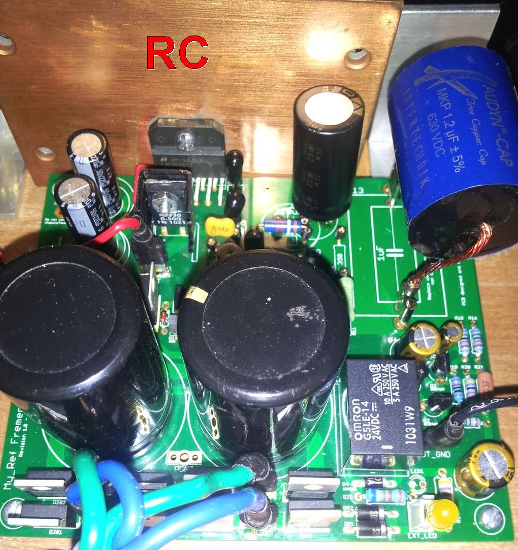

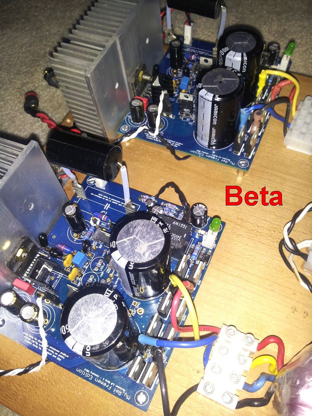

I'm agreeing with madisonears. Here is a link to a subjective live review of the beta version of the MyRef-Fremen Edition vs. a good tube amp.
The FE is now in the release candidate phase and sounding "sweeter" and warmer as it's development progresses.

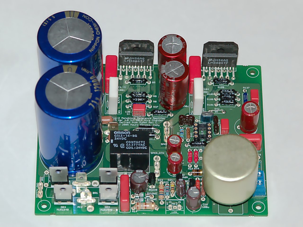

Daniel, Are you referring to something like this?
Hi Bob! Thank you for the updated information.
MyRef X2 Evo-2 (parallel lm3886 howland current pump)
(one channel shown)
And, Hooray!! LM3886 Parallel means quality outputs at last! Might should have started with quality output for less current noise, less spike noise, better tone and enhanced compatibility with modern speakers such as the Statement series. However, since quality output is a major change, do you have any news on how the fine tuning redo is progressing? Is it "Spacious" yet?
P.S.
Experimenting with a fine "Driver chip with parallel output devices" build, might be easier for howland current pump than parallel chip amp. Driver chip is almost plug-n-play with existing MyRef designs, except also incurring a fine tuning redo since using quality output devices needs tuned for less masking, because you start out with the tone already excellent.
Hey Daniel,
Just to be clear if I wasn't - there are two current paths in the MyRef development. The Fremen Edition is being headed by Dario Inserra who lives in Italy. The parallel design is from Sivasankar Chander who is based in India. Siva's haven't been released yet but we are all looking forward to that date. Both designers have shared their knowledge and experience ever since the MR v1.2 days. The future will tell how much cross development develops.
For the FE RC, around twenty builders are in the "tuning" process. We are probably still in the early weeks of a window ~ six mouths. Not a whole lot more has to be done as all who have completed the amp are quite impressed.
