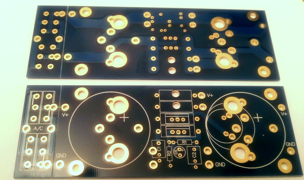

Let's look at power supply design for a moment.
Transformer, Bridge Rectifier, Smoothing caps, loss, Tank caps, loss, Decoupling caps, trace, bypass caps, amp. The above mentioned loss may be a cable, light bulb, fuse, transistor, long trace, diode, or resistor. They're all different, but the most important difference is that a ballast loss exists. For each loss that is shorted/omitted, then TWO power supply features are hindered.
So, when I look at the MyRef boards, I think that something needs installed series between the 10,000u and 1000u. On first guess, I'd try a fast silicon diode. Now, the power won't get stolen from the 1000u until the rails droop 1/2v. A 0.22R resistor may also work since the power would come out of the transformer and into the 10,000u more readily than coming out of the 1000u through 0.22R and into the 10,000u. SO, there are some compact options that don't have to involve an umbilical cable.
Crazy trick: A 1 ohm 1/2w resistor parallel to a fast silicon diode will give you a tiny amount of inexpensive reverb and a lot of noise filtering capacity. This exchange of decreasing disharmonic noise for increasing harmonic noise is generally attractive and worth an interview because it is also low loss. However, I wanted to mention it isn't totally noise free--just a lot more likely to be attractive. The resistor part gives the feature of sending noise away from the amp--a feature you wouldn't get with the diode alone (except circuitously); however, the speed of the diode is not the same as the speed of the resistor and you may get a tiny dose of reverb. I'd be sorely tempted to try that on a MyRef, since it is quite likely to outperform an umbilical cable, and the total amount of noise does not increase, and disharmonic noise will decrease. That's a decent feature.
Edit: The D//R unit goes between the 10,000u and 1000u, instead of an umbilical cable.
Edit2: That method is unorthodox--The orthodox solution for clarifying integrated power+amp boards is to install regulators.
Unfortunately, the answer I have to give for the MyRef board, on the topic of power decoupling, is that you didn't install it yet. EDIT3: To install, you'd put in something that looks like CRC.
A possible exception (to missing power decoupling) is if using Standard 10,000u in competition for charge with Low ESR 1000u and then possibly, the more demanding Low ESR 1000u can hold some charge whilst the 10,000u are charging. But, CSD (component specific design) is time consuming and it is problematic if a specified part is discontinued or otherwise hindered in availability. A bit more comprehensive design could make component selection much easier.

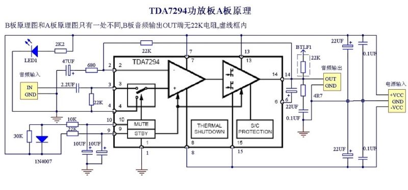

Hi All,
Four weeks to ship and a few hours to build and I finally can hear a TDA7294. The kit is quite simple compered to the LM3886 MyRefs I'm used to. However, I am very impressed with the sound it produces. A short description would be warm, powerful (in my build), accurate and a bit relaxed. The bottom is cleaner and better defined at this "stock" level than the standard LM builds I have done, but not as powerful. I can clearly understand why so many like the character of this chip.
So let me do a few "IMHO" comparisons with the MyRefs and in particular thr Fremen Edition. What stands out the most is the difference in headroom. Below a particular volume level the TDA really shines. Anything above that shows a lot of inter-modulation distortion, harshness and strain. The last few versions of the MyRef stay clean all the way to max. I'm sure there is a lot more sophistication in the power supply technology for the MR than what this TDA build has now. It would be interesting to hear this amp with something specifically designed to power it.
Unfortunately, there are no props for the TDA's top end when compared to the MyRefs. Again, that may not be a fair comparison as the kit I built is bare bones from my understanding. The MR FE is silky, smooth, defined, airy and shimmering on all types of music. If you are familiar with it, Ravel's Daphnis & Chloe has a wide range of dynamics, instrument combinations and volume levels. As long as everything is soft to moderate the TDA sounds beautiful. It just doesn't take long/much for louder and higher range portions to get muddy and a touch blaring. Bells and chimes break through brightly during crescendos and loud finales, but just below that it gets pretty mushy. Some of that may be resolved with higher grade components on the build, which I hope to do soon.
What I hear in the dynamics in percussion and general mid-rang regesters is very impressive. Without any specific knowledge or technical background, I would suspect the TDA is simply "faster" than the LM3886. If anyone has that knowledge please pass it along. There is a real element of genuine excitement produced by this chip, particularly with wild classical tracks.
So the few hours I've owned a TDA7294 have been very enjoyable to say the least. I did run several passes of the Isotek burn-in cd that cleaned away some fuzz that was there at first power-up. This kit is capable of a BTL configuration and I am very interested in trying that as well as some of the other dual chip setups Daniel W. has suggested. At $30 for a two board kit with all the necessary do-dads, one can't go wrong and a second set won't break the budget.

Well, that's actually a really good result for a basic kit in stock condition. Both the gain and the feedback current may be a bit high and the NFB cap and bootstrap may be a bit small. That combination causes it to miss the highest highs and lowest lows, but that is what the datasheet example schematic does.
Try the bootstrap cap directly at 47u for slightly more low bass.
(some newer schematics show 47u)
And, try the NFB cap at least as large as 220u (or bigger)--Also try some tiny value polyester caps and/or electrolytic of 0.47uf or less, as bypass caps parallel with your NFB cap.
Then the lowest lows and highest highs should be working.
(the schematic shows 22u, which is a bass blocker)
Also for low bass this amplifier appreciates a large power supply reservoir capacitance, not located on same board as amplifier.
If it still does some midfi behavior, the gain might be set too high, since it doesn't really have enough gain capacity for a 70w amplifier. The quality drops if the gain is too high. If you want hi-fi, I think you want low gain power amp pushed by a preamp.
The feedback current might be too high due to feedback-shunt and feedback resistor values too small, which also causes fragility and current noise of overloading the small signal section beyond linearity.
To make a reasonable compromise, you could set the feedback-shunt resistor to 2k2 and the feedback resistor to 56k (or even 68k if going without a preamp). Nearby values make really similar results. This ballpark is a good spot to start exploring. That example is off a bit, but not nearly as far as the datasheet schematic.

Sure, you can give it its own thread, and introduce it, along with the schematic. I've attached the schematic so that it doesn't disappear. Four of the caps are undersized and two of the resistors have too much current, and the funny thing is that the caps are too small to control where the current is supposed to go. There's a little traffic jam, which is the source of the "muddy" that happens when you try to play loud. It just needs some really basic/generic audiometric tuning to get it in the ballpark (of playing both loud and well) before you begin other fine tuning.Thanks Daniel, this chip contains a lot of potential if what I'm hearing is truly stock performance. It definitely fits well within the definition stated in the thread title. Even with the shortcomings I perceived, I was enticed to listen to some major productions all the way through with its warm and dynamic presentation.

Attached is your amp schematic in "stock condition":
